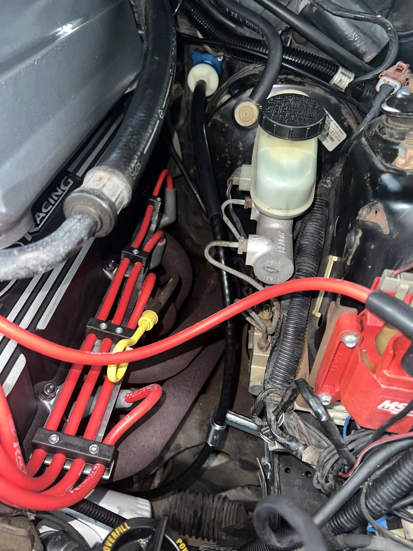

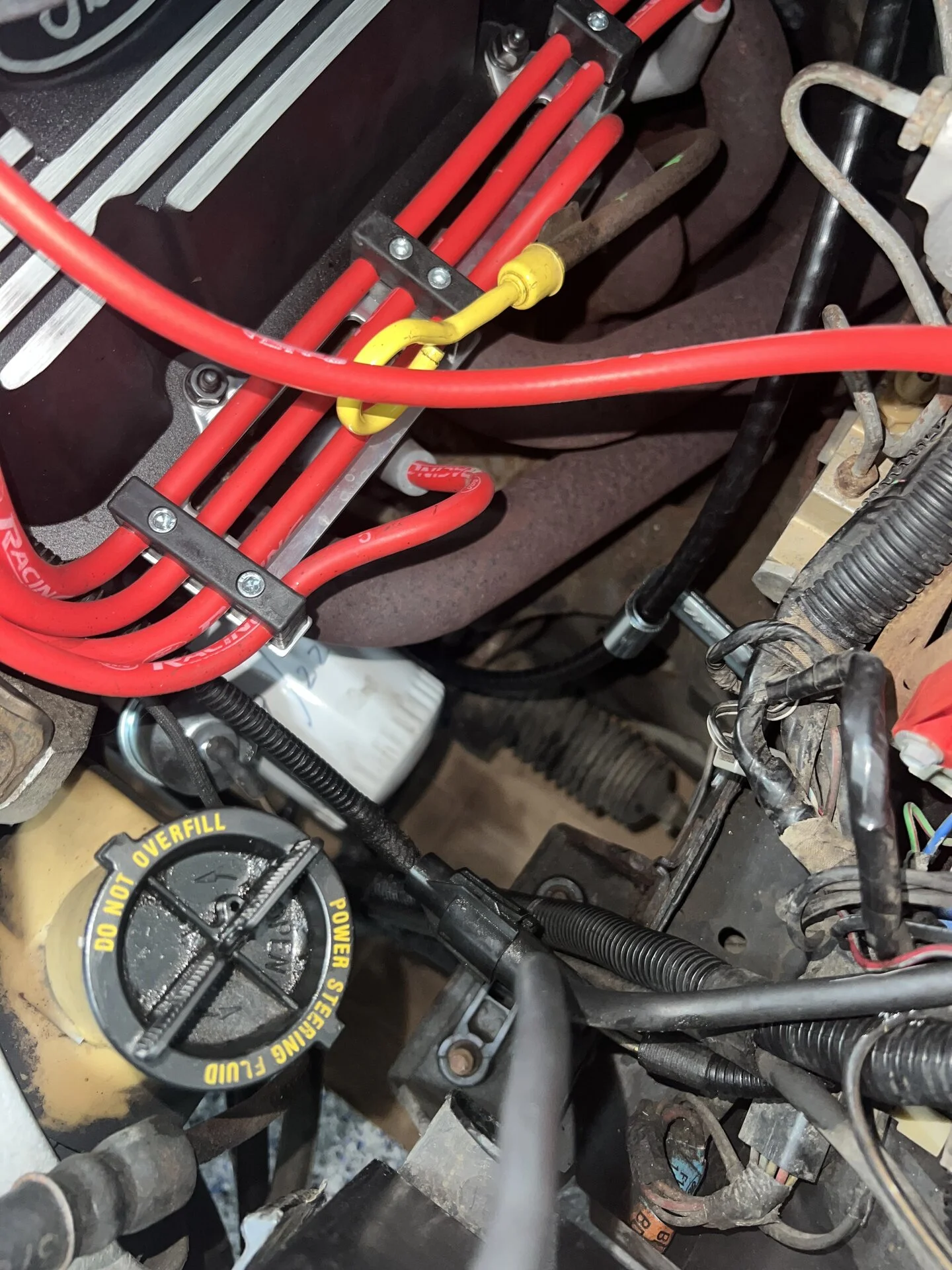

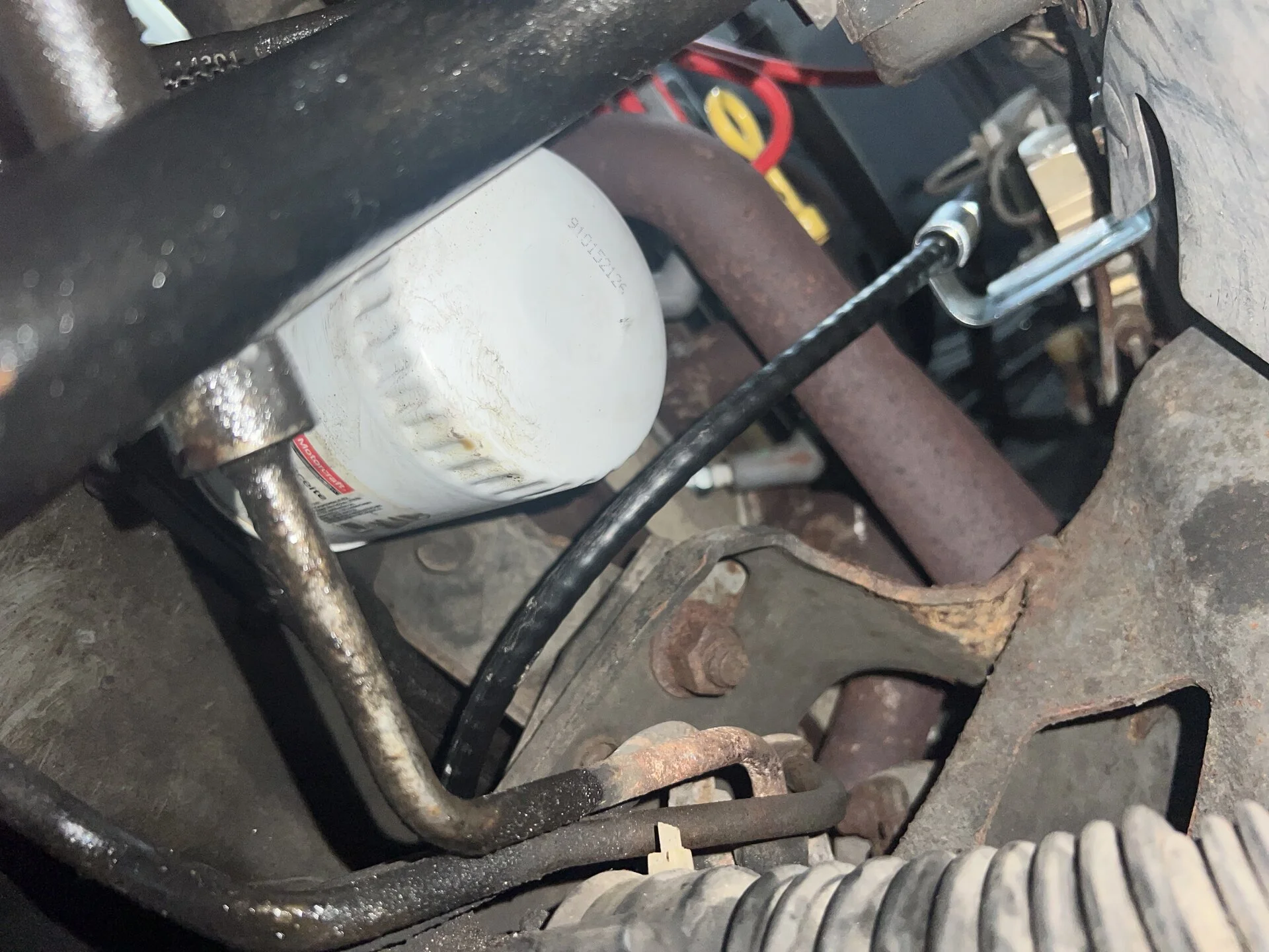

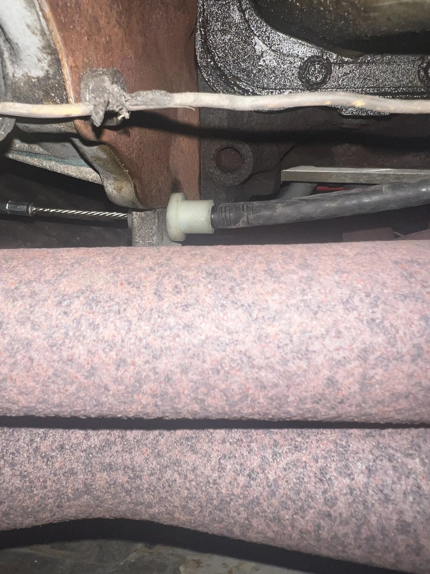

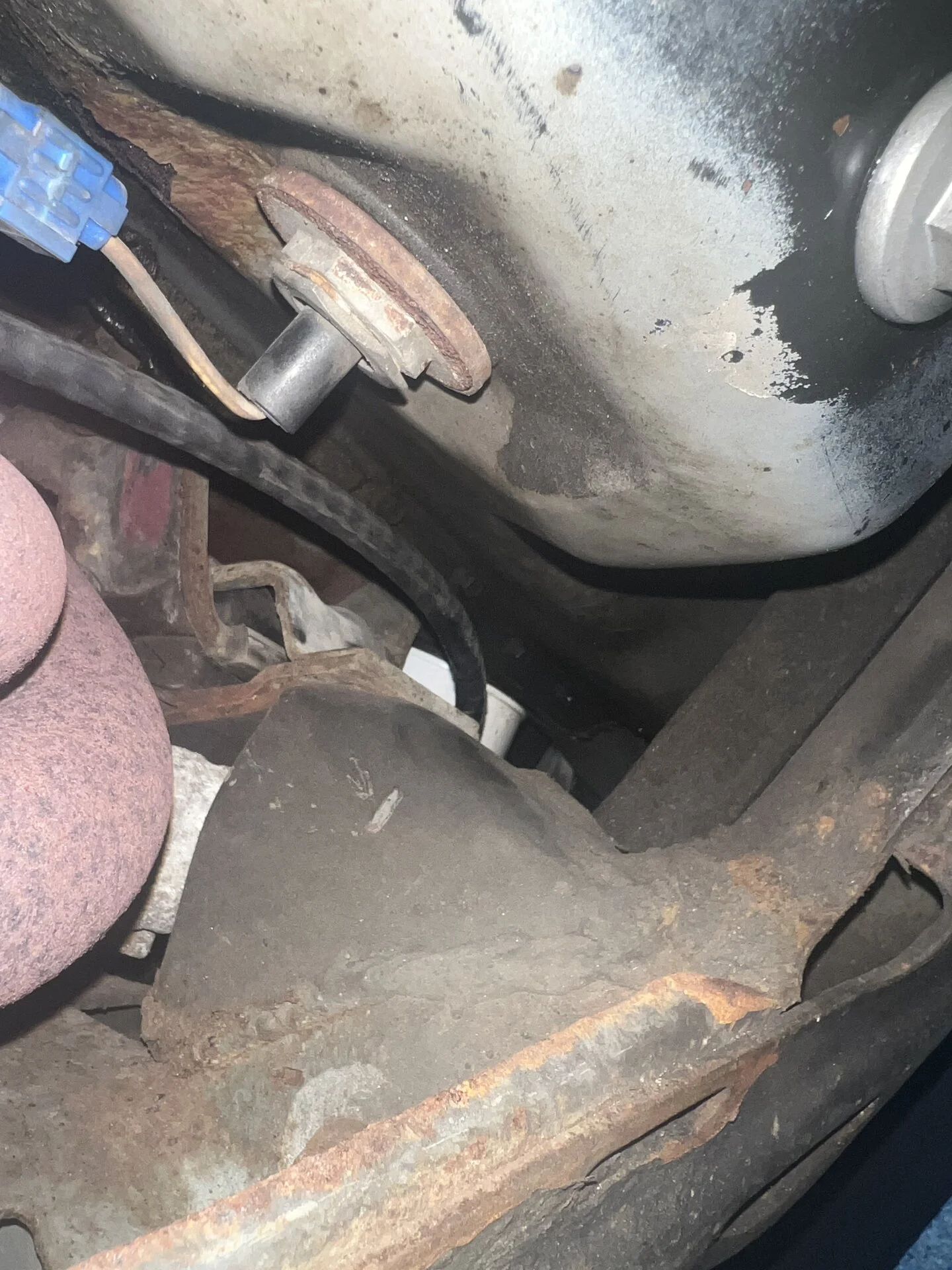

Hey guys the new clutch cable fixed it thanks for all the help everyone. This was how I routed the new cable I had to bend the bracket away from the headers and then I routed the cable between the motor mounts and the oil pan. Does this look good?
