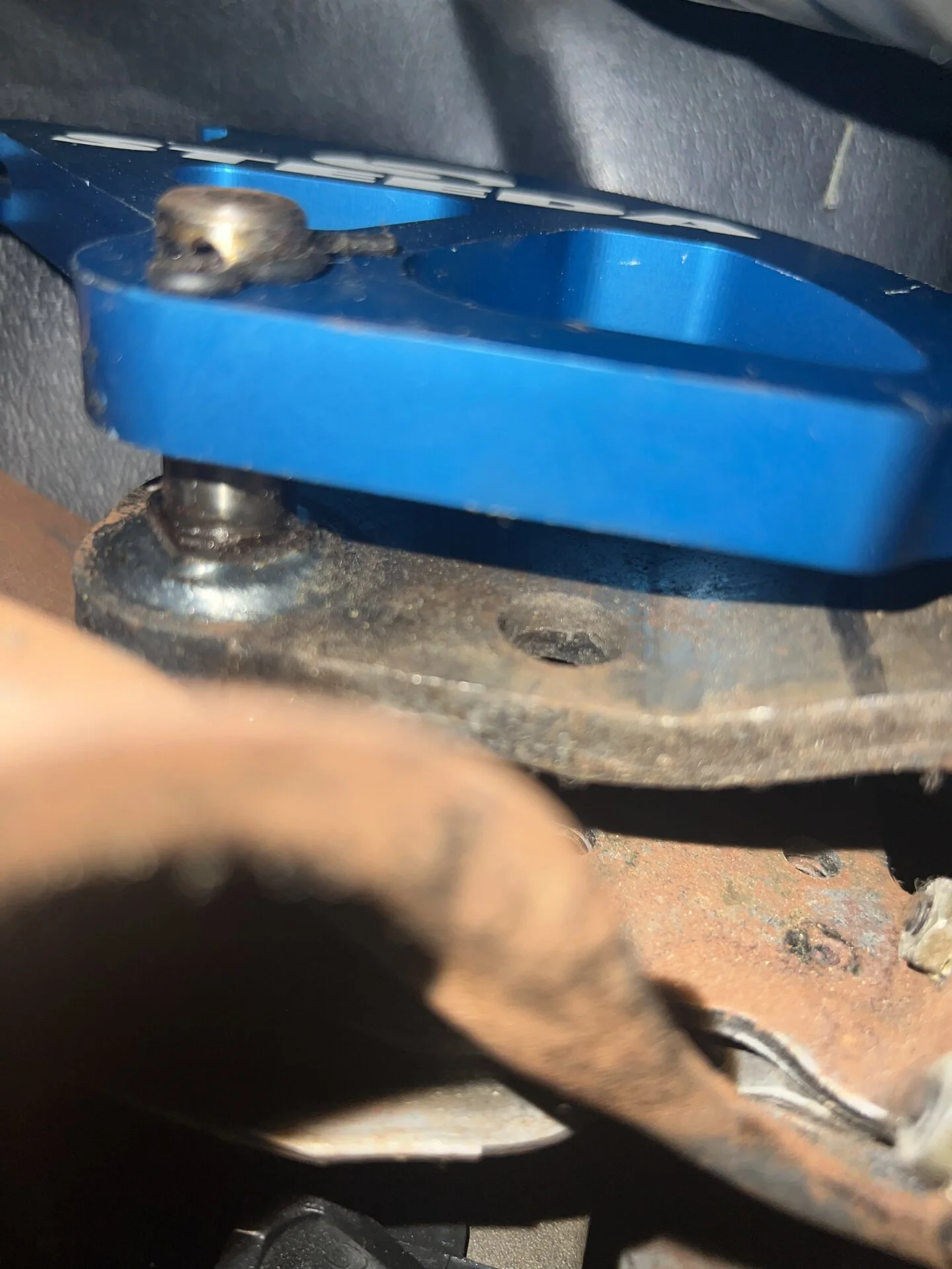

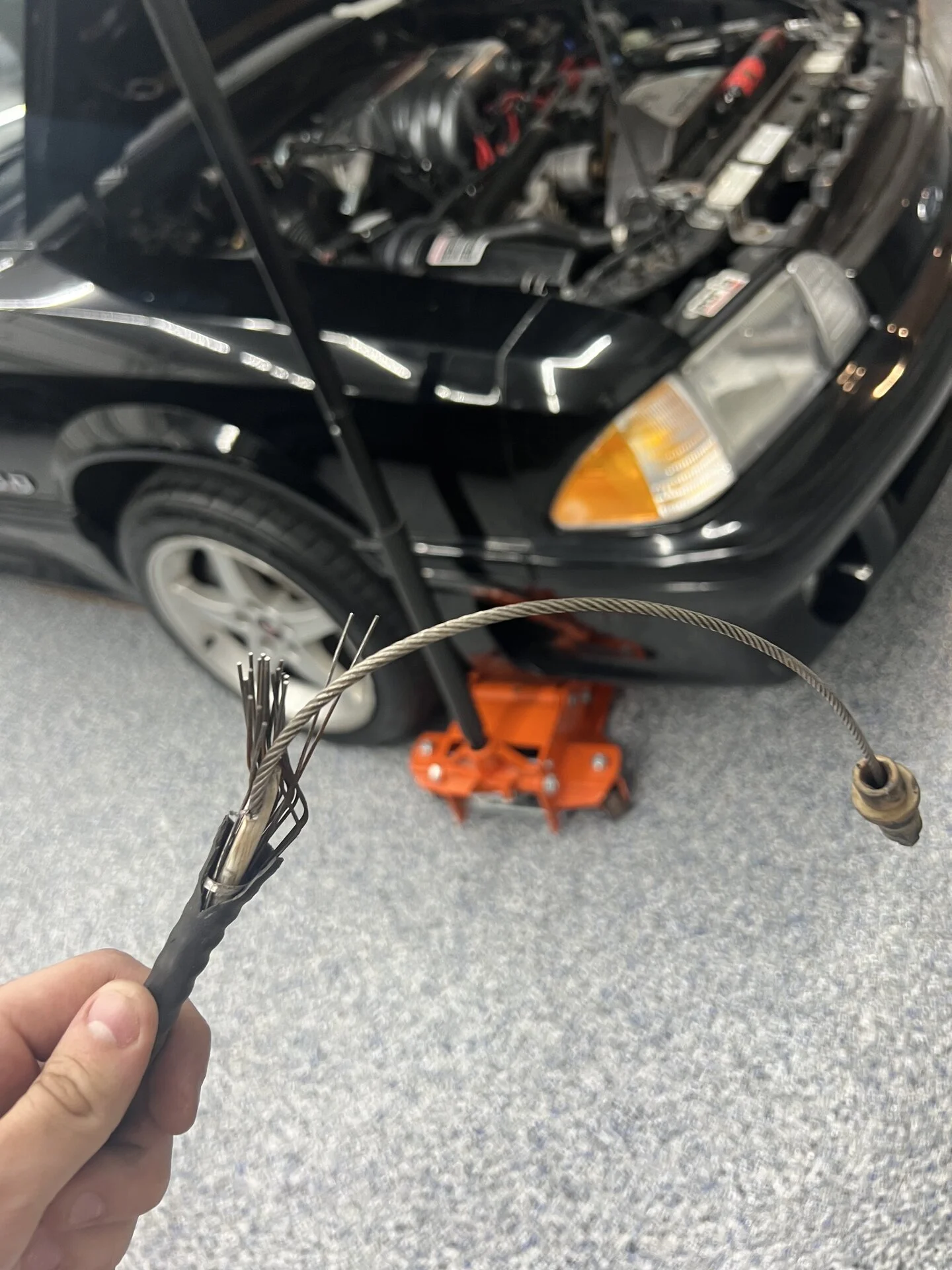

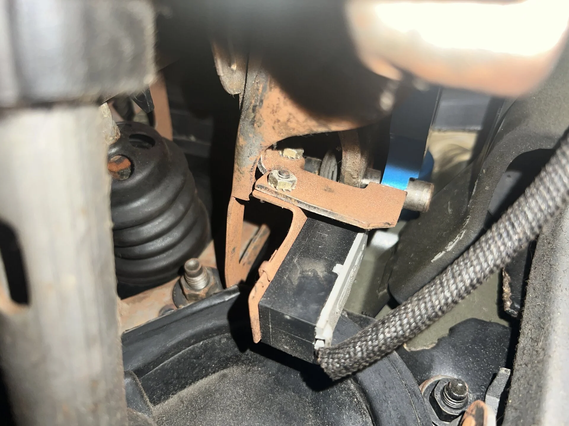

Just took off the old cable. It wasn’t snapped but something definitely happened since it’s all broken at the end. Check out the pic. One other thing I noticed. The quadrant was missing a cotter pin on one of the pins that it slides on and both pins did not have any sort of spacer on them. The quadrant was just able to slide to the side. Is it supposed to have a spacer to keep it from sliding?

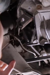

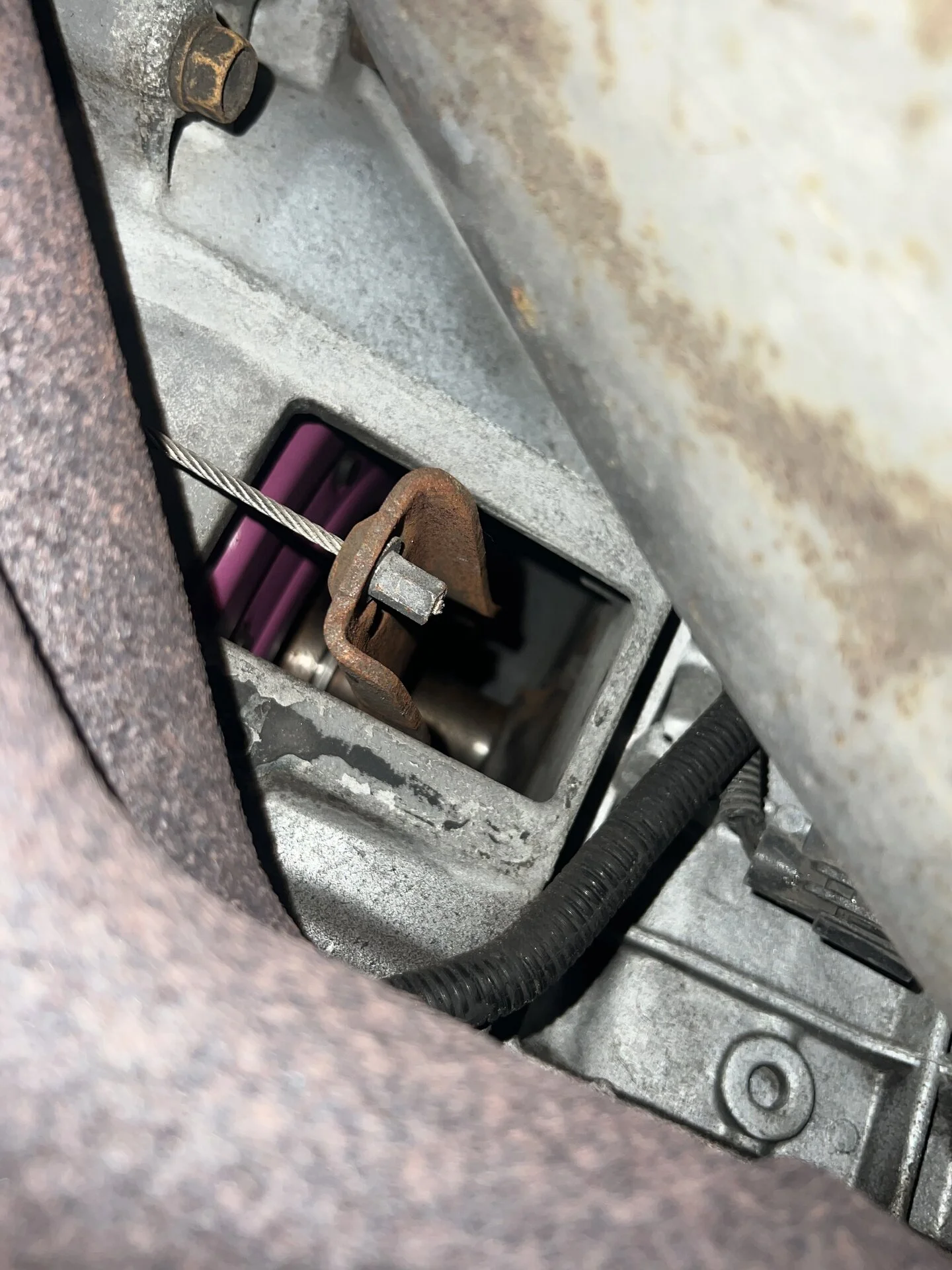

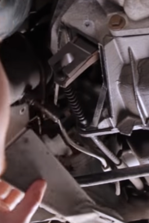

One thing I noticed now was that my clutch fork rests near the middle of that rectangle hole. When I look at videos of people removing their cable I see that theirs rests near the end. Could this be an indication of something broken or is it normal? At that middle point is where it likes to rest if I try to push it to make it look like the other picture now that the cable is off it’s completely loose.
