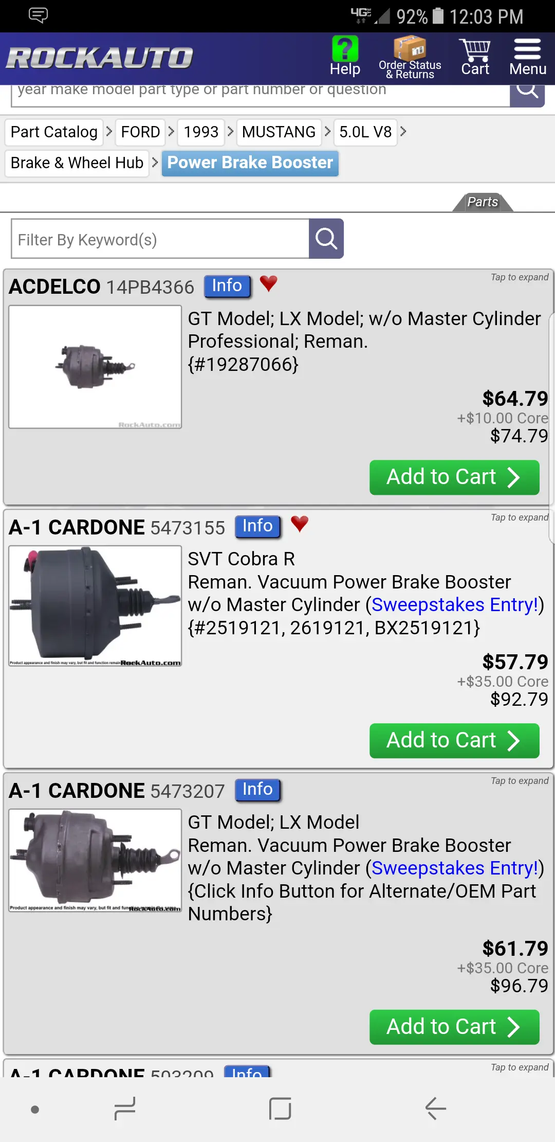

I ordered mine from Rockauto.com. The only thing i wish odd that i would've painted it before i pout it in. It was a PITA but worth it. I shortened the studs by about 1/4 inch and lightly beat the strut tower with a BFH.
It's alot easier if you have the front seat removed and someone there telling you which way to go to get it in. It's a cardone but it turned out pretty good.... just paint it.

LMR is the Cardone or at least it was . I have the Cardone in mine with no issues . Got it off rock

Well I received my American Muscle Cobra booster and it is a Cardone. Oh well now I know. Good thing is its in great shape and I am happy. Looks like Cardone is the only one making these.

Yes they are remanufactured by Cardone. Looks like they are the only game in town when it comes to these boosters. Like I said at least mine was in good shape. I've had some parts from Cardone remanufactured with some pretty beat up cores in the past. I consider myself lucky this time.
