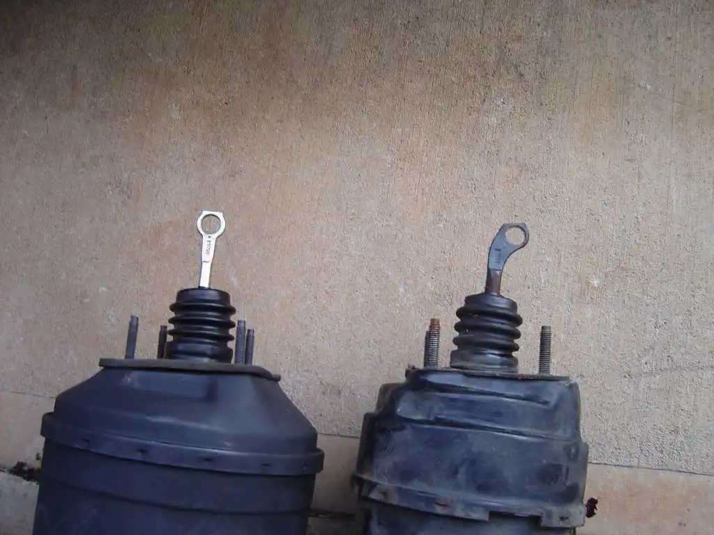

The only time I've exoerienced that was when i installed a sn95 booster for a customer. The rod coming out of the booster has the hole straight instead of offset. The rod was catching on the body on the bosster about 3/4 down.
