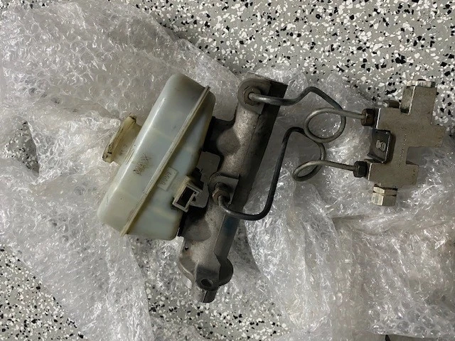

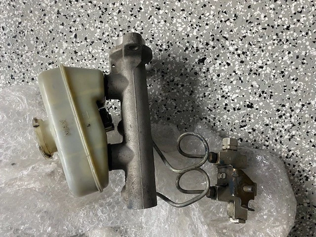

From the pictures below can you tell if this MC is Cobra or GT
What year is the MC and Prop Valve supposed to be from?
The 5 lug upgrade I purchased from eBay (and got ripped off) is from 1995 GT.

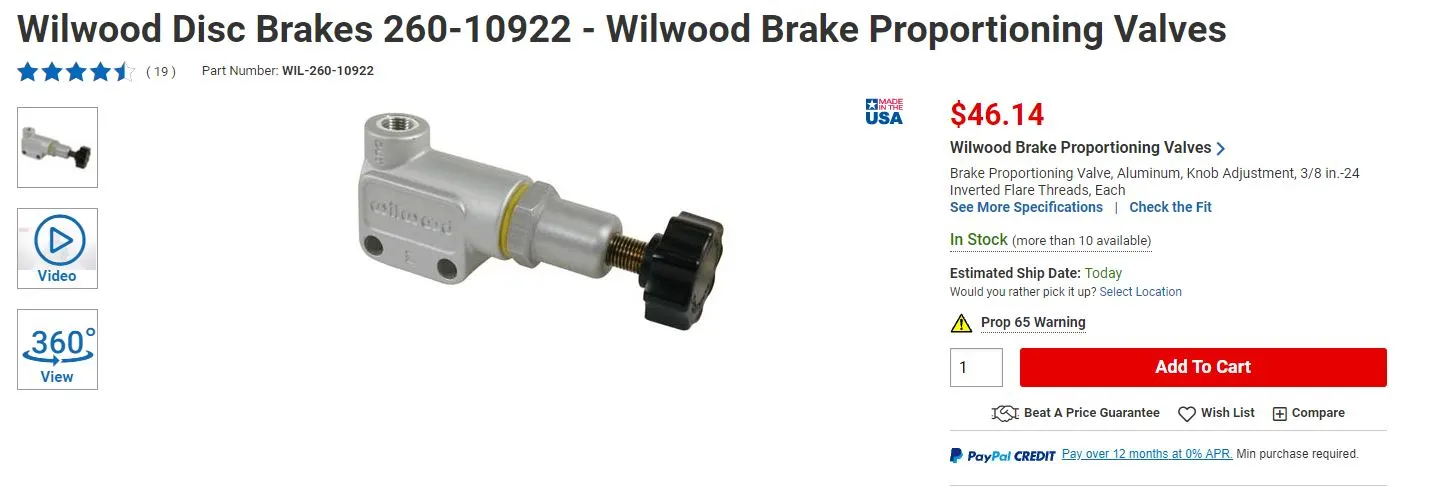

It included - Front and back calipers, axels(28 Spline), Booster, MC, and Wilwood(with 3/8-24IF inlet- part number 260-10922) Prop Vale

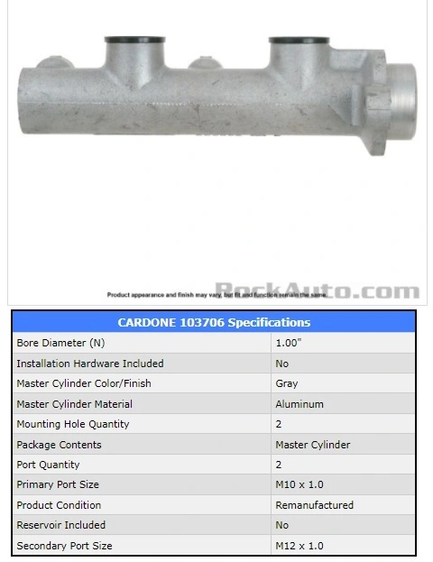

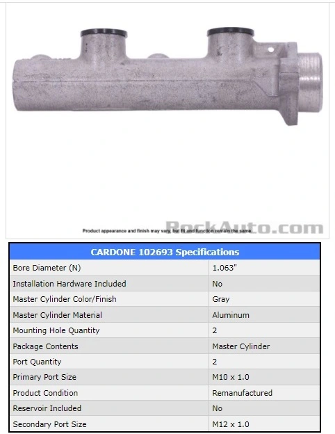

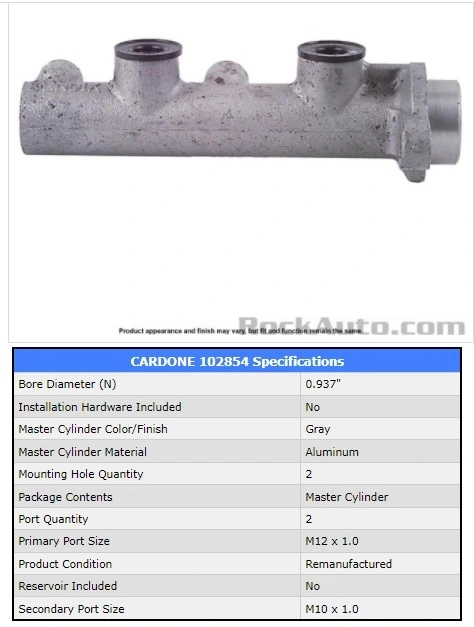

Looking at the pics of your MC and comparing to replacements on rockauto, I think your MC is the 1.0625" diameter type.
Replacement specs...
93 Cobra, 95 GT/V6, 95 Cobra
Personally I think you want the 95 GT/V6 style for any SN95 dual piston caliper.

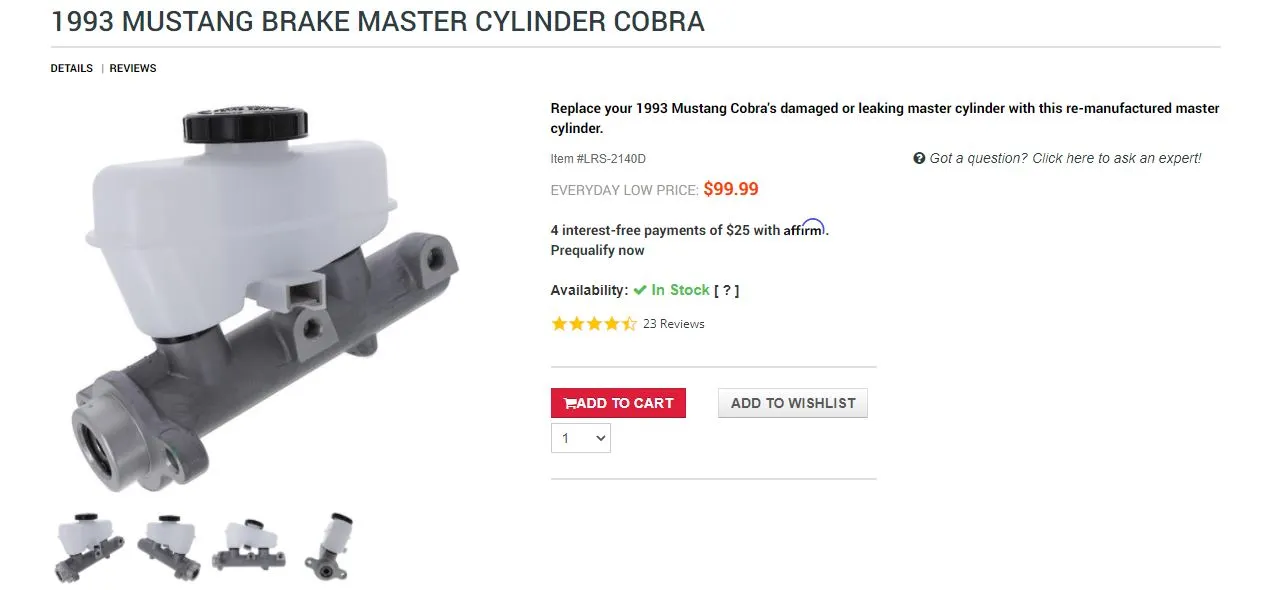

I ordered the 93 Cobra MC from LMR 9 see pic below) because someone recommended it. They mentioned that it was better than then the one I had.
