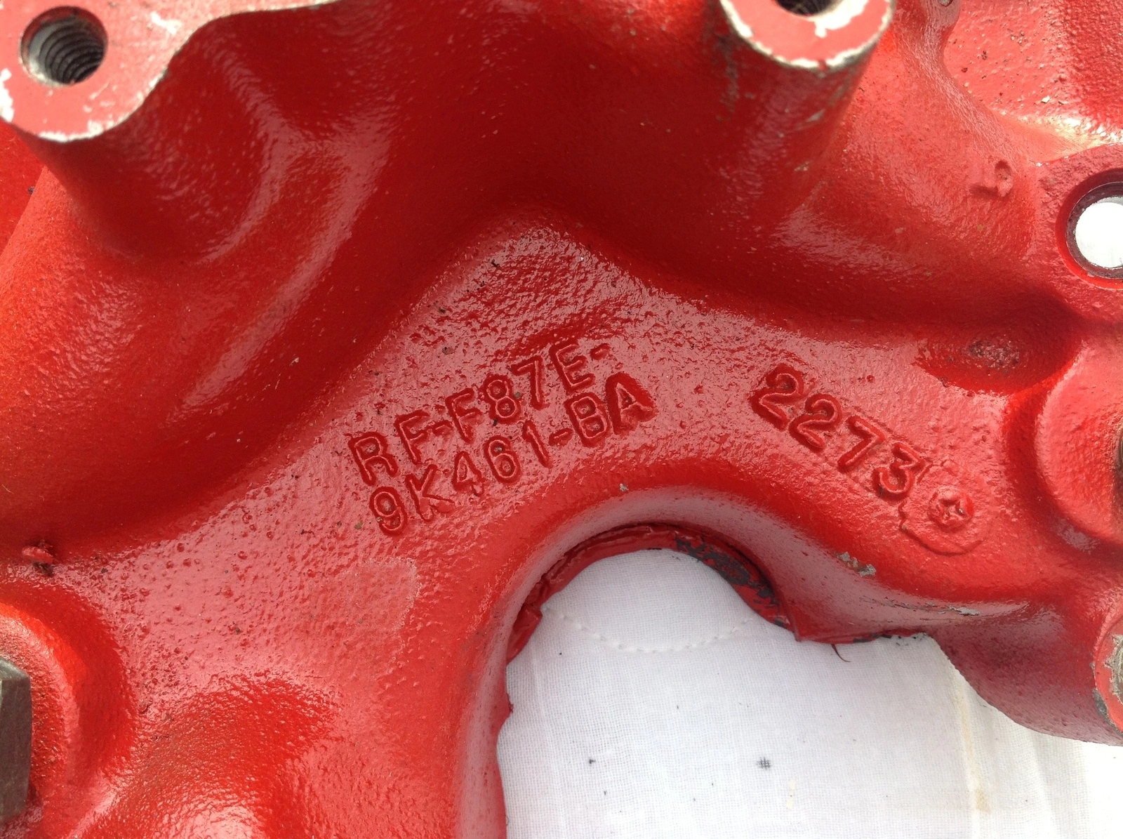

Most common lower that came with the us-made ford racing kit was p/n RF-F87E-9K461-BA. Cross referenced to a 98 explorer lower. A real 1993 cobra intake off an actual 1993 cobra will use a lower with an F3 part number
Earlier 1993-1997 kits probably used a different lower. There was an F3, f4 and f5 lower. All the same really, but a good way to identify a Ford made lower vs the Chinese stuff.

So I will assume. F3 upper marking and an f3 to f5 lower stamping

I did purchase the Cobra intake. It has the correct part numbers and Stampings. Upper. RF-F3ZE-9425-CB. Lower RF-F87E-9K461-BA
