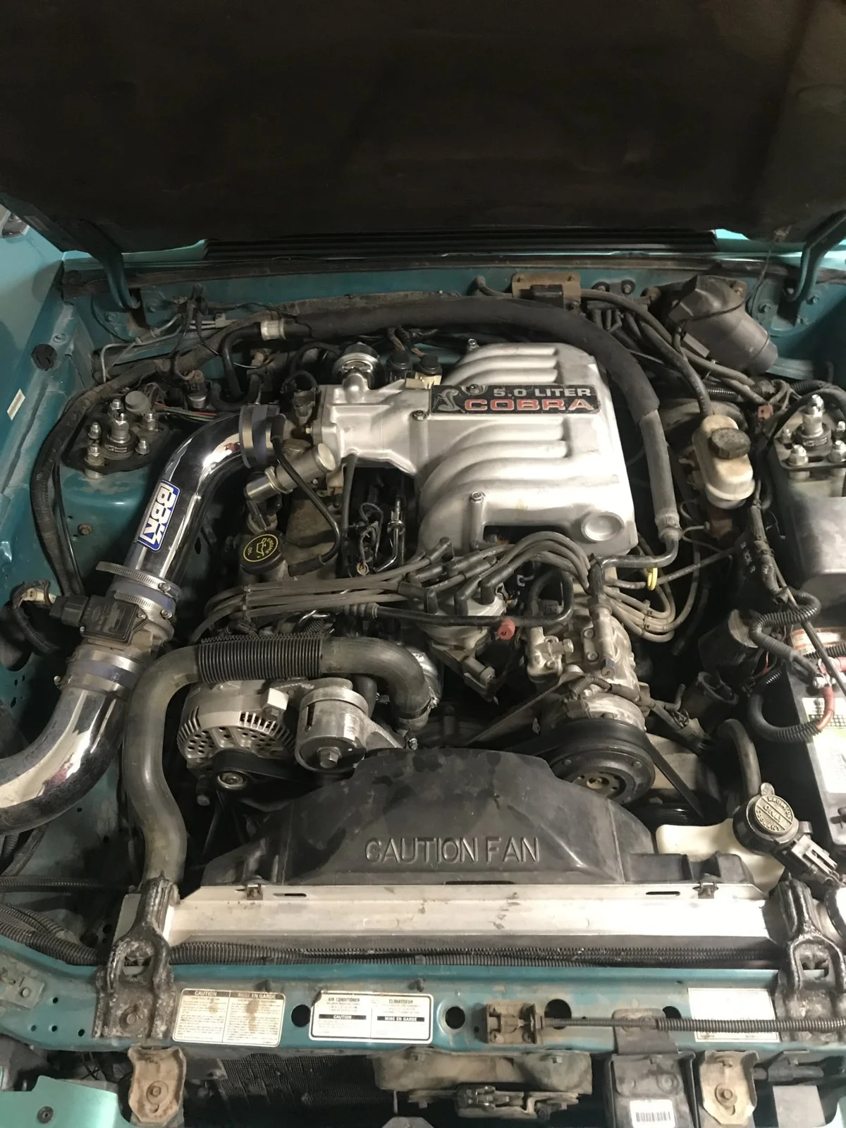

After a few weeks ago asking opinions on installing 77MM MAF but was pointed in direction of changing out stock intake to something better.
Well after a few days I found a legit not Chinese Cobra intake. Intake was installed and now car runs much better.
My 93 Fox has stock bottom end, stock cam, aluminum Edelbrock performer heads, scorpion roller rockers, stock and rebuilt 19lb injectors, stock throttle body, stock MAF. I did notice that a bit of torque was lost a bit but not much, car runs so much better it does not feel chocked up anymore engine actually feels running so much free now. In about 2 weeks I'm going to be taking back to dyno to see if any additional adjustments needed because of changing stock intake to now cobra intake.
I have been also thinking about changing MAF and installing to a 65mm throttle body with 24lb injectors as well. But my opinion tells me to not buy it won't increase HP much anymore, so as of now just need to find a good reputable differential shop to rebuild diff and I'm going to enjoy this car now.

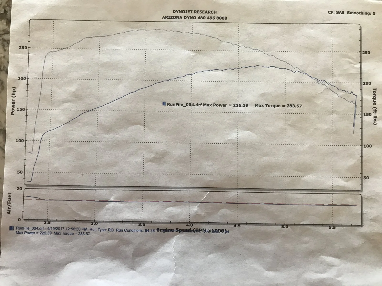

here are pics dyno sheet as well
For what it is worth the '93 Cobras came with 70mm MAF, 65mm TB, and 24lbs injectors. The engineers at Ford would have not upgraded these items if they didn't think they were needed. Your heads flow better than the GT40 heads the Cobra had so they are definitely costing you. Probably in the 25-35 hp range.
