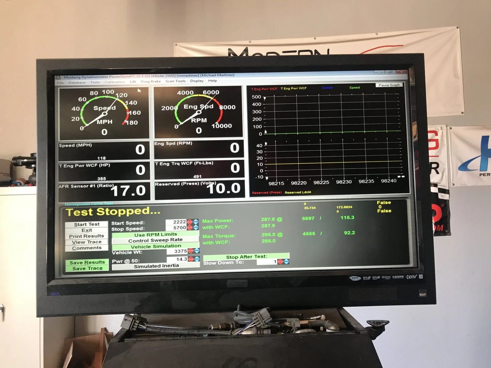

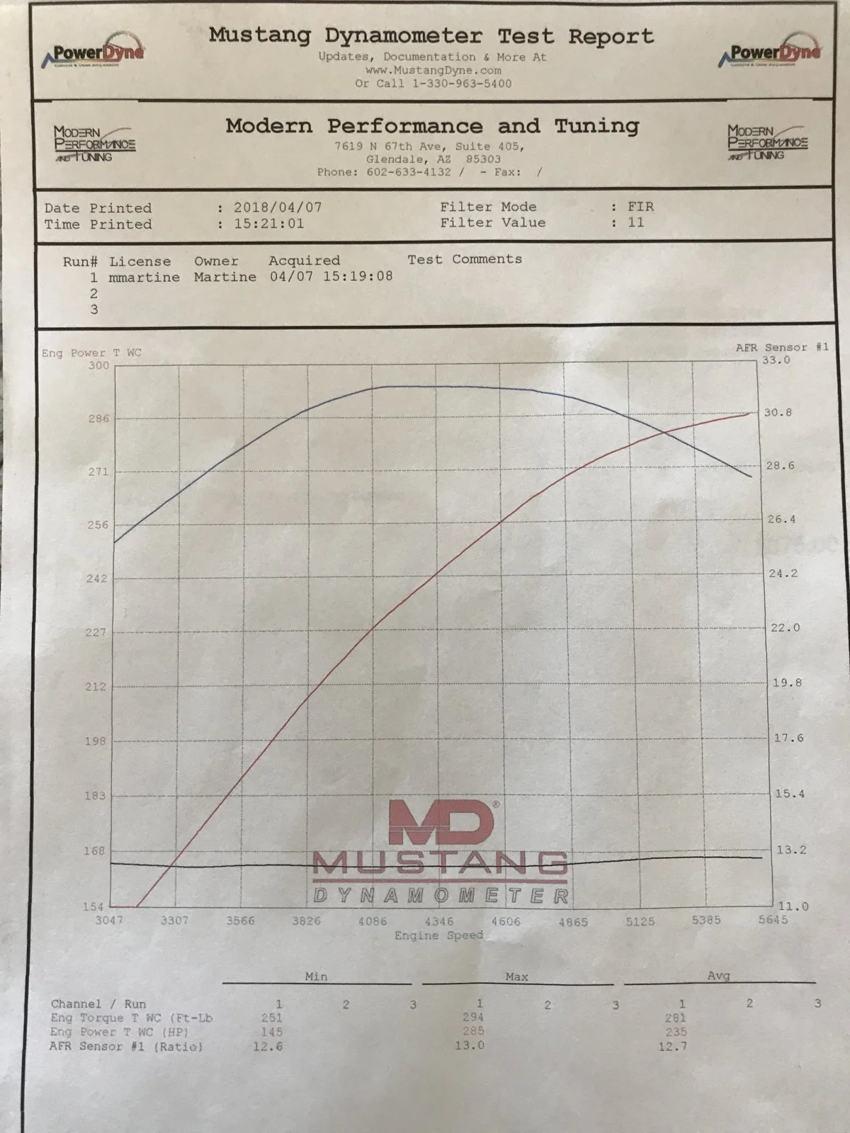

Well as of 4/7/18 my 93 Mustang LX was dyno tuned at 287.5 HP on a Mustang dyno.

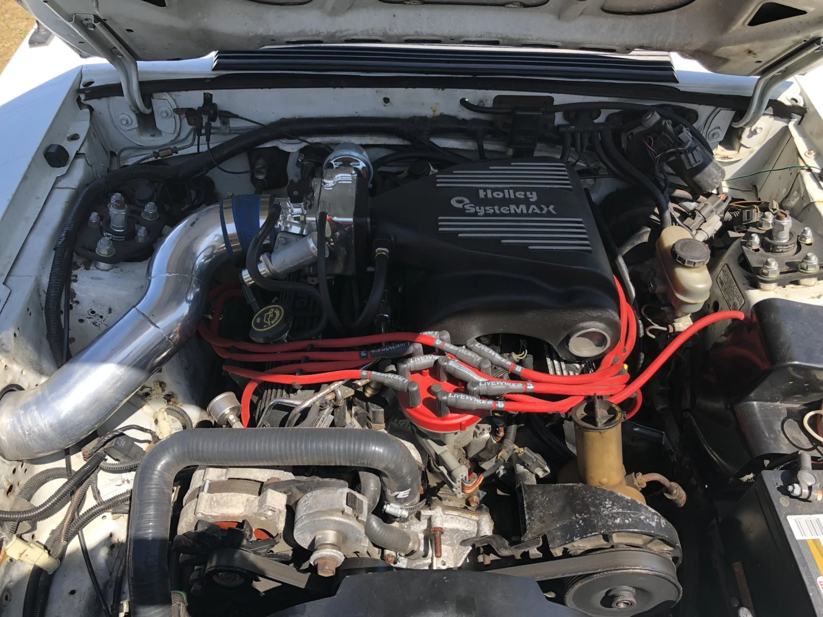

Car has Edelbrock performer heads, cobra intake no porting, BBK equal length headers, Scorpion 1.6 roller rockers, Pro M 77mm MAF with stock ford electronics, BBK fender mount cold air kit, stock 19lb injectors, stock cam, and stock throttle body,
Dayumn! That totally defied my expectations for what could be done with stock injectors, stock throttle body, and stock cam, and I've seen thousands of these combos. I'm still kinda skeptical. What fuel pump is in the car? What fuel pressure did you run? And, when will you back it up at a dragstrip? If it all checks out, congrats, sir, because those results are phenomenal!
Stock pump, and not sure on fuel pressure! When will i back up probably never i dont go to dragstrip or have time to go. Also this car is my daily driver as i live east of Phx Az and once a month i drive to see my parents in San Diego Ca. And i drive my 93 mustang everywhere. I love this car. Its so much fun to drive.
In a few weeks my 93 will be going to shop again to get rear end done. Right now has 3.55 gears but pinion has a bit of play and gears howl a bit. Almost saved up $1K for job but hope its not much more!!
Thks for compliments!
Reactions: FastDriver
Thanks for the reply. That takes it from doubt to disbelief. There just comes a point when there's no way to believe something. Please don't take it the wrong way, as I don't think you're lying and I have no reason to doubt that you took it to a Dyno and got these results. The pics show that pretty clearly. However, things just don't add up, here. I've got nothing against you or your car and don't mean any insult in the slightest, and I would love to believe a stock 5.0 could do that, but the stock pump is incapable of making that much power, and the rest of the combo really shouldn't. The heads are capable and so is the intake. Stock injectors are not though, without a ton of fuel pressure (60-ish), which would have to be deliberate and you'd recognize the side-effects.
All that said, as far as possible explanations go, dynos can be very misleading. Also, perhaps a previous owner replaced the stock pump with an aftermarket one. That said, I still can't see how the stock 55mm throttle body and stock cam could do it. Also, perhaps I'm simply missing something. Track results cannot lie though. At ~290 rwhp, you'd probably see ~110mph traps in the 1/4 give or take.
