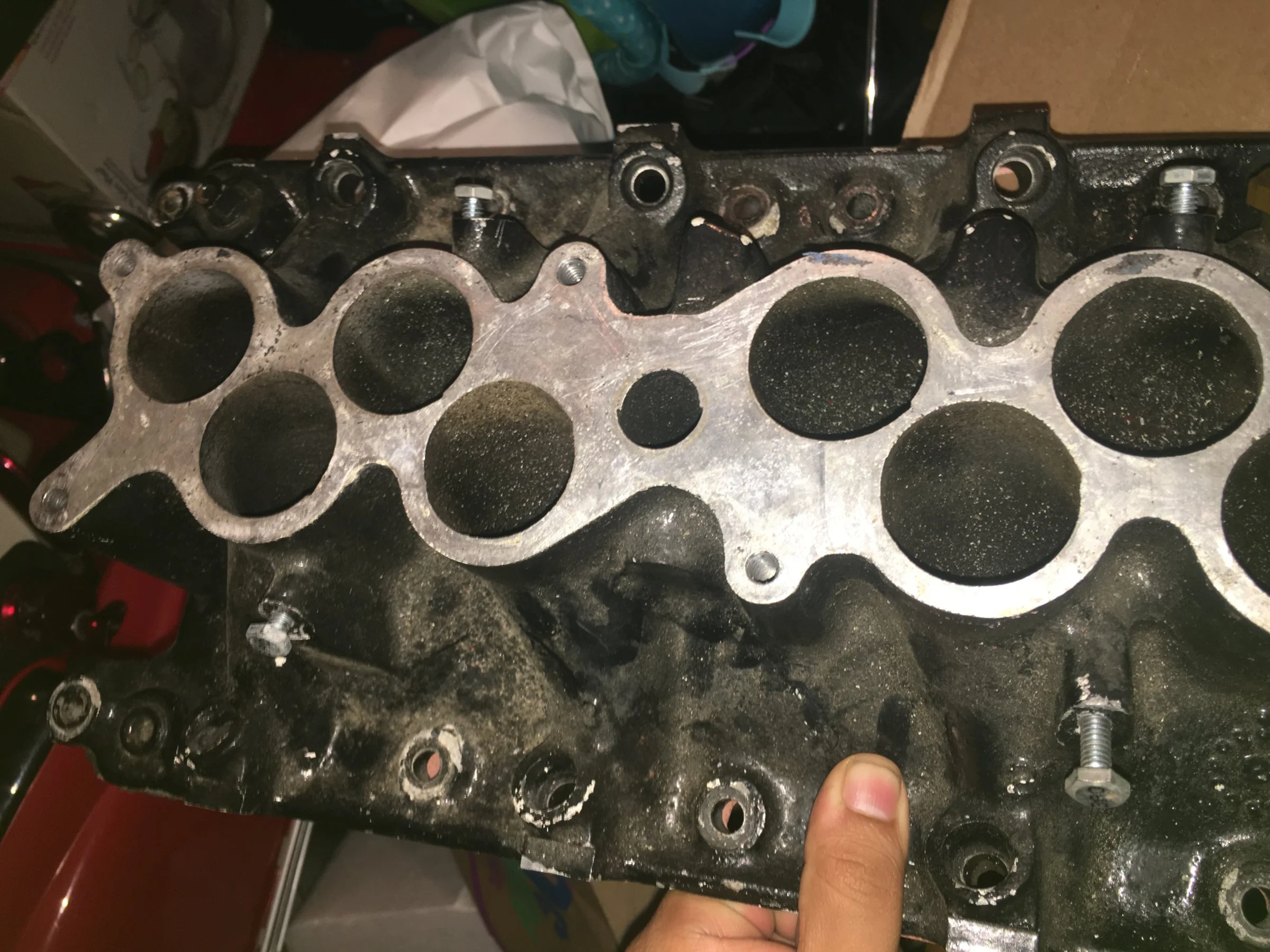

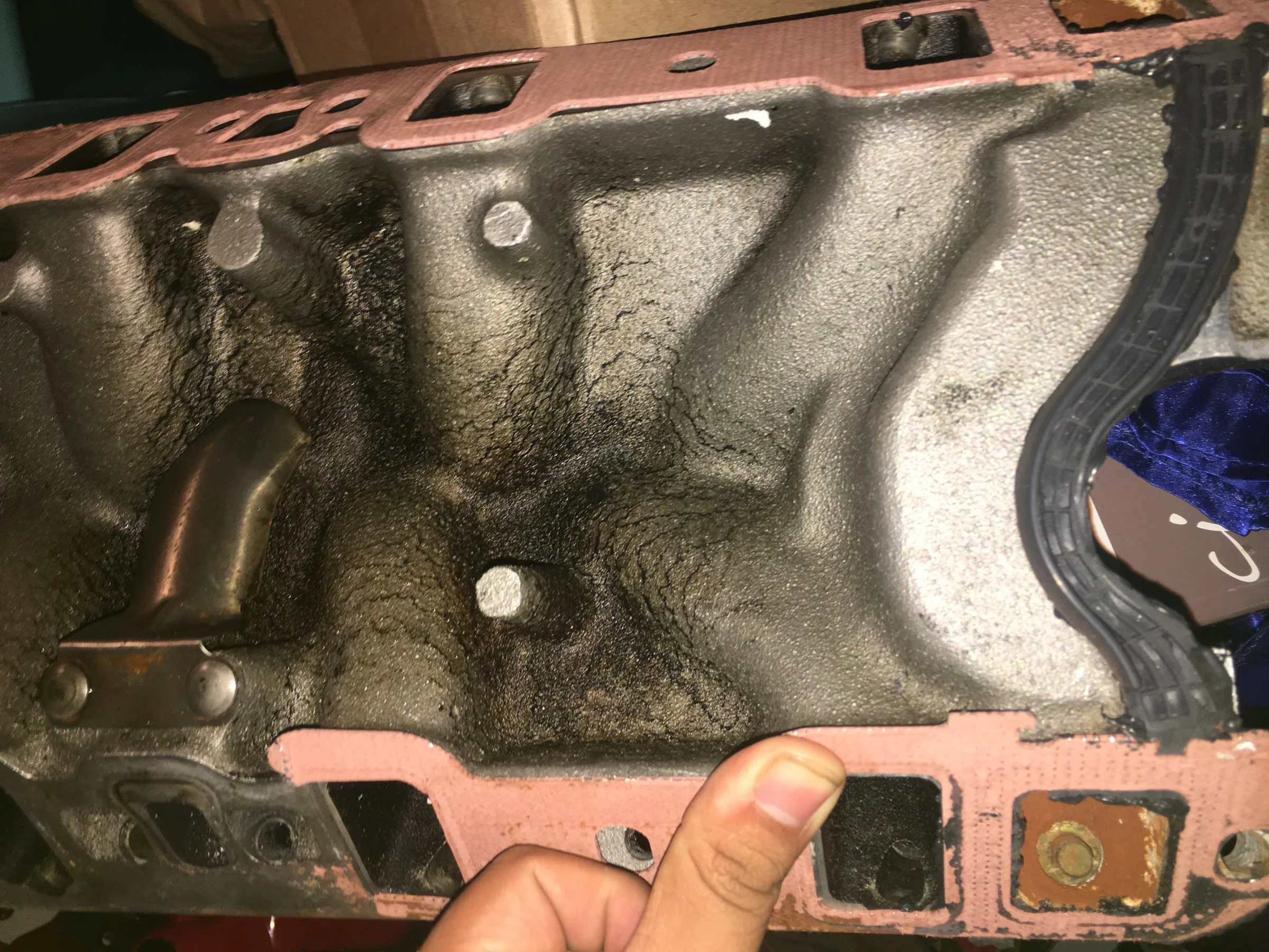

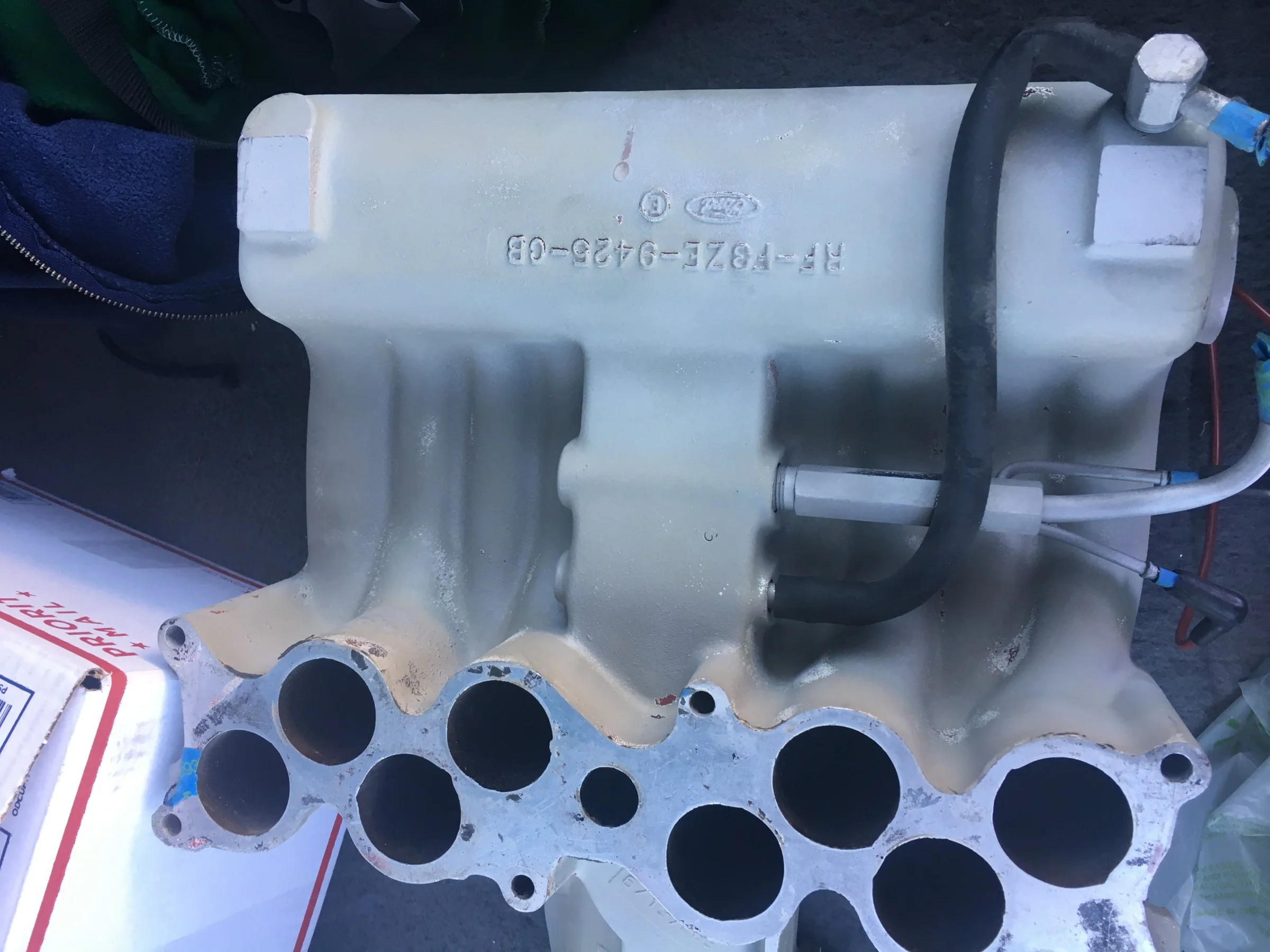

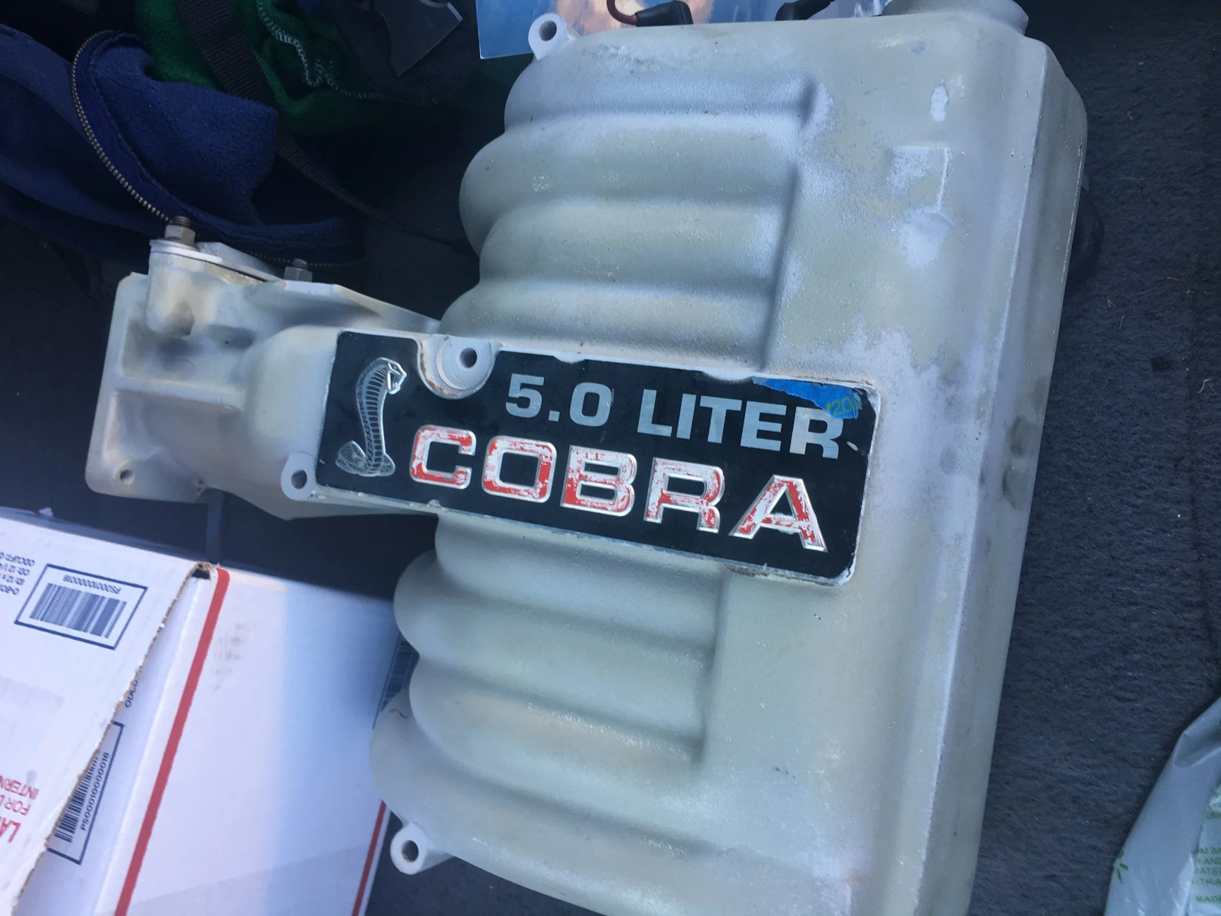

I bought this cobra upper/lower intake from a junk yard and I'm not going to lie . I don't know what I need to install it or how to install it. I have a 1993 musings GT 5 spd BBK cold air intake, BBK pulleys, BBK xpipe and flowmasters that's the extend of work I have done. He said it came off a cobra but the car was totaled and he didn't have the bolts so need that too. Any information will help or even to know if this is one of the China made intakes thank you everyone

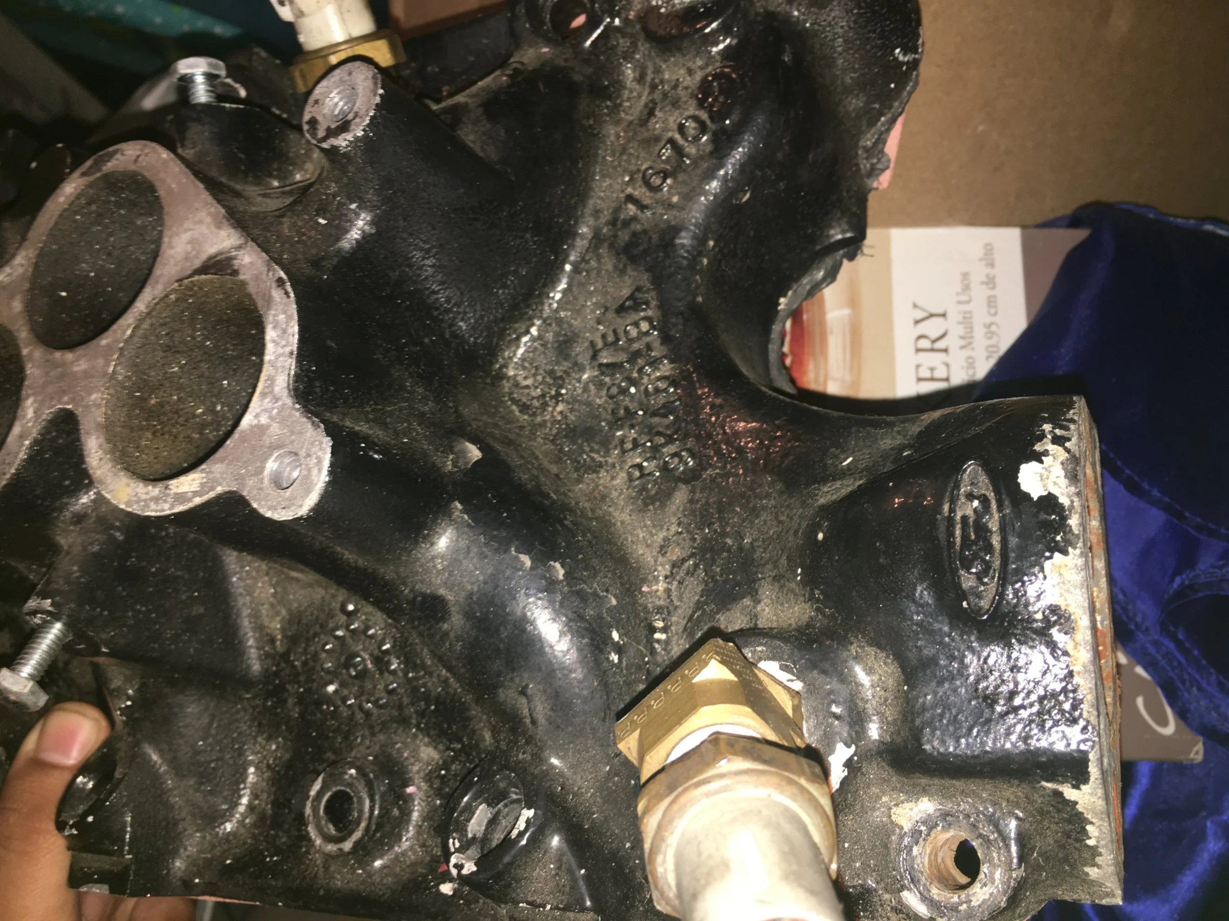

Not a China intake. That's a real F3 upper. Post pics of the lower and I can tell you if it's a Ford Racing kit intake or actually off a cobra.

Good deal if you got that from a boneyard. They have been discontinued a while. True ford cobra intakes have risen in value if you check eBay. I'd make the suggestion of ebaying the upper/lower for $300-400, and buy an explorer for $100 and use the extra funds for more mods....unless you want the cobra upper

That's a ford Racing kit intake.
Lower is an early explorer casting drilled and tapped for act and coolant return ports. Smaller baffles.
Cleaned up, prob $400 intake. Good score
You can just bolt it on, follow jrichker's instructions in post #2, your lower has the act so all good there.
