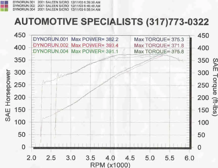

dyno results
Ok here it is:
Run #1: 382.2 RWHP, 375.3 RWTQ
Run #2: 393.4 RWHP, 371.8 RWTQ
Run #3: 391.1 RWHP, 375.8 RWTQ
:banana: :banana: :banana:

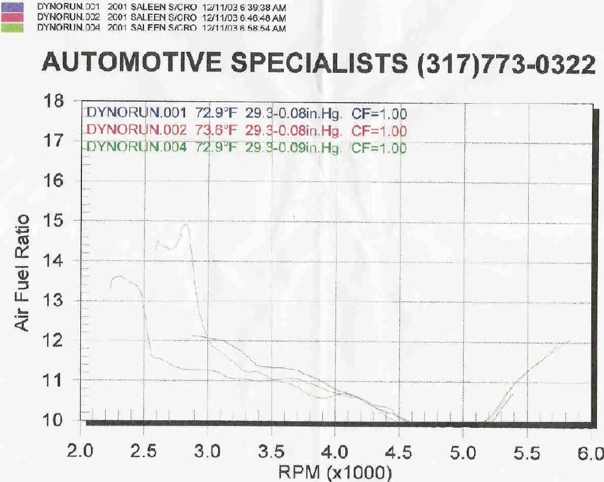

The A/F ratio is just a tad bit too rich from 4500-5200RPM's, so Tim is going to lean it out a bit there. That should get me over 400 for sure.
Tim--got my card ready whenever you come out with that plenum. :D
Tim-you should have the dyno sheets in you email any time, so if you want to post them, you can.

NICE :nice:
Yeah...that's what I thought. Pretty good, huh? I still have a couple of things to have Tim smooth out and add more timing and fuel in a few places, though. I think after that, it should be at 400 if not very close.
Hey Tim...you get those dynographs yet?
