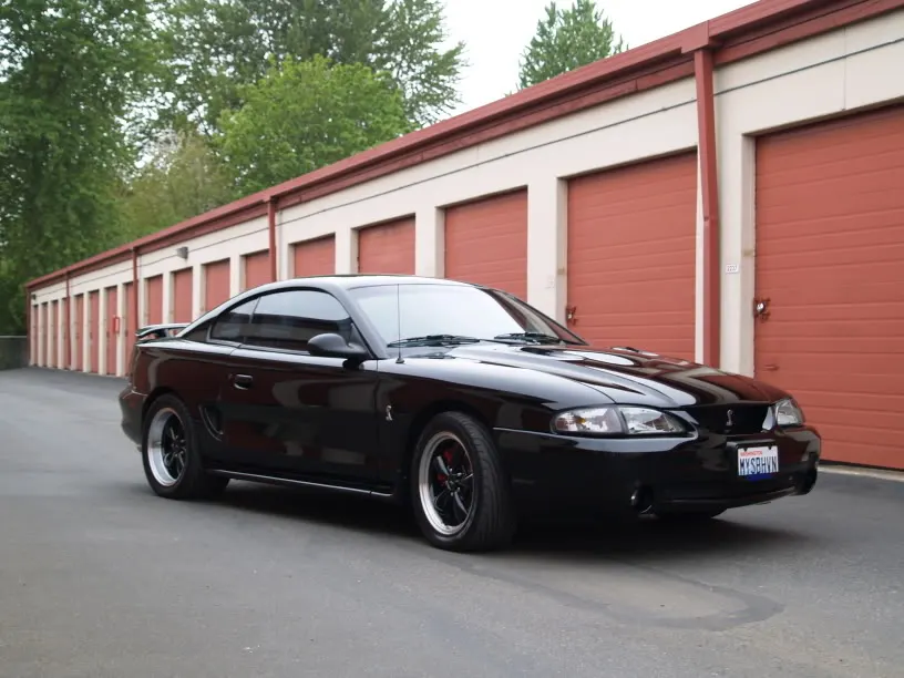

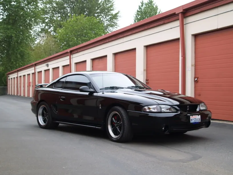

I had a 97. Great car. 305hp stock. all cobras are 5spds. mine got me anywhere from 17-20mpg depending on how i drove it, it was a high-rpm screamer and looked really sharp. Its easy to make them look GREAT with just some springs and a good set of wheels (10-10.5" wide out back) and with just a couple of mods (4.10's, exhaust, etc) they will turn in some pretty good times. mine went 13.5@105 on a VERY cold day and all i had done was a cat-back. downsides could be that aftermarket parts are more expensive than for Foxes, if it has black interior, wear will show more on the seats, etc...you have to run premium fuel, which is over $3 a gallon, and if it gets modded you will use more. but they are easy to find at a decent price with decent miles
heres what mine looked like. MAC progressive rate springs, 17x8 & 17x10.5 Chrome cobra R's, Magnapack Cat-Back, MAC CAI, PRO-5.0 shifter.

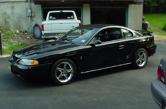

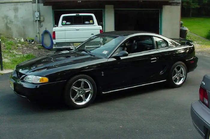

The wife's "play" car:
DOHC cars are a blast to drive fast. In the upper rpm ranges they blow a pushrod motor away.
