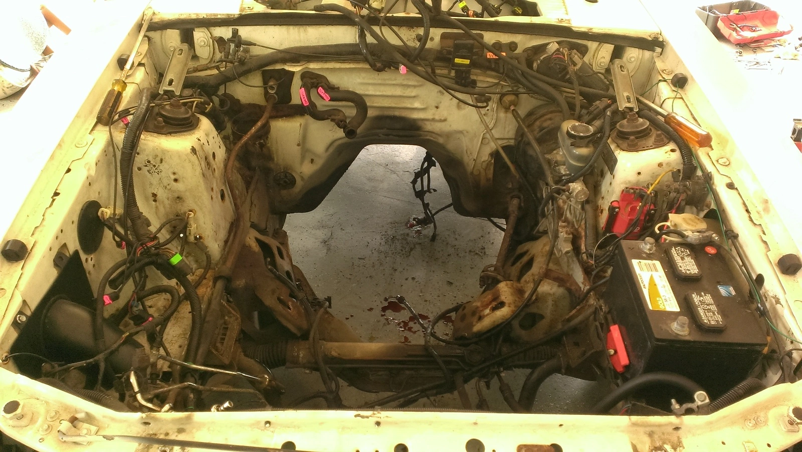

The previous owner was even more of a moron than I was. I don't even know how the car ran, none of the lines were correct, there was no pcv valve, all the smog equipment was non functional and only 80% of it was capped. The dumbest thing was the pump was still hooked up and the stock belt was being used.

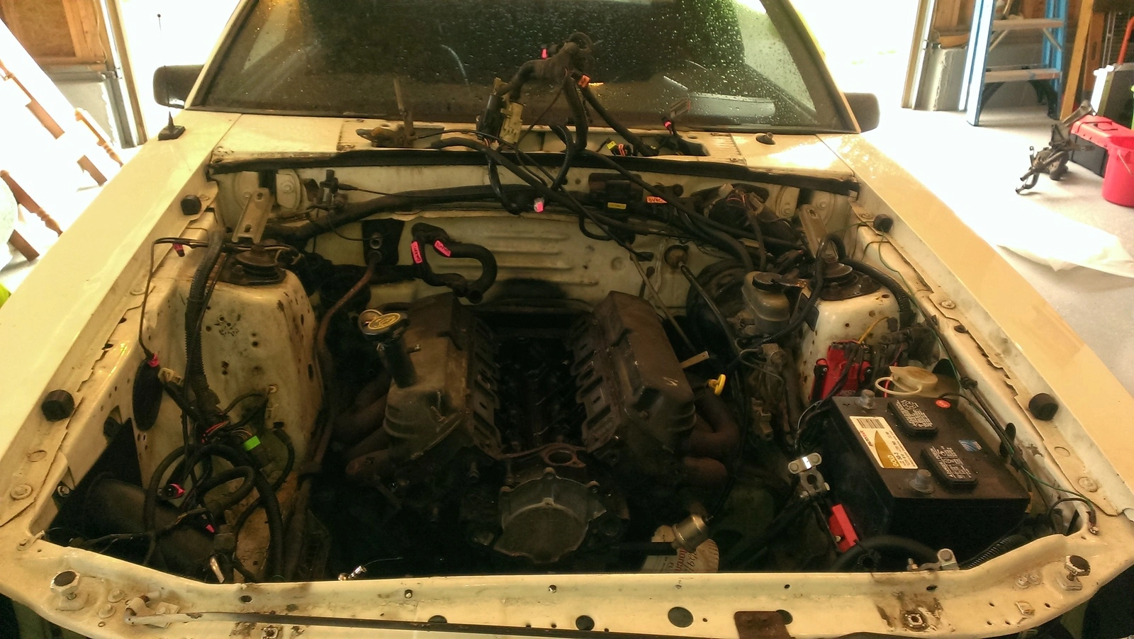

Ok first off I noticed there was no PCV valve on the back of the manifold.
Then there are some more weird caps that I don't know where they should go
One on the coolant pipe
Then on the very back of the lower manifold
If some one could explain those to me and/or post a cobra intake diagram that would be awesome.

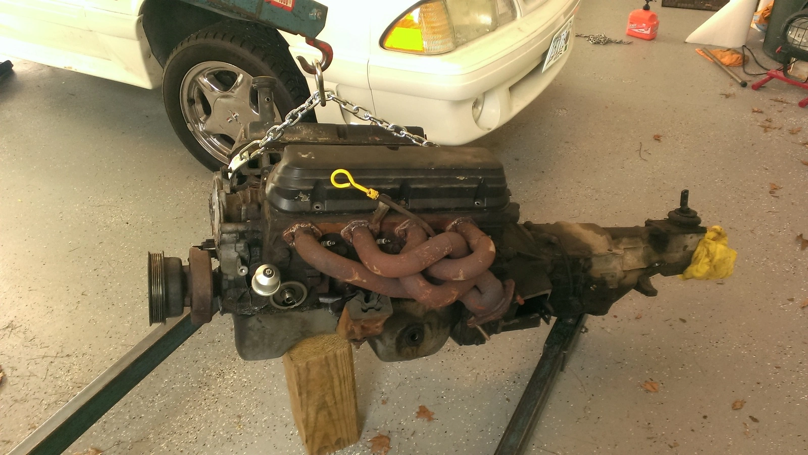

I have the same headers. I havn't had any issues with them yet and they have been on for several years. Car sat for many years with them on too. I love the way my car sounds mixed with the flowmaster american thunder. Performance is good too as far as I can tell. Dyno went better than expected but I didn't have a bench mark to start with except stock everything numbers.
I have same exhaust too with a bbk off road H. I know it is so played out but I really do love the sound flowmasters, and since my car isn't a daily driver I get to avoid the drone zone.
