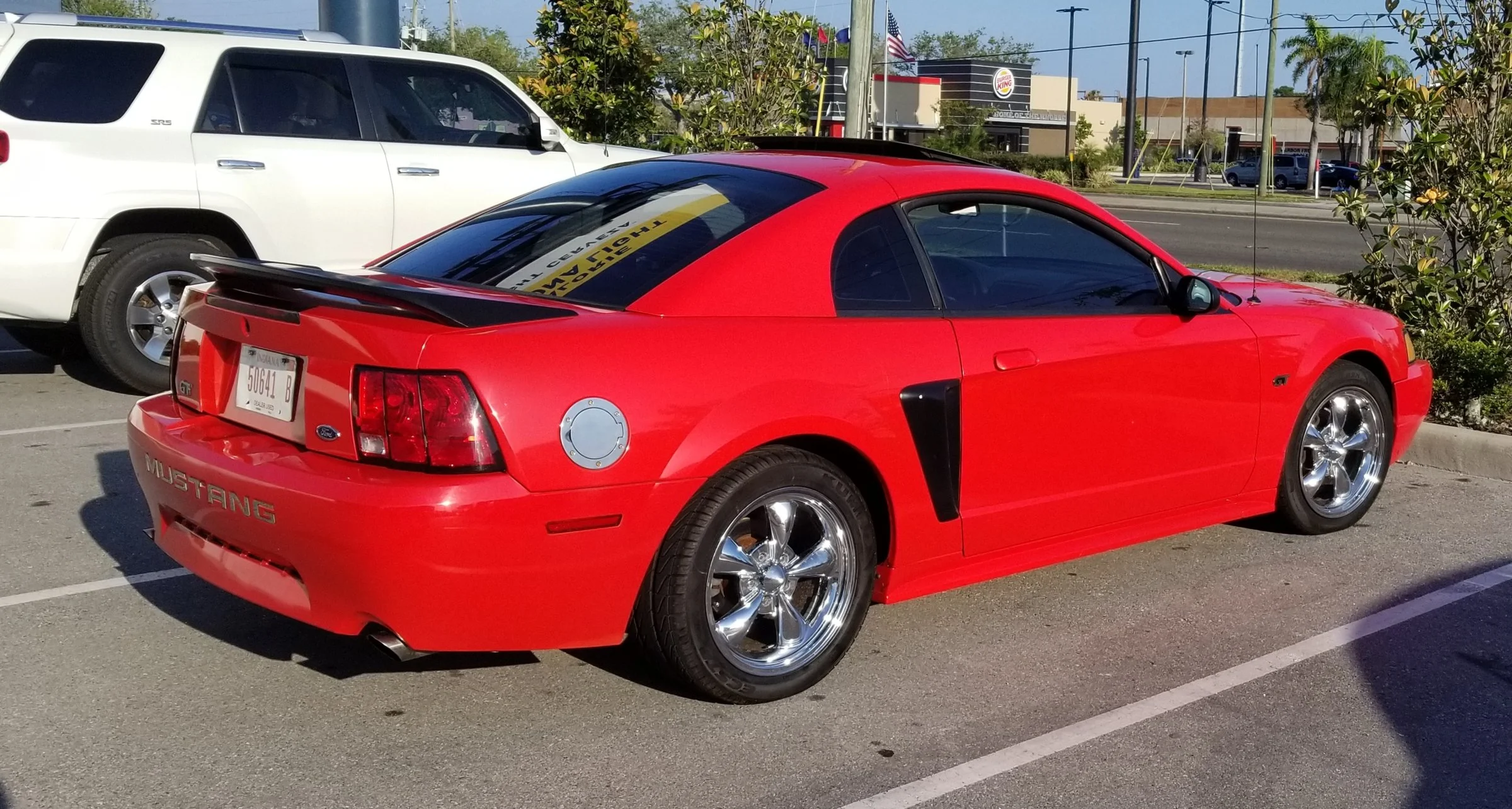

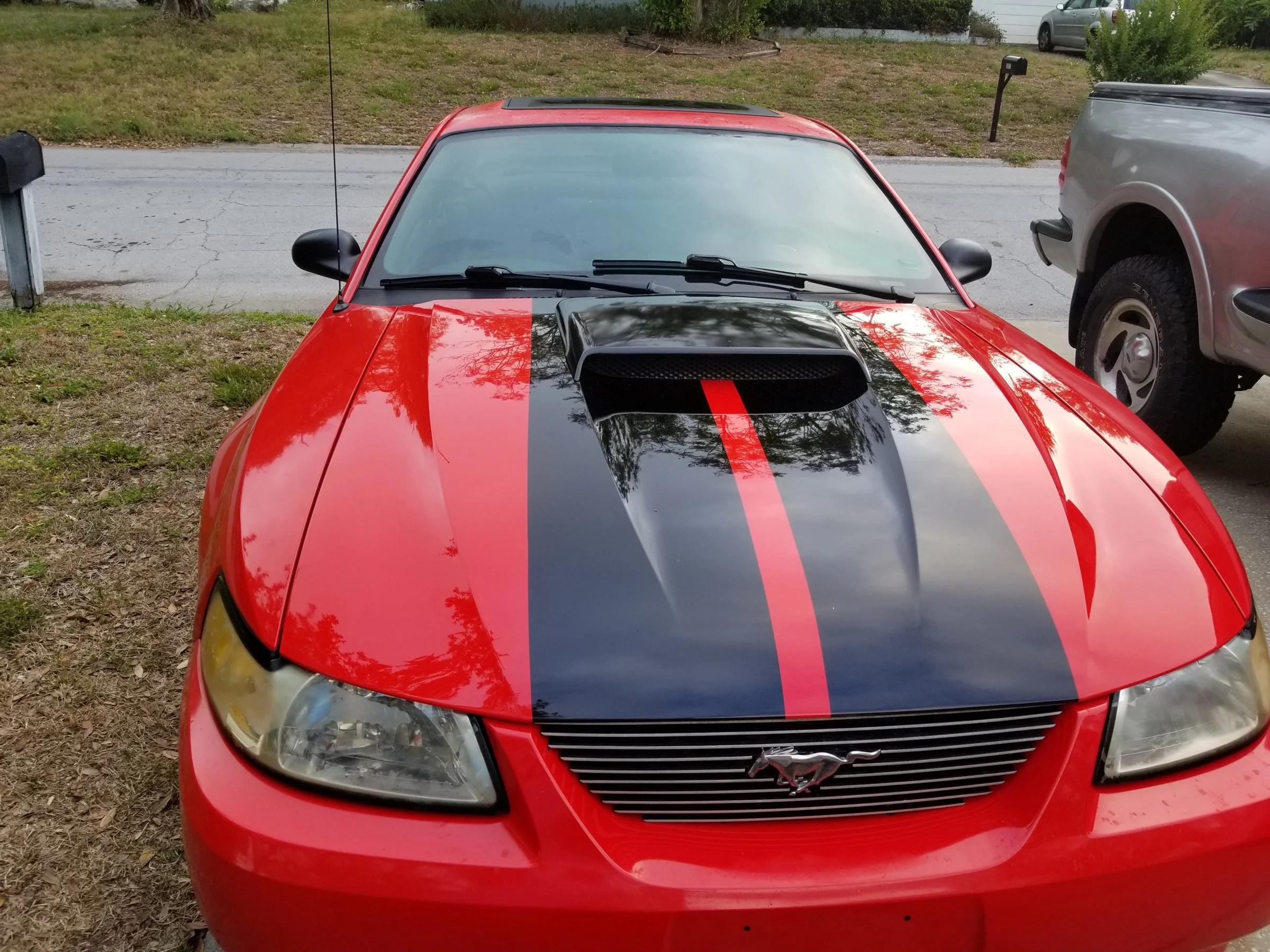

I just bought back my favorite mustang, sold it 12 years ago and it's been parked for 6 years now. I am putting together a plan for starting the car, I have never started one after it sat so long. If anyone has hands on experience with this type of situation I would greatly appreciate you advice or opinions..the car is a 00 GT 5 speed.
Thanks

Mustang roared back to life after I found a Weak connection in the new fuel pump. A 100 miles and the car is doing great
