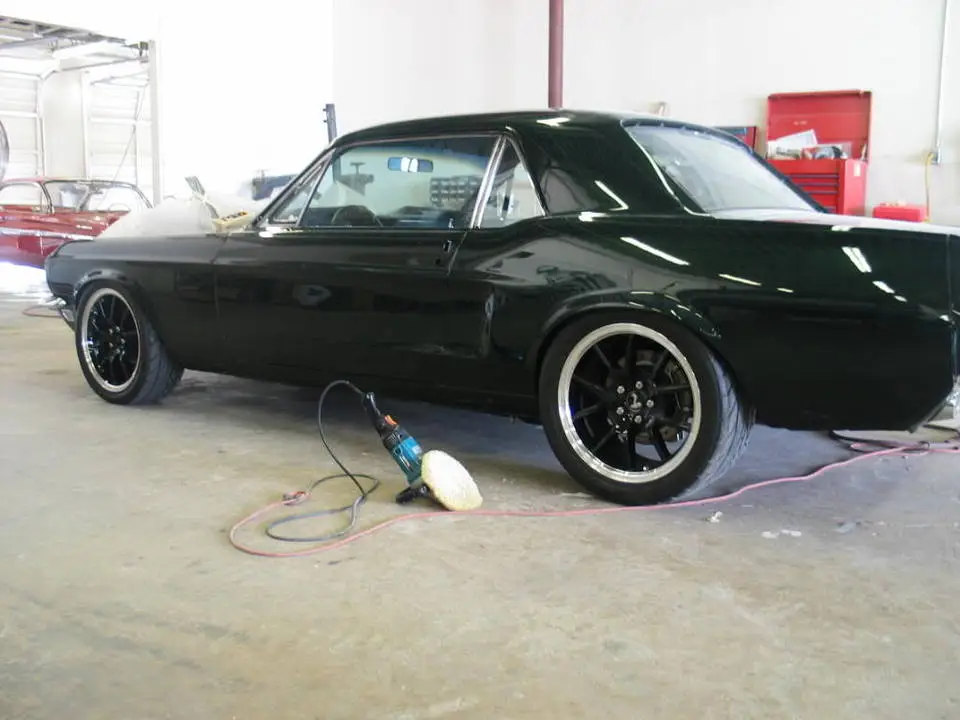

This isn't my car but here's a 68 with those wheels. It was posted in one of my threads a few years back.
I'm putting 17x9s on my 66. I'm going to do a 1" flare front and back. You'll have to space it out to get your 4.75" of backspacing. For example, my 17x9s have 6.12 bs. I'm using 1.5" spacers bringing the bs down to 4.62".

thats what I was thinking....since my mustang will be black...as far as backspacing goes...I am installing a mustang II front suspension, which has shorter spindles...not sure how this will affect wheel fitment yet....but I would love to run this wheels
p.s. are those fr500s 17s? for some reason they look a bit big...I may want to drop to 16s instead if that's how big 17s are, they kinda look like they are 18s at least out back

Ok, I'll admit, those do look good on a black Mustang.
I just don't see those rims/tires going on the car without rubbing big time. Definately will need to flair the rear quarter. I'm not sure how the MII setup will affect backspacing, I'm actually interested to hear. Reenmachine would provably know.

I just bolted the 17x9s on my 66 today and the fronts of course stick out 1" with the spacers. I mocked up the IRS and the wheels out back also stick out about 1" without spacers. I think maybe with a 67-70 rear end the wheels would tuck a little more and clear back there.

That car is green, and the wheels are 18s.
http://forums.stangnet.com/618064-fun-0mm-offset-bullitt-wheels.html#post5958823

Isn't that car green?
