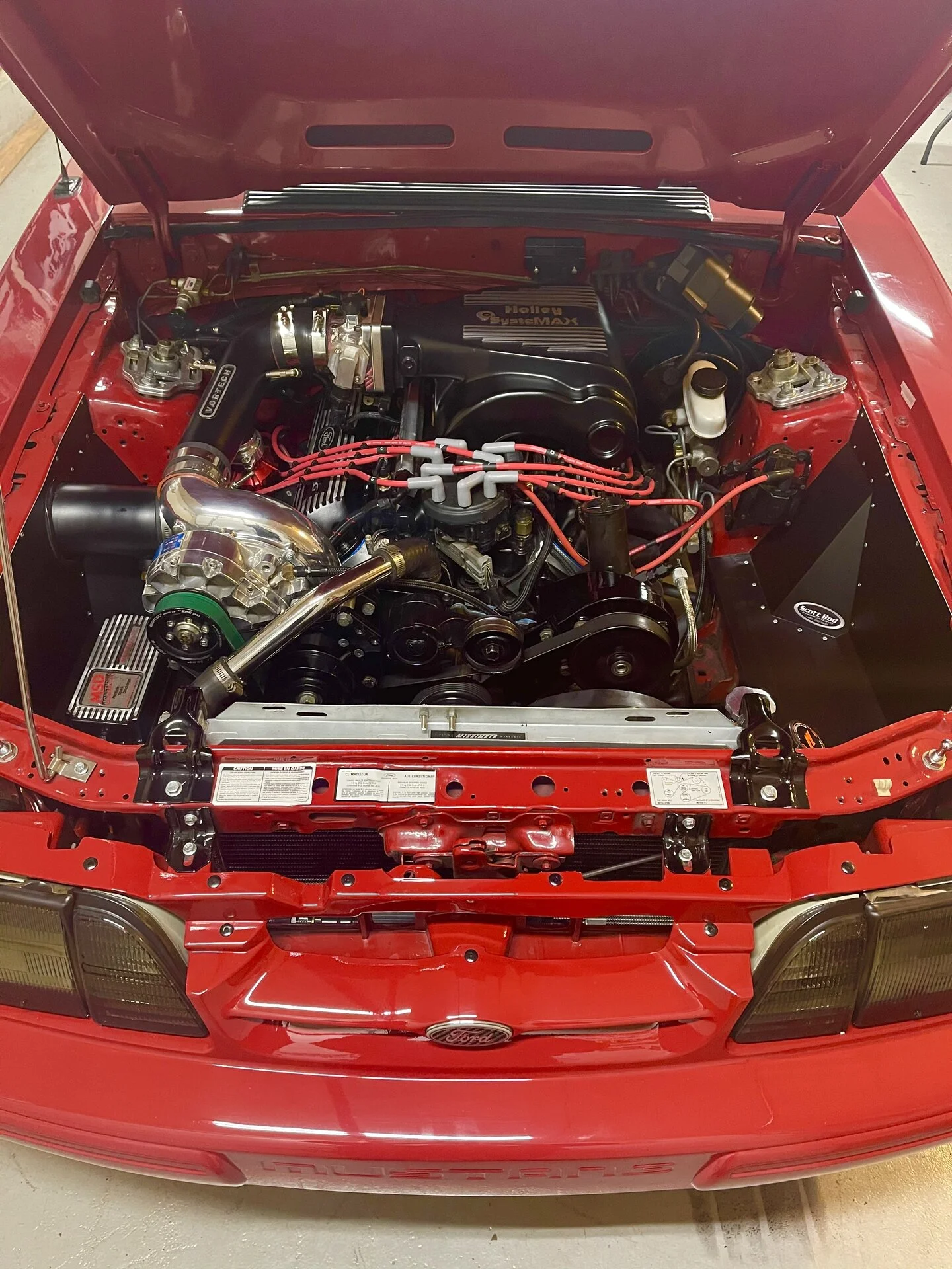

So the 90 is a weekend toy/ Drive it to shows and on Sunny Days. I am thinking about deleting the PS and AC to clean up the engine bay. I never use the AC and was thinking of putting 17 x 4 skinnies on the front and a manual rack.
I know I am going against my better judgment here, but am really leaning towards this. Anyone who has done this- not wanting to change to a standard rotation water pump. Did you relocate your tensioner to the driver side or reverse the spring to make this work.

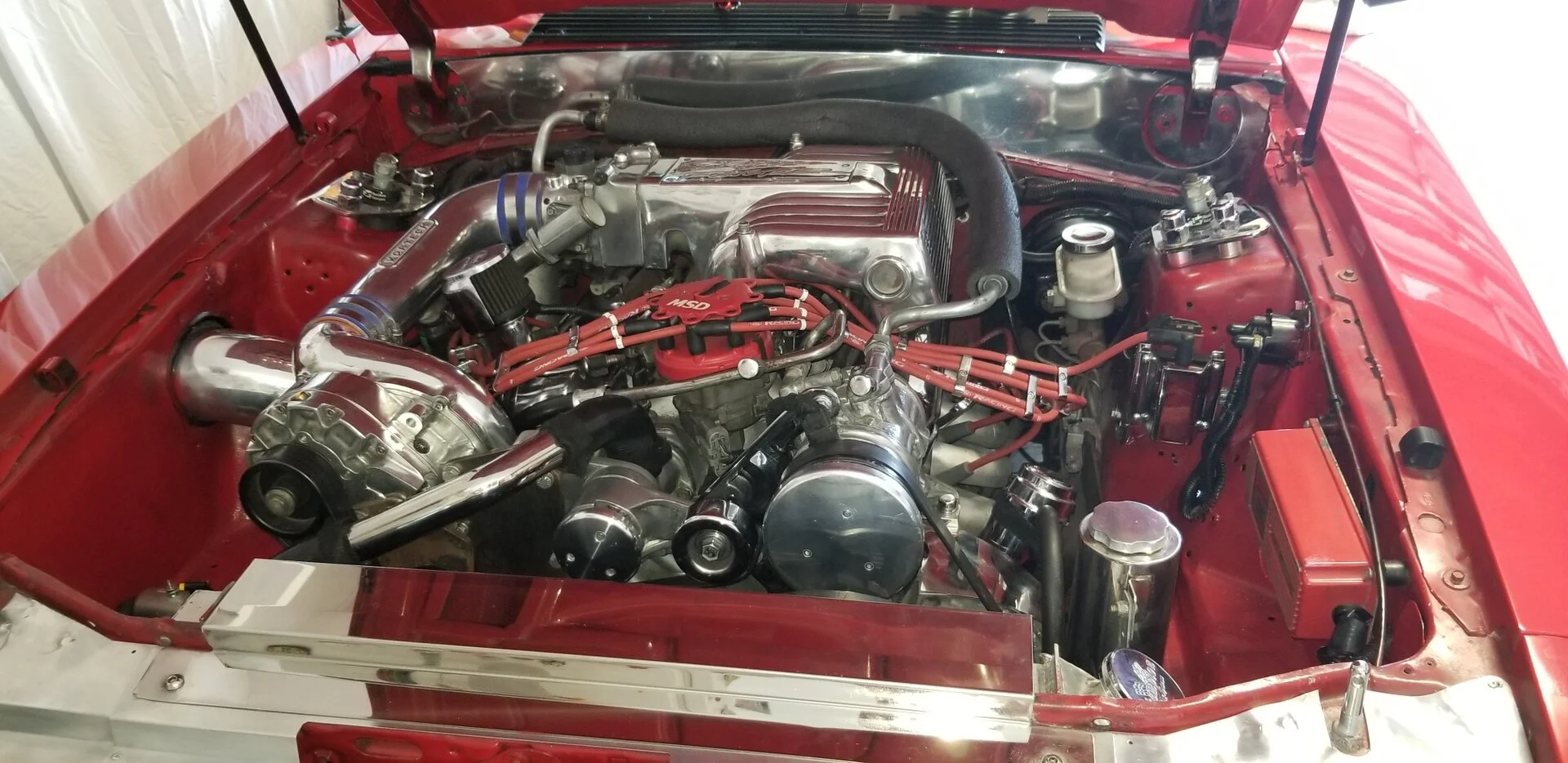

Oh man I’m contemplating throwing these Scott rod panels in while I have everything cleared since I’m in the process of the wire tuck. Did you have to drill then pop all the rivets in? Also what did you use to cut the hole for the passenger side?

With the AC out it’s such a cleaner look. I was like you and contemplated for awhile before I just finally said screw it, and removed it. Don’t drive it daily whatsoever, I’m more of a car show, weekend cruiser etc so I’d rather have it look clean and open. It made a huge difference I think. Also did you cut that hole for the wires to run through and up to the solenoid? I keep debating on moving my msd box from the passenger side to inside the fender some where since I’m in the process of the wire tuck, but idk if thats a good idea.

I am comfortable with the Aviation or Offset tin snips. The traditional big handle with little beak or HD scissor type are clumsy. I’d drill a pilot hole inside the carefully marked desired final hole and work my way out with right or left cut snips.
I wonder if those show panels are a really good water trap and will help rust out the inner fender panel and rail. If you never see a puddle and rarely get the car wet, I am probably paranoid. For a driver, drain holes underneath seem like a requirement.
