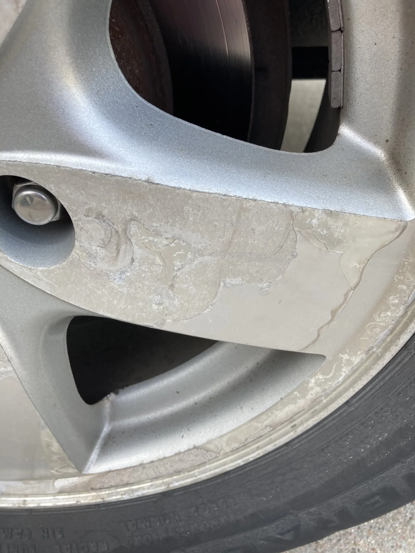

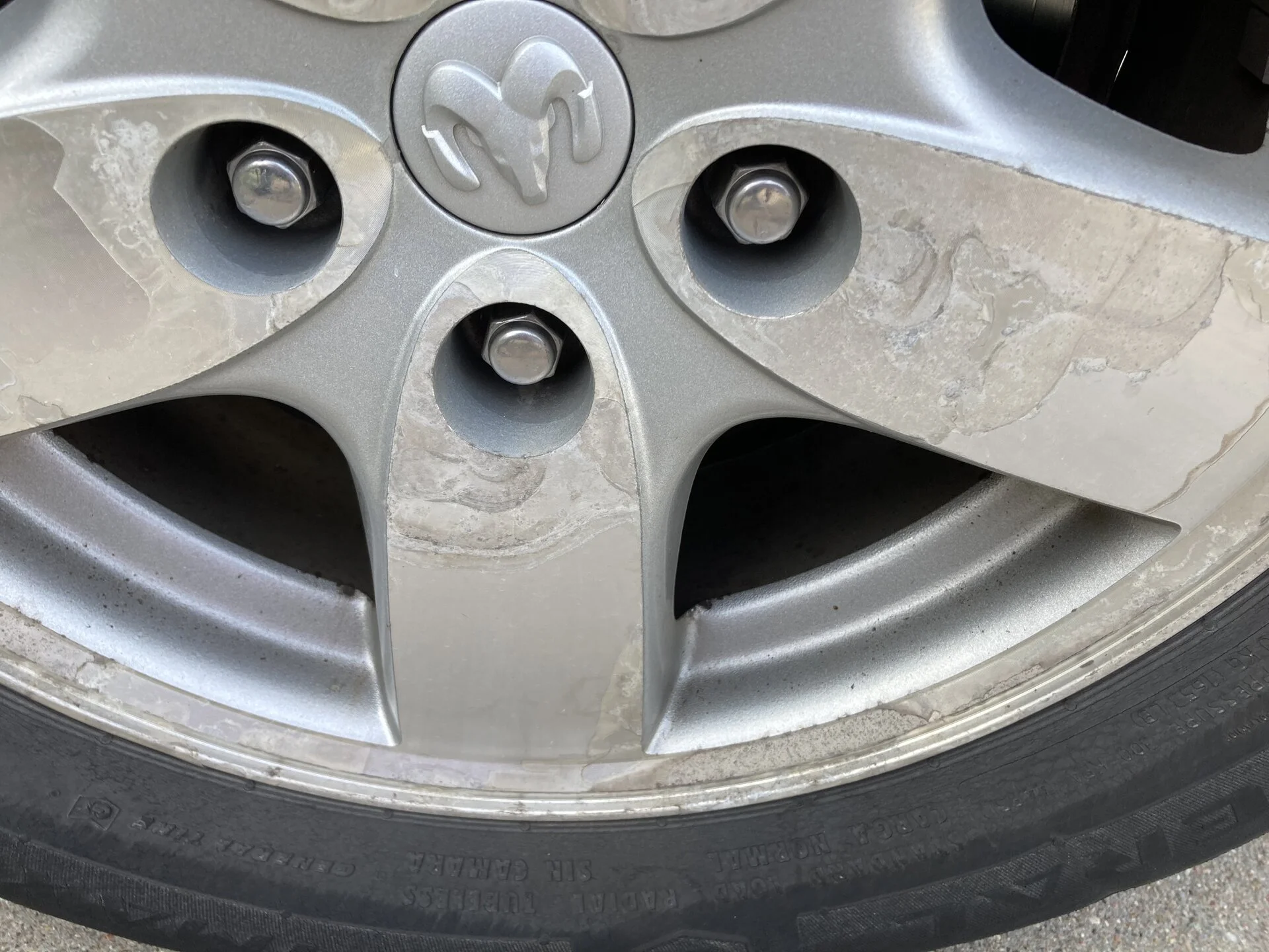

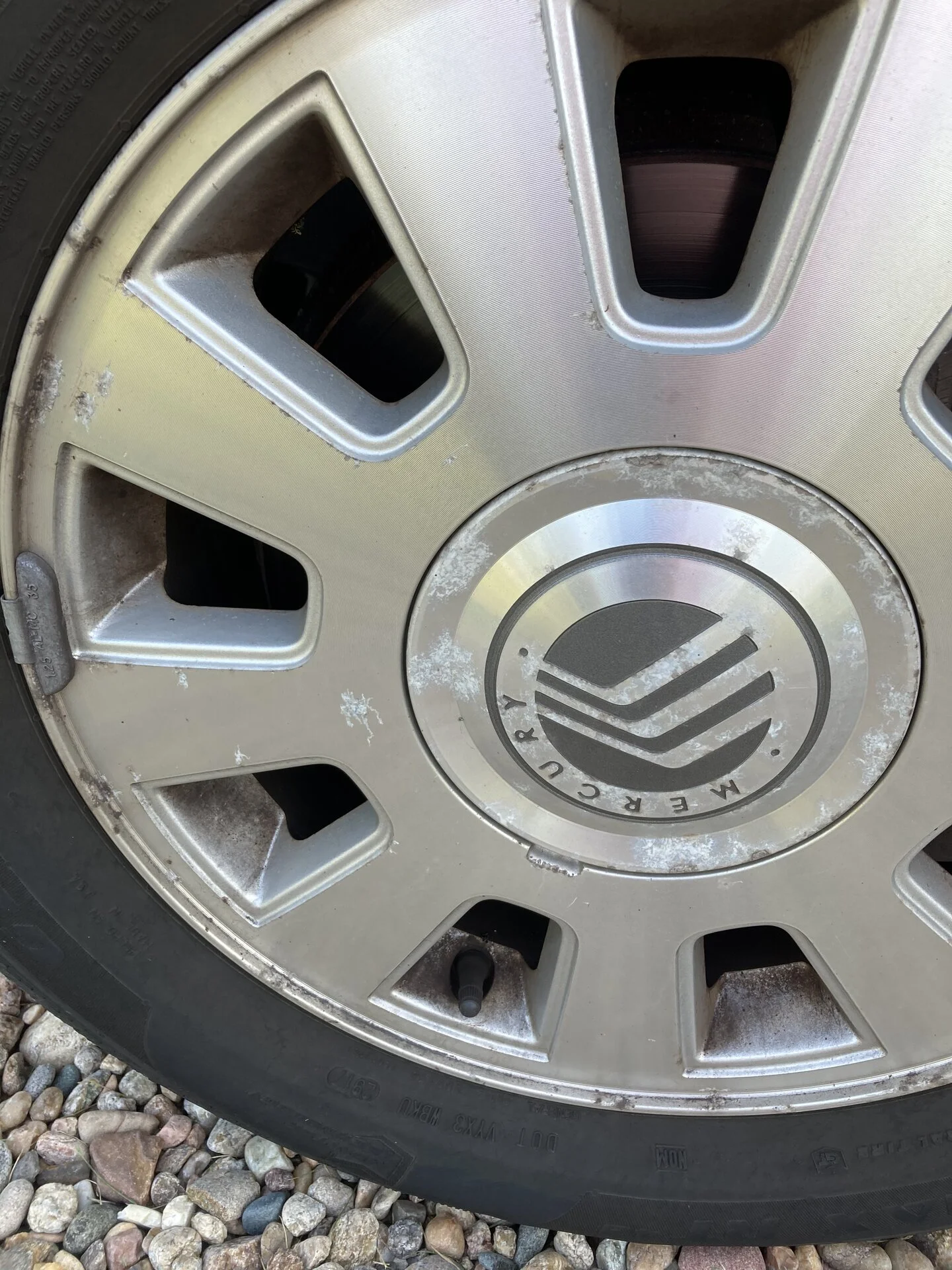

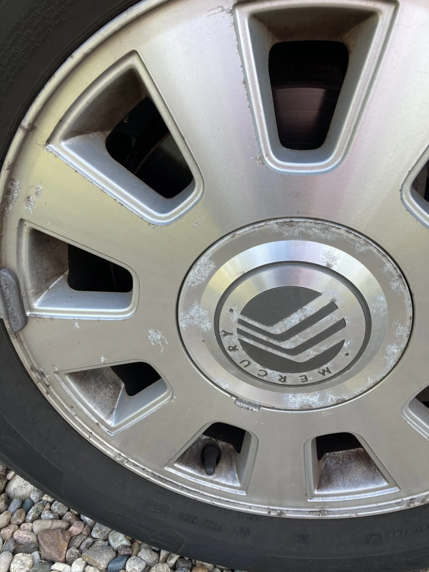

The Band Wagon’s wheel is the one with the clear coat coming off. The other 3 look much better while this one looks worse in direct sunlight with yellowing and missing coating . The Merc wheels and center caps are all pitted about like this one.
(Oh, even though these are not on a Mustang, it’s half about a Ford, and a lot of us have factory or aftermarket aluminum wheels.)

Looks like a good set of wheels to practice in. If you really take your time, you can vaseline all the black in the center cap and spray it all. Then go back and do the opposite. Then spray it with a clear coat of Duplicolor engine enamel. That stuff is pretty hard. I paint everything with engine enamel. I have used that aircraft paint stripper; it's garbage. You know it's garbage because if you spray it on your skin, you can't even feel it. I use the heavy duty Kleenstrip from Home Depot; the stuff that is like a gel, and has lumps in it. Don't get that on your skin. It's just like "Fight Club," if you get in on your skin it burns like hell, but if you pour water on it, it accelerates the burn, and it's like getting lit on fire. You have to keep a cannister of baking soda close by to neutralize a skin burn before you wash it off. That Kleenstrip bubbles the paint off of anything, and is incredible. I actually told Tmoss about the stuff years ago, and he was thoroughly impressed.

It probably was Kleanstrip from ACE Hardware I last used on a manifold and a mahogany writing desk. It ate through two layers of nitrile rubber gloves and was a nasty cold burn feeling! Another subject forum recommended the other product for baked on epoxy, but I can stick with what I know works.
The silver, high temp engine paint I used on two manifolds and the air tubes would match the non polished part of the Band Wagon’s wheels well and cover the parts that should be polished. I foresee a project or two with the kids.
I hope my pony wheels keep looking nice, and know now what to do if they do not.
You have to have the thick rubber gloves. It eats through nitrile instantly.

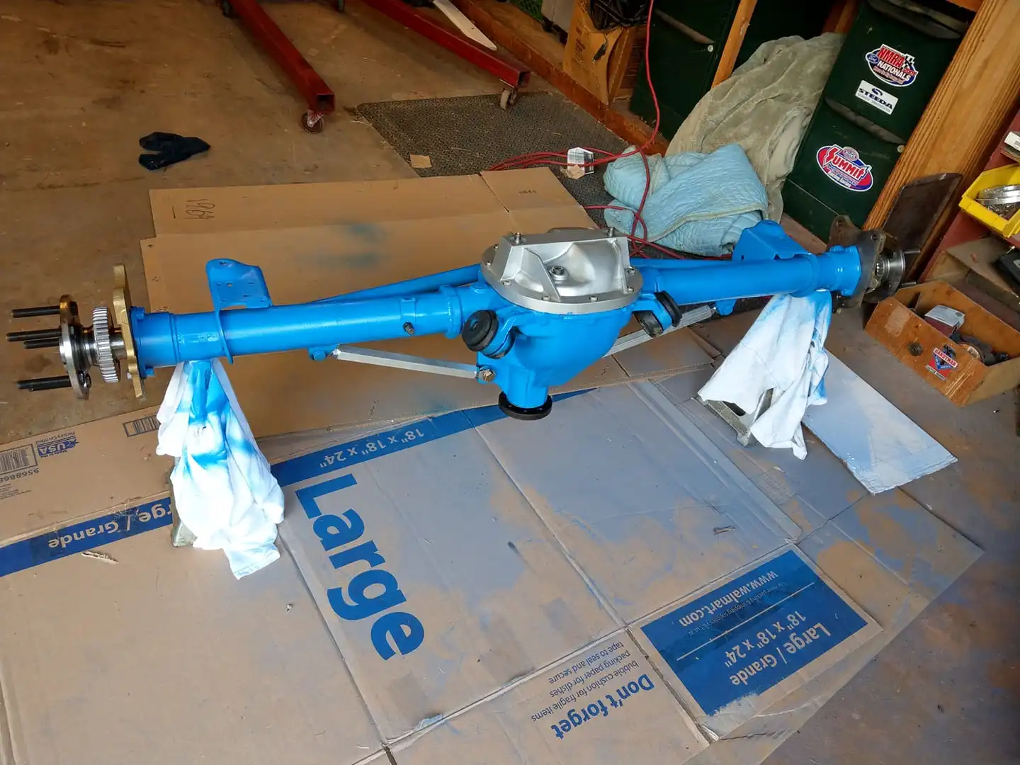

I know I am oversharing this picture, but I have been working with the little one too.

I stripped the clearcoat from my aluminum wheels when the clearcoat turned green. Aircraft stripper will not damage the aluminum or the rubber. I kept the wheels clean & protected with aluminum polish. What the stripper didn't remove, 320 & 600 grit wet/dry sandpaper did.

Although my Merc rims still need some attention this spring, The other rims are no longer a concern. The Band Wagon (2005 Grand Caravan with about 150k mikes) is awaiting it's death sentence of totalled. My family members that were inside were shaken up but seemed to be just sore last night. The van was T-boned by a smaller sedan hard enough to spin it three times. (How fast was traffic going to do that, as the sedan was also rear ended?). The back passenger door, rocker panel, lower quarter, and rear pillar did not bend enough to break glass or seriously intrude into the passenger space (a few inches and some nickel next to the stow and go pocket, is all). it's 15 years old, and before yesterday, the paint and interior lookeed almost new with no rust at all. The transmission, engine and the rest received enough regular preventative maintenance to be babied. The new, front passenger, tire popped the bead, the rim drug on the pavement. The front wheels are pointing way too far to the left, and there was PS or transmission fluid dripping from the passenger side of the air dam and left a nice puddle at the scene. The pillar behind the sliding door was moved in, and the back side window popped open when the sliding door got pushed into its space. And the back passenger rim has pavement gouges and maay not be in the right place or angle eirher. But the tire is still full. An adjuster with the insurance company., but not assigned to the case was on the lot for another vehicle. He took a look, and told us to take everything and the plates The damage, while fixable, would cost 4x the value is of a 15 year old van, even with all the features and in very good condition.
