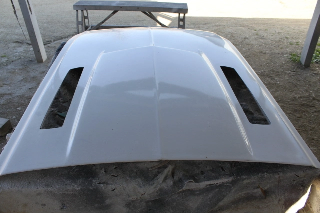

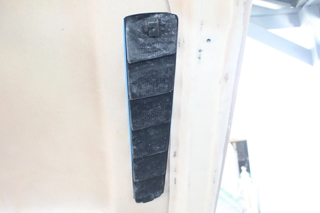

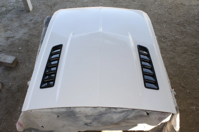

i bought a set of louvers from stang-aholics for a buddies car. they are carbon fiber and look decent when installed. i put them on a fiberglass hood but they will fit just about anything.
FYI, the cowl and base of the windscreen is a high pressure area when the car is moving. It doesn't help underhood ventilation unless the car is stopped. The middle of the hood, on the other hand, is a low pressure area when moving and with that in mind, I see louvers being far more effective than lifting the rear of the hood.
