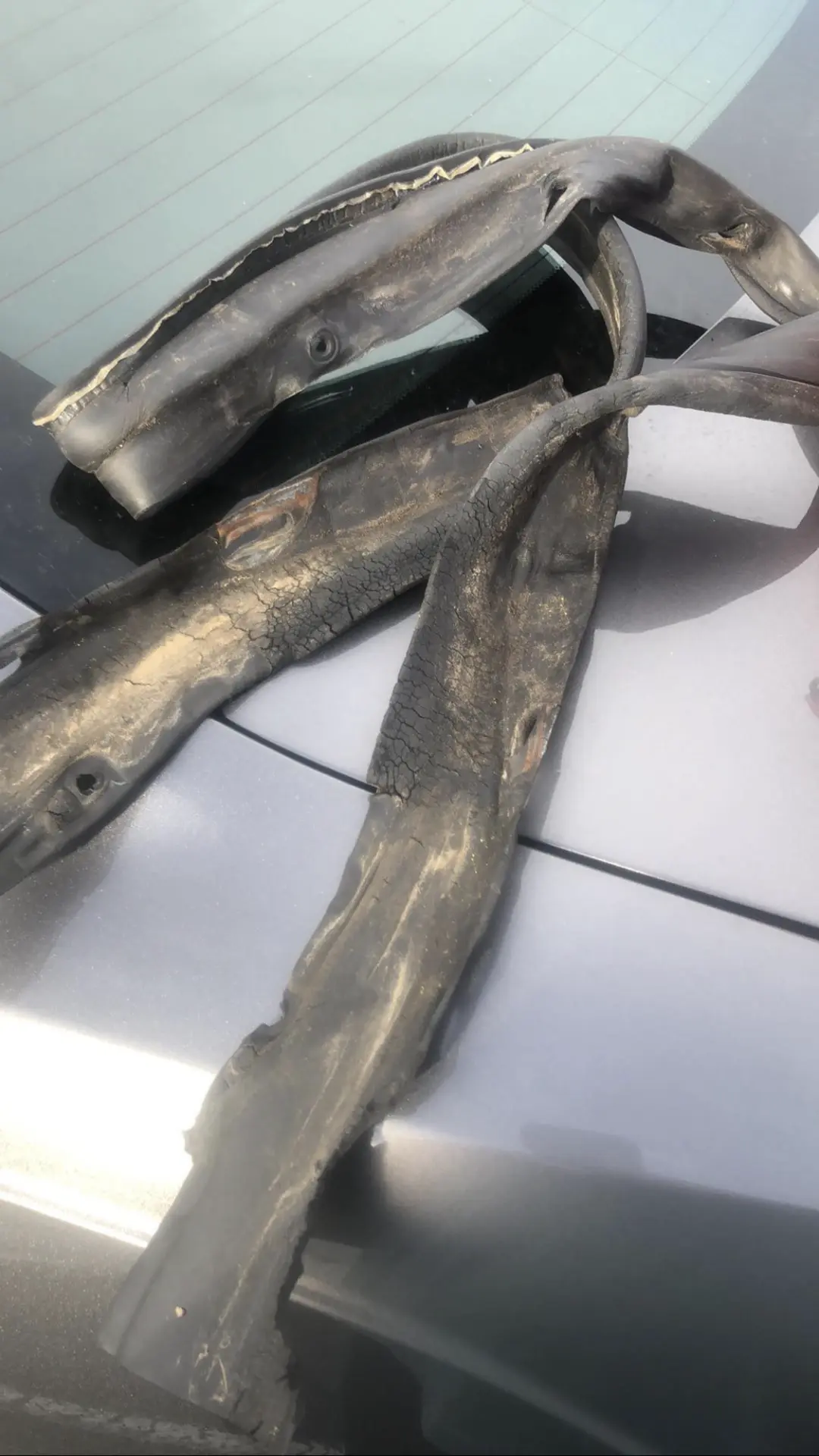

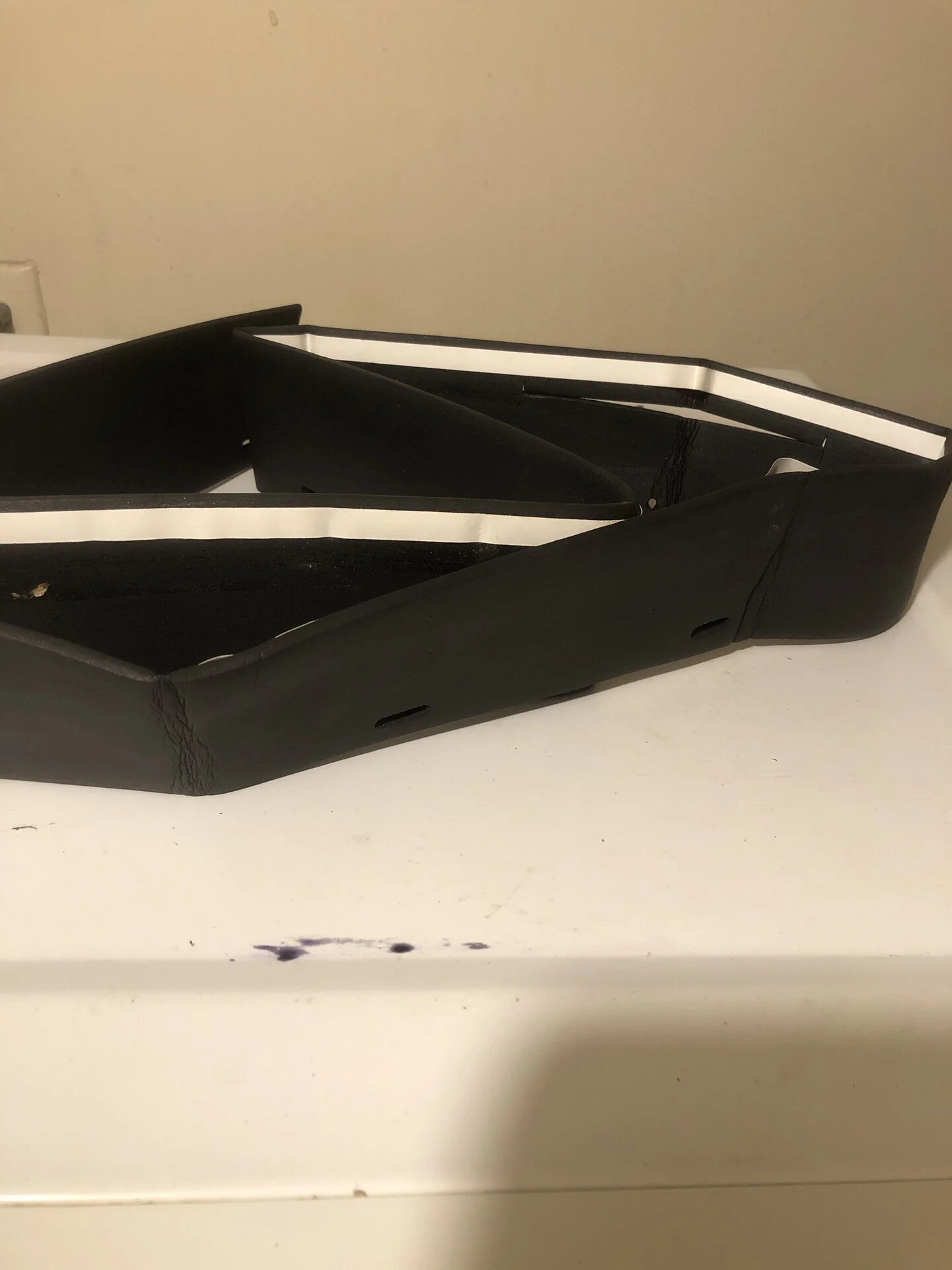

There is a seal underneath the area where the top bolts on, it’s $36.My car had leaks on both sides in the same spot, the seal has double sided tape to fold over the lip, there was a 3-4” section on both sides that was dry rotted and allowing the water in.You could watch it trickle in the corners while it was raining.Its called the retainer plate seal, I ordered it from parts depot and it’s an OEM part.You can see in the pics the sections that are bad, I’ll put the original and new to show the difference.
