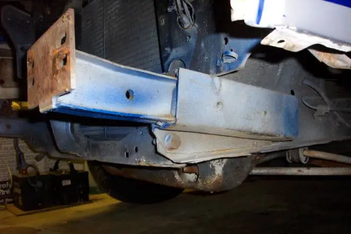

Without pictures to prove otherwise, I'll never believe it. I still own four 71-72 Mustangs and one 73. It is not physically possible to attach a chrome front bumper to a 73 urethane bumper bracket. If you installed a chrome front bumper, you used 71-72 brackets. I posted pictures of what the 71-72 and 73 brackets look like in the old thread, which are obviously completely different animals. I look forward to the day when/if ratio411 attempts this magical feat.

I have done this. The 71-72 front bumper brackets are totally 100% different than 73 front bumper brackets. the bolt holes in the frame are the only thing they share. It is 100% impossible to put a 71-72 bumper on 73 bumper brackets. You'd have better luck trying to put a 71 bumper on a Camaro. The outer, upper corners of the 71-72 bumper are about 2" too high to clear the 73 fenders properly. That's why Ford spent a bunch of money modifying the fenders for 73.

That's five 71-73 Mustangs. The proof is in the pictures that you conveniently didn't post over the past 2 years (for obvious reasons). Just for the record, I'm a mechanical engineer who has disassembled and reassemble several 71-73 Mustangs over the past 25 years.
Have I installed a 71-2 chrome bumper on 73 brackets? No, cause it can't be done. The only way to bolt a chrome bumper assembly to 73 brackets would be to fabricate custom 90° adapters. It's not theory, it's fact. The 73 brackets have vertical bumper mounting holes. 71-72 brackets have horizontal mounting holes.
73 Bumper mounting bracket:
71-2 Bumper mounting bracket:
