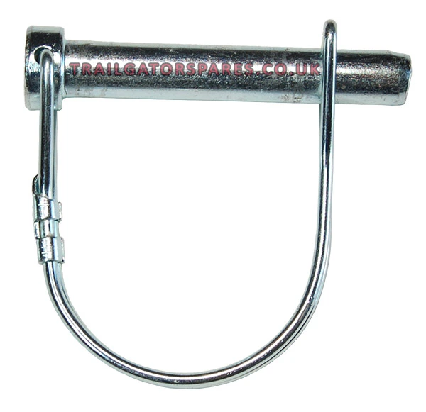

Can you give me a little more detail on removing the latch pins?
On mine the point where it looked like the frame should have been bolted to the rams were instead connected with what I call hitch pins, like what you would use to keep a trailer hitch in the down position on a receiver ball. Pretty simple to remove. Yours might still be bolted or however the factory fastened them. Not really sure how I can give more detail, look next to the rear seat with the top up and you should see the point I'm talking about.
