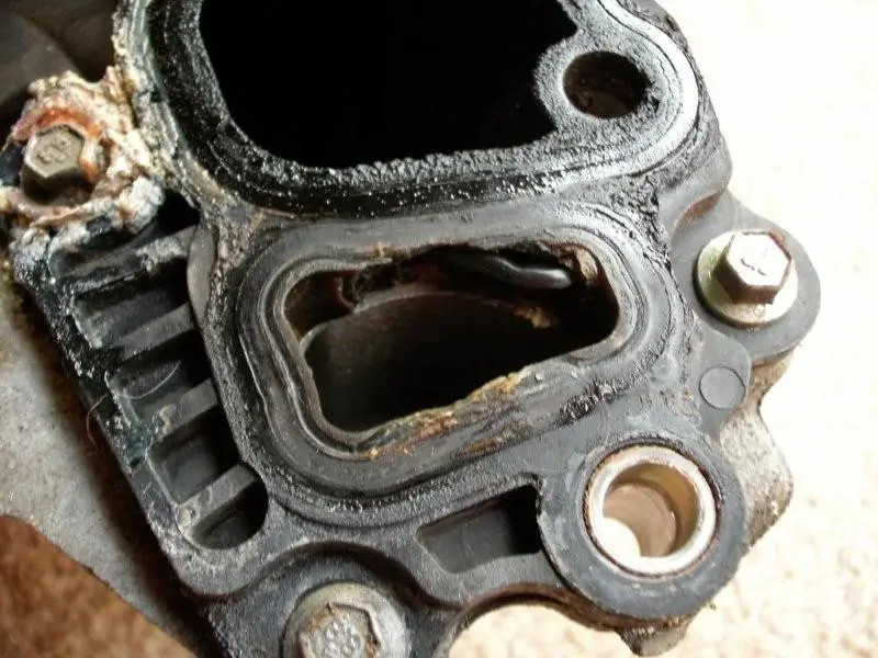

After having a new replacement manifold and coolant crossover installed, I decided to investigate the old manifold.
Removing the crossover from the manifold I found where those pieces of plastic were coming from.

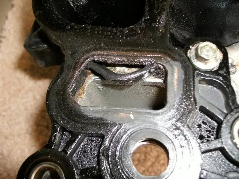

There are 2 channels designed into the manifold that accepts a flat 'O' ring to seal.
The inner wall of this channel is very thin.
The stresses of the heat from the engine, the cold of the natural elements and the basic vibration stresses on the engine itself, and/or improperly torquing of the mounting screws, over time, caused this inner wall of the channel to fail and break off into little pieces, thereby allowing the gasket or 'O' ring to squeeze out and into the passage of the coolant, allowing a leak.
This failure happened on both sides of the crossover. There is no repair to this plastic channel of the manifold that will withstand the rigors of the what the engine goes through.
There are no replacement gaskets for this unless you buy a complete, new replacement manifold, and because the inner wall of the channel was broken, the new gasket would be useless anyway.
