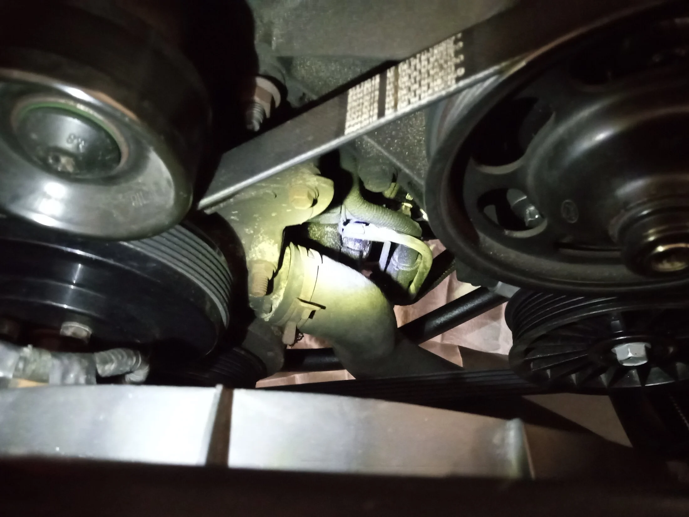

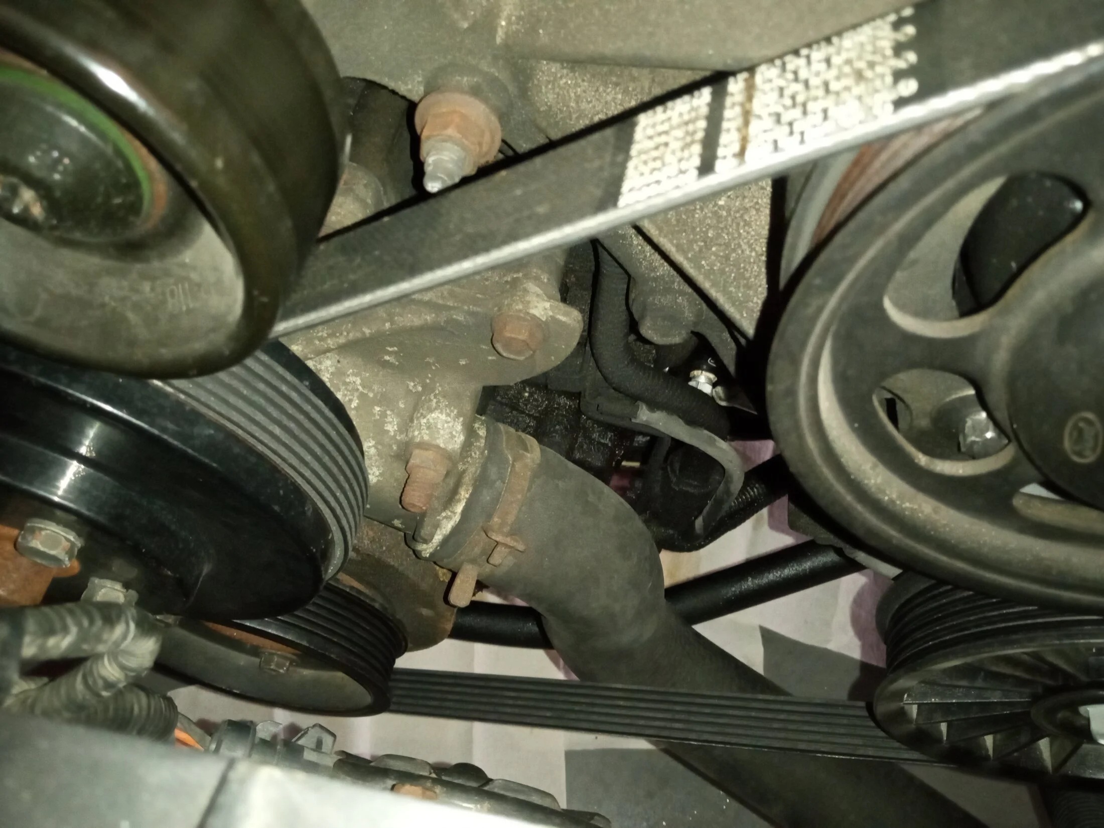

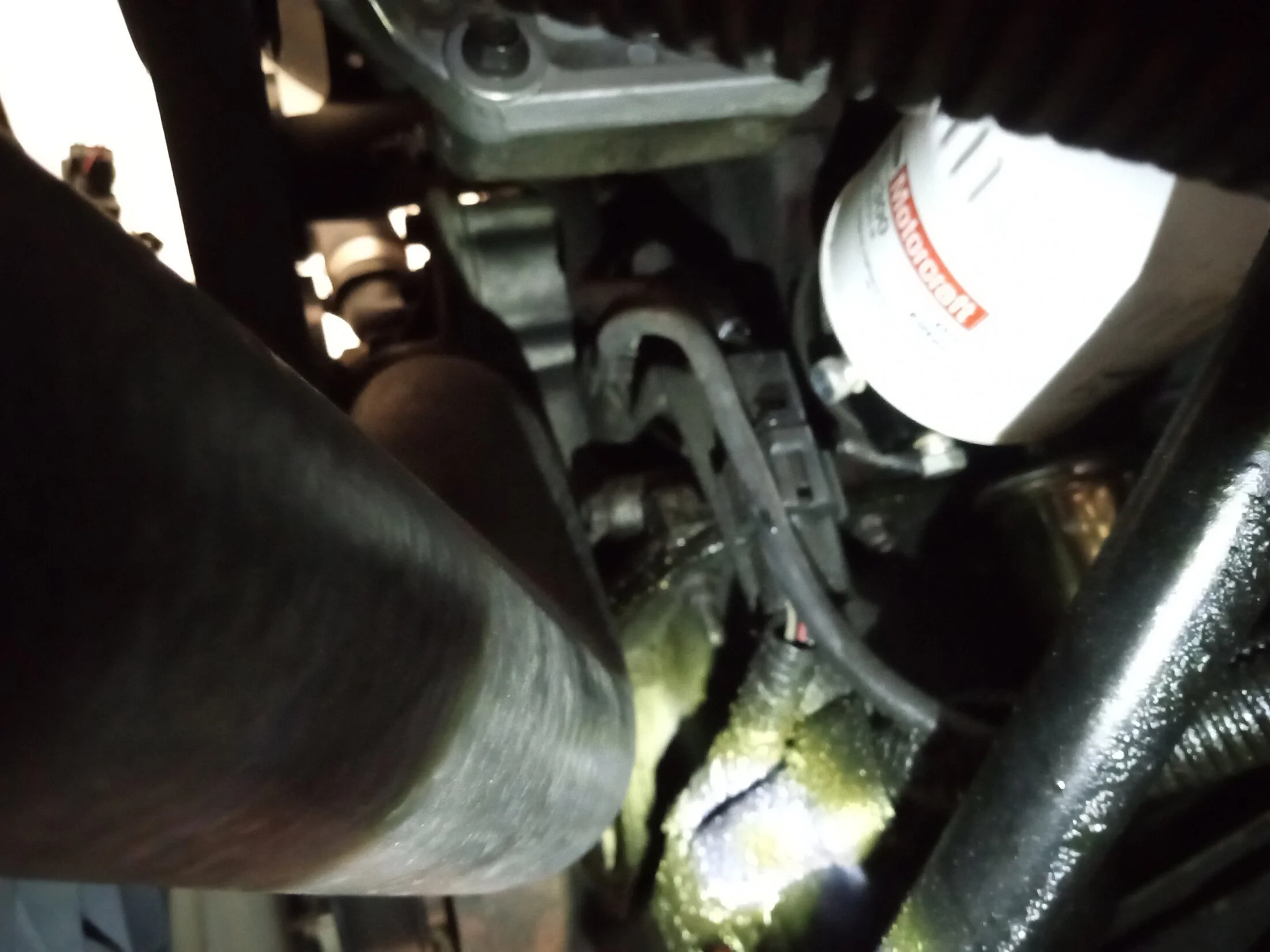

95 Cobra 130k plus miles on factory engine that's almost all original. Have had the car for 23 years. Water pump, timing cover, etc that has never been touched.
Brought it home from errands and noticed puddle of coolant under front driver's side. Looks to be leaking just above oil pan, can't tell if it's coming from the water pump since it's recessed in. Not sure if it's timing cover or head gasket. Pulled dipstick and that's looked good. Any ideas from what y'all can see?

That lower rad hose looks suspect. I would clean it up best you can( brake or carb cleaner) then dry it up., Next run her till she gets hot and start your investigation.
You can add dye, or even pressure test the coolant system but start with basic shot first.

Ok. Lower hose looks all dry didn't see anything on it but I'll try to clean everything and check. Hoping easy fix.
Ok. I got under and checked the hose good. Don't see anything from it or the water pump. You can see seepage from the timing cover where is mates to the block a few inches above the oil pan.

I'm try'n to recall, I've only changed a couple dozen timing covers, the lower bolts on the cover go through into the crank case, I would suspect the water pump leaking at the back.
You need to start with pulling the water pump anyway.

Ok. Id be happy if it was just the water pump. What would explain smelling coolant at the front of the car after driving, and losing a tiny bit of it but not seeing any leaks or drips anywhere? Did this for awhile before it actually started pouring out the other day.
Just to update everyone, I got it to leak and saw it coming up a bit higher so put my hand to upper right side of timing cover and seemed to leaking from that. Looked to be the coolant passage area from the water pump and timing cover to the block. Quite relieved to find it, pretty positive that is it, so changing out the timing cover gasket should fix it.
