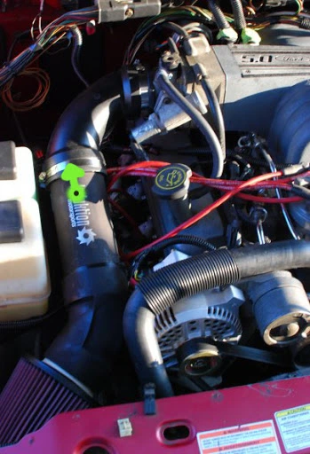

Hey guys. I mounted my nozzle under my intake (NX single stage, wet) And pointed it in the orientation of the arrow. Do you think the fuel will have an alright time making the bend, or do i need to relocate my nozzle?
Opinions?

I've seen many in locations around there so others are doing it but me personally, I would get it as close to the valves as possible. I would drill the intake just behind the TB or drill the TB.

Manufacturer specs usually say about 4" before the TB blade. Drilling into the TB with a wet shot would most likely cause puddling in the intake= explosion.
Stock intake is very restrictive and kind of limits your shot size but that's a whole different story. If your nozzle is orientated the correct direction you should be alright.
Looks like a stock motor, how big of a shot are you running?

looks about 3" inches from the TB blade, probably plenty far off, i was just stating what the manufacturer usually suggests, some guys even put it BEFORE the MAF.

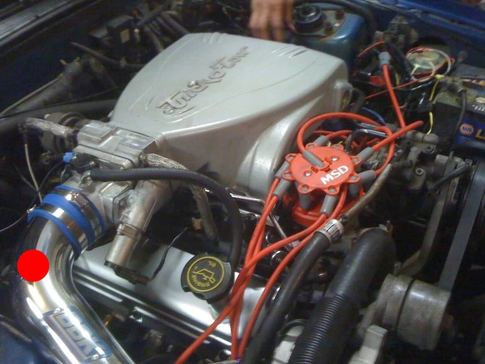

Once i get my kit rewired this is where it will be going into the new CAI:

Im going to test at 50-75-100 and run 100 on the street. maybe ill move it a bit closer? Testing will tell i suppose. thanks for the answers guys.

Tested up to a 75 last night with 13* initial timing. Worked like a charm. Thanks for the advice guys.
