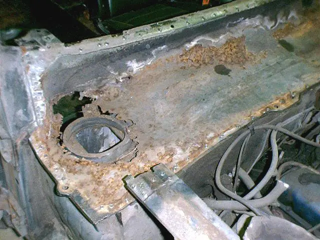

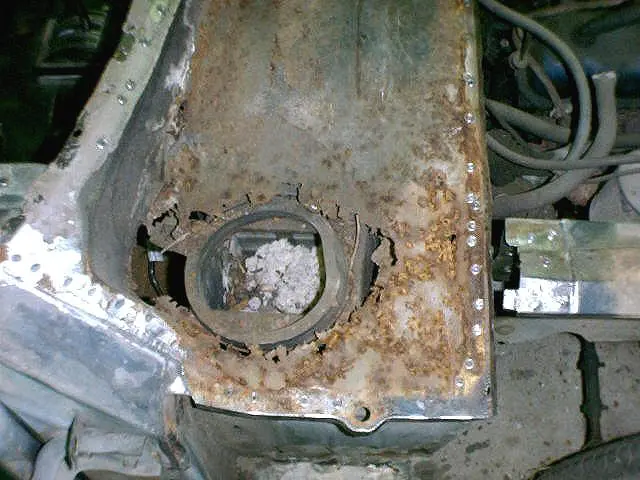

well i know the cowl is leaking becuase i had to take out the rusted vent .thats not good it had ahole size of a bowling ball in it its been a real pain this car has peved me off so much im thinkin of scrappin it but have to much invested ya know by the way that guy dont know how to read Red Neck
:SNSign: lol thats not funny by the way I drop a pint of fiber glass down in the cowl with matt to day hopefully it seals right cant do anything more un less redo the hole cowl .god hepe us if fales im not no young buck
There is no cowl replacement or repair kit for 71-73. For a major repair, your best bet is a doner car or doing some creative sheetmetal forming and patch welding. Either way, to do the job right you will have to remove the dash pad, hood, fenders, misc. wiper parts and windshield to gain access to drill the 300 spot welds that hold the exterior cowl vent on.
I'm not sure the fibreglass route is a good one...where is the rain water going to go now that the drain holes are full of resin?

To fix you problem, the idea of dumping in a pint of resin and hope all is well is not a close second to the best way to do the job. For one you can block drain holes ment to be there and for another you can create places for the water to pool and create more rust holes.
Not knowing the layout of the 71-73, I cannot offer specific repair advice but try to remove things under the dash and if possible most of the dash and get to the cowl leak from below. You might be able to stop the leak for some time but unless you totally remove the cowl cover as the above picture show, you will not be fixing the problem. You will be band-aiding the issue.
