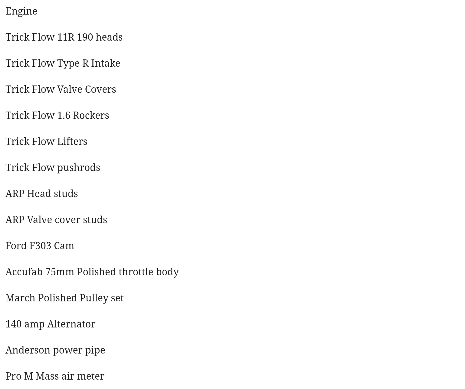

I have a 93 coupe with a 351W 95 Lightning motor. It has nearly new parts listed in the picture download. The bottom end is stock as far as I know. My car also has full length headers, Team Z K-member, and a Glenn's fuel system. Im thinking of having the engine replaced with a Coyote swap. What would I be able to sell my motor for, ballpark price? Can I reuse the TKO600 WITH the McLeod clutch, or will a 6 speed auto from a Coyote GT fit? I'd rather have the auto if given the choice. Id want AC of course. Anyone have any good info I can read up on to get started? Thanks.

Your engine in parts is probably 2 grand.
As a whole, I would think a lot less.
Most people are a little skeptical when buying a used engine, but the heads and intake are easy sells.
