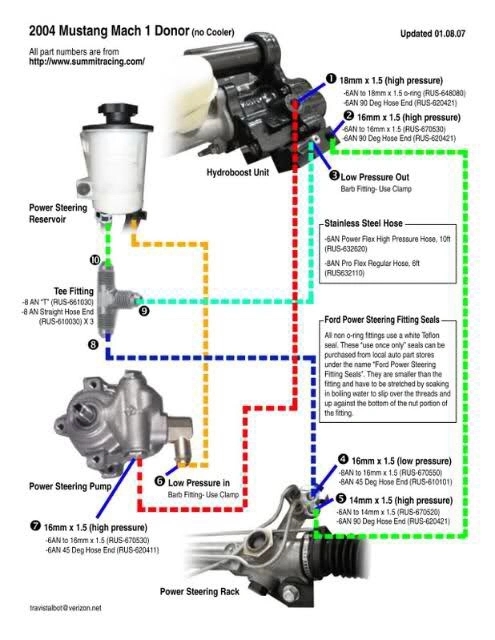

@89oem @Jason 302 @TOOLOW91 Thanks for all the info and replies! I swapped to a 9" rear end with discs last year, I've seen a few different ways to do the hydroboost swap and just curious on the easiest way to go?

This may help you out on the hydro boost questions
We used a hydratech booster that allowed us to use the stock fox pedals . You can modify a Mach 1 hydro boost setup and weld the clip on the end to take the stock pedals as well to my understanding

You can use a factory hydroboost from a donor with the fox pedal, all you have to do redrill the mounting bracket with the fox bolt hole pattern and it all lines up perfect - this is what I have, works flawless and no concerns about welded rod ends (some folks worry theyll snap under stress, use or emergency braking...) @Mustang5L5 is our resident entire brake system guru.... if you plan on swapping out your entire brake system.
