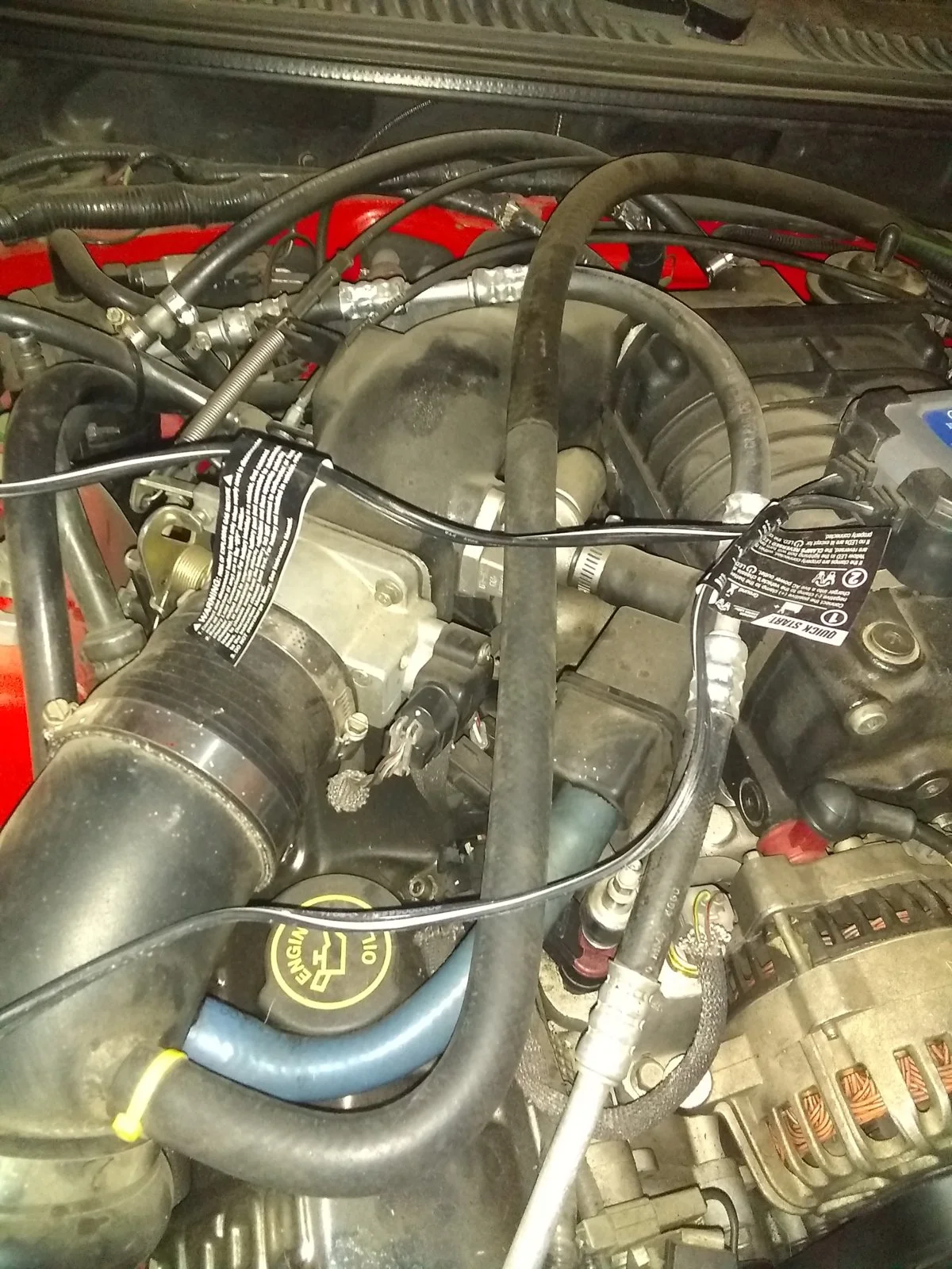

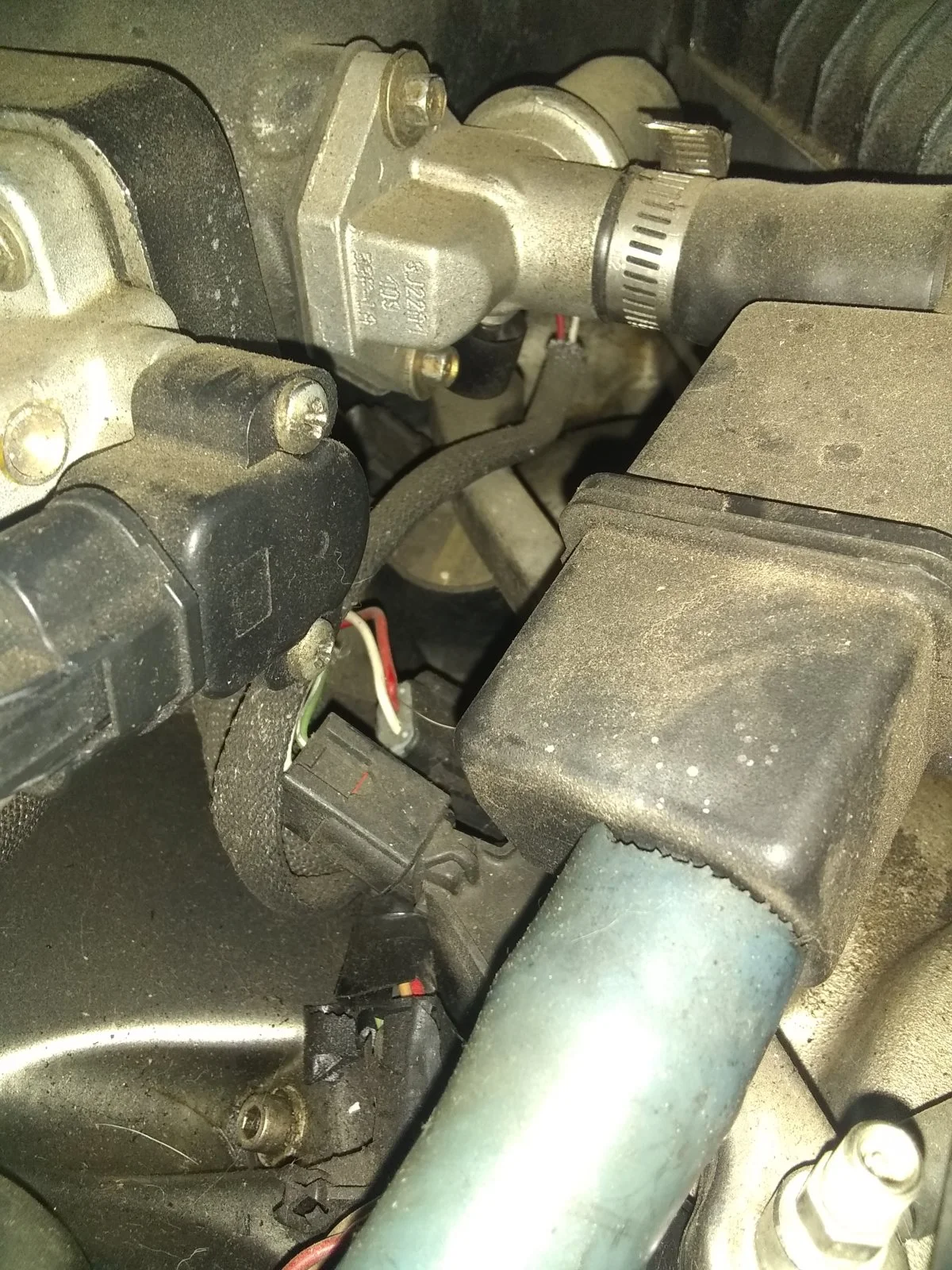

Nothing i can see as far as water damage or corrosion. The theft light is not flashing, nor does it function in a way that indicates something wrong. I have tried to check spark but ive been told my multiple mechanics that this would require removing the supercharger just to do so...
View of throttle body side of supercharger covering coil packs
Hi,
I apologize, should’ve clarified, whether a twin screw, roots, centrifugal FI, limited access won’t prevent access to any of the ignition & Fuel
Since this is a ”Crank, no start” issue, with the EEC indicat potential issues, focusing on the (2) points below in order to establish baseline info. EEC’s fail, but fairly atypical. This Testing will narrow things down, considerably.
~~>Ignition. Correct input to Coils. Pulsed ground trigger from EEC. Correct spark timing..**
~~>Fuel system. Presence, Pressure & flow. Pulse from EEC. Correct injector timing. **
IGNITION:
If you, a friend has a known functional, spare COP, and a spark tester or plug....
1) Pull a COP’s input plug & plug it into the known functional spare with a Spark tester or plug inserted, ground to the block. Have a helper turn it over. Should see a spark. Try a few of them. OR...
Multimeter & a NOID light..
A) Using a NOID light, you should see cyclic ground pulses occurring as light pulses as the engine is being turned over. Then, with a VOM on DCV, test the Voltage inside the connectors with the key On, should be 12VDC.
FUEL SYSTEM:
2) Using a NOID light, test a few (2) pin injector’s plugs as the engine’s being turned over. You should see a flashing light. Then, With a VOM on DCV, 12VDC should be present across the terminals with key On. Try a few, if ok- we’ll move on.
— The pump’s priming as it was previously, you mentioned you’ve taken care of that?
—BTW, L & R rear Areas where Windings seem slightly discolored within Alternator, may be the Pic’s, or misinterpretation on my part.(?)..
.—Just in case the EEC’s in need of a Reflash or replacement, do you have the program the EEC’s been running on a Dongle, Tuner?
—Is your Scantool capable of viewing PID’s (stream live EEC data onscreen), drive cycles, freeze frame, etc
Any questions about anything I’d posted, or if you’re unsure about a process I’d listed, ask away!
