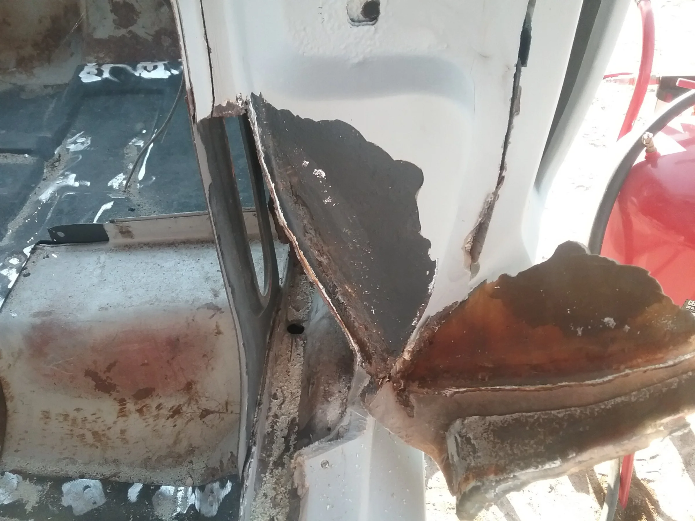

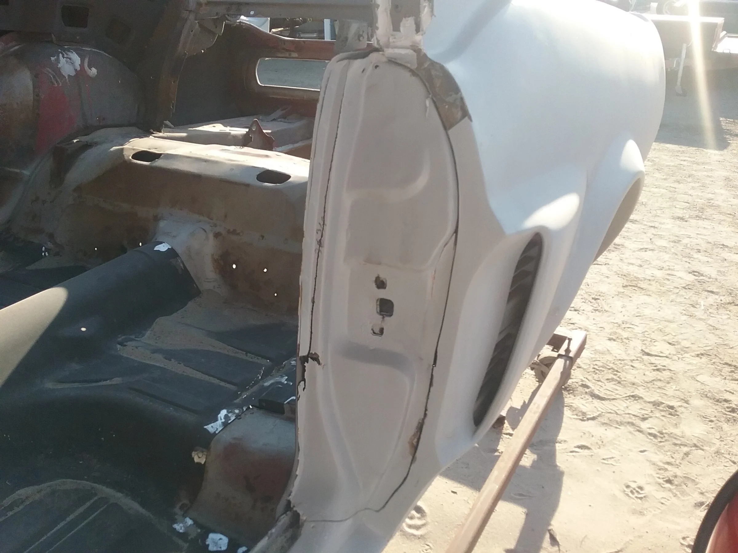

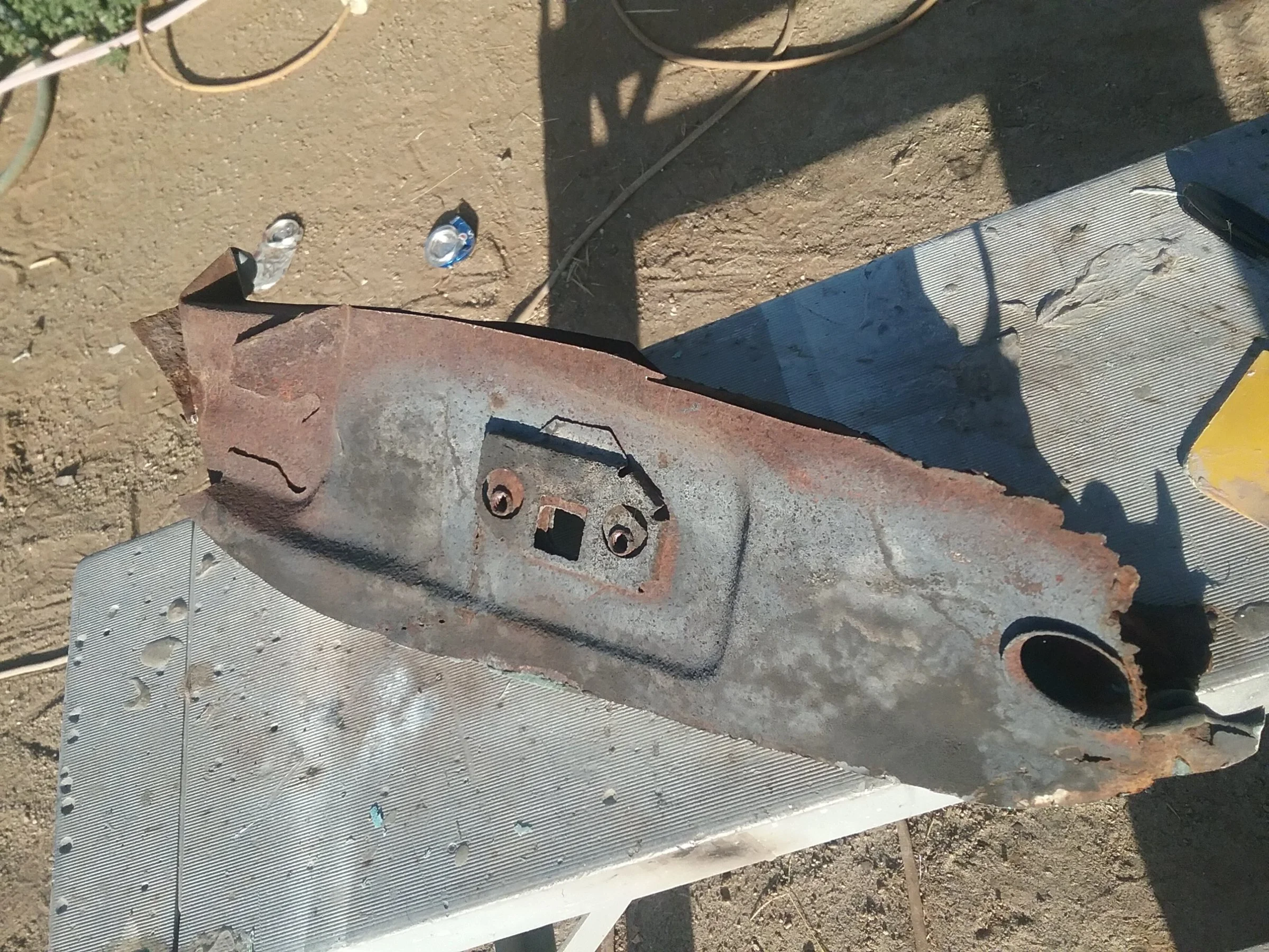

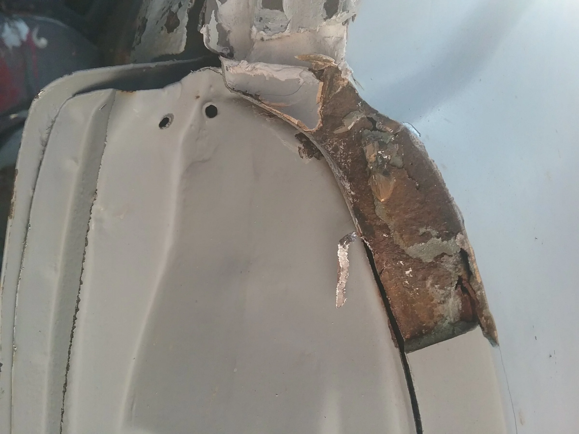

Lately it seems i have had to repair a lot of crappy repair work ...if you can even call it repairs. This was done buy a supposedly high quality repair shop,that i will not mention the name of .
The door post striker area was rusted clear through so, it Was fiberglassed over and packed with tiger hair ,the rust wasnt removed ,just glassed over and filled.
I saw a crack in the door jamb and after i hit it with a rubber hammer the whole thing broke out . Guys ,this type of thing will not work ,the rust has to be removed by either cutting it away or at the least sand blasted ,replacing is way better . Fiberglassing over will not work ,Please dont do like Bobby bondo did on this 67 :doh:
