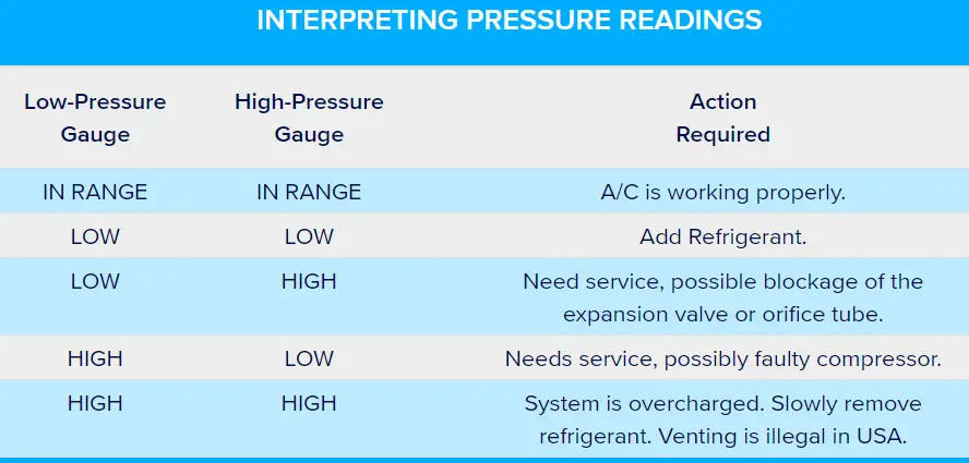

I found this on an a/c pro product website:
631462
631463
If your system is currently empty, put a new dryer on it, vacuum it down and see if it holds. If it holds, charge with the amount listed on the compressor label. Do it by weight. That's a good starting point. Then you can check the pressures after getting it up and running. Do you see where oil has leaked? If so, adding some to compensate might be a good idea.
