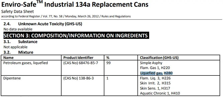

Found this. Do we have any chemistry whizzes in here?
632764
I found safety data that makes me think H280 is propane, H220 is Natural gas, but I'm not sure I'm reading them right. The "Dipentene" is probably the "odor added" that gives someone a clue that this potentially dangerous gas is leaking. The difference in auto-ignition temperature is enough to be worrying in using propane directly.
