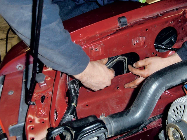

You're confusing the silencer with the air box (or maybe just unfamiliar with the fox body?). The silencer (on a fox) is a completely separate piece that's located entirely inside the fenderwell, directly opposite the airbox - you can't see it from the engine bay. Even without the silencer, the opening for the airbox is sealed against the fenderwell.
The part he's holding in his hand is the air silencer. The airbox still seals against that opening to the fenderwell.
