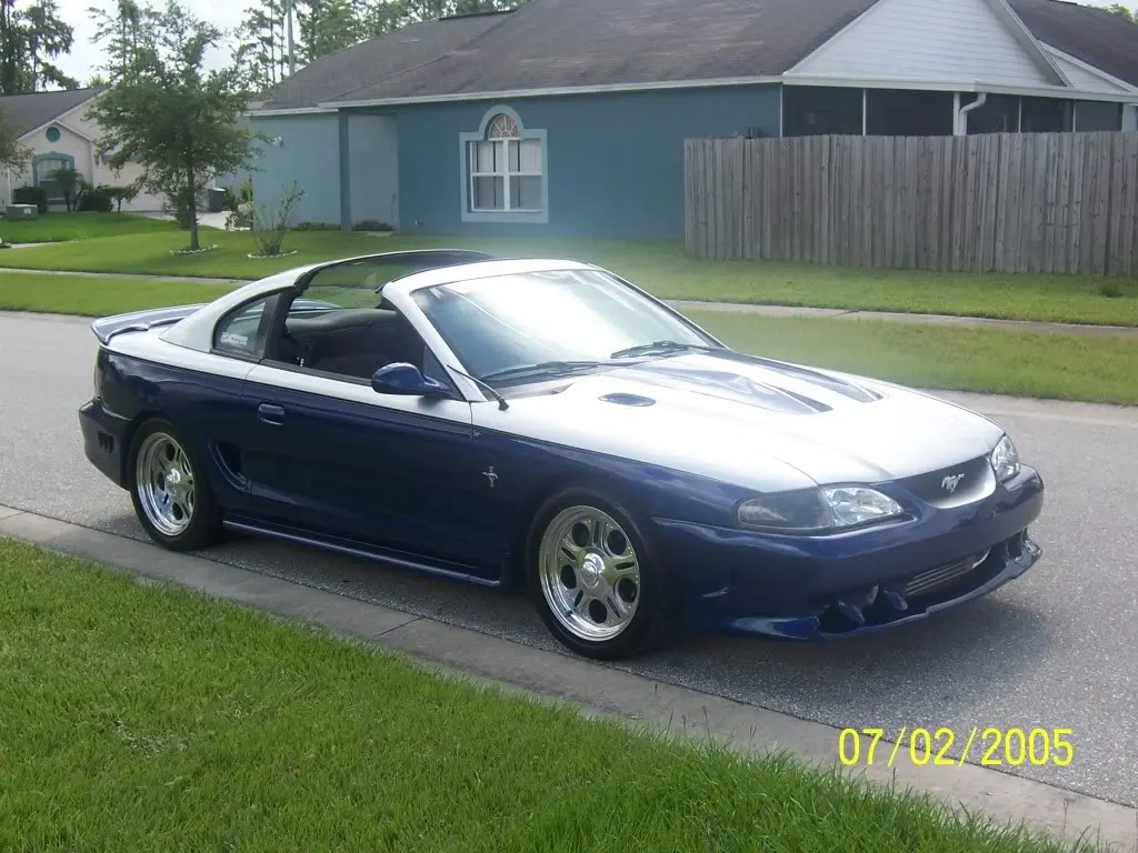

Here is a targa top stang, kit made by JMS, type 2, (it's a partial interior mod) comes with glass roof I believe (I would do it!).

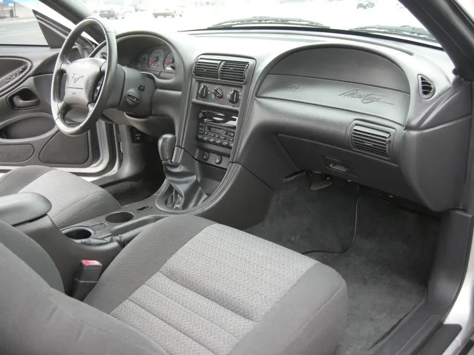

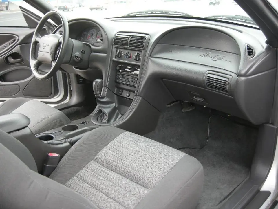

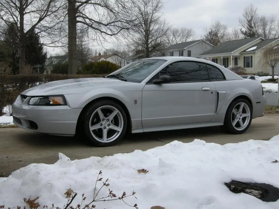

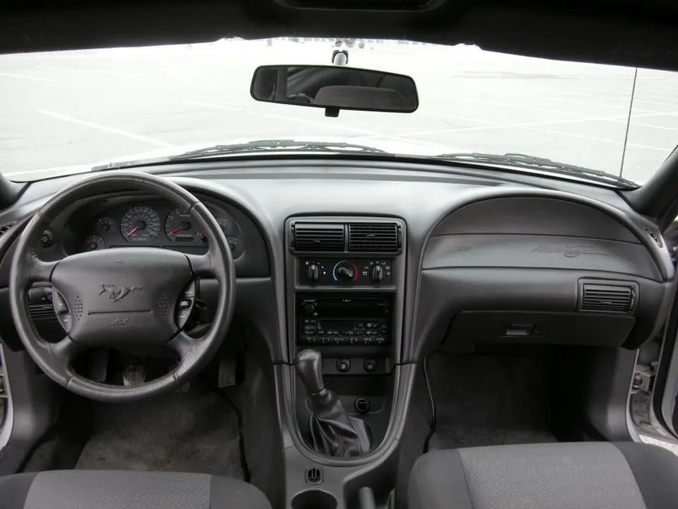

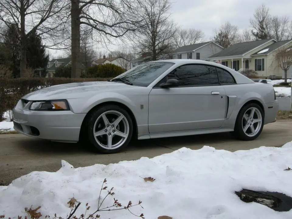

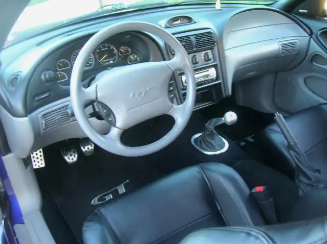

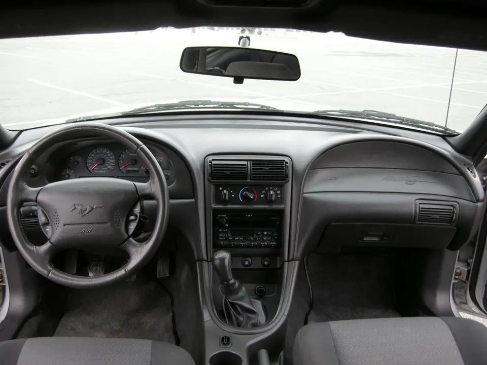

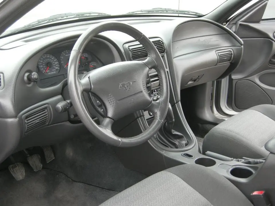

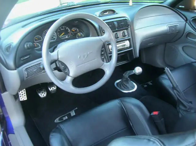

My Dad bought this car brand new and then I bought it from him. Satin silver with charcoal grey cloth interior. He took good care of it and I continued that tradition. It had over 112k on it when I took these.
I loved the interior on that car. I want to eventually convert my Cobra's interior to charcoal grey. I've never really been a fan of the black/saddle, and everyone else always does black when they do a custom interior.

I prefer the charcoal gray, and the peanut butter interior has to go. If your coloring comes out good, I'll follow after, and maybe do the mach 1 seats. God that would look sweet!:D

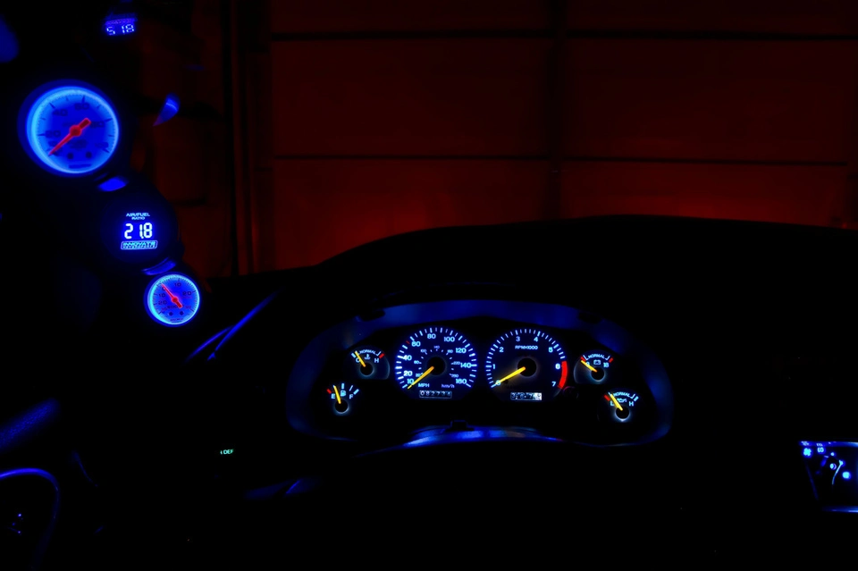

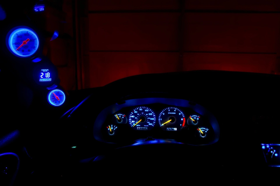

mine isn't too unique yet. did the LED swap, white face gauges, and autometer C2 gauges. have some neons under the dash to illuminate the footwells as well as 2 LEDs in the screw holes of the center console shining down on the shifter. AFM ashtray switch too.

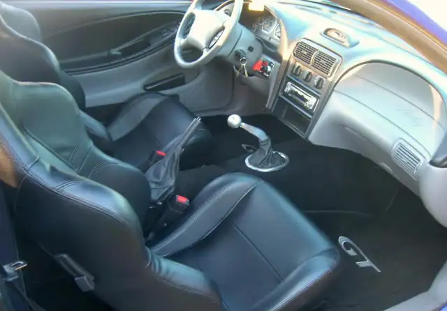

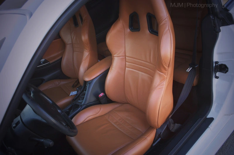

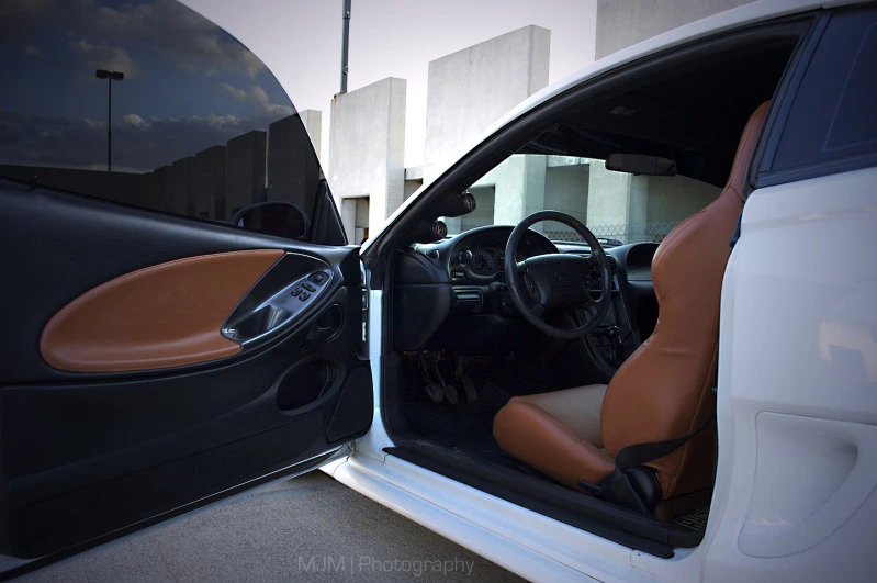

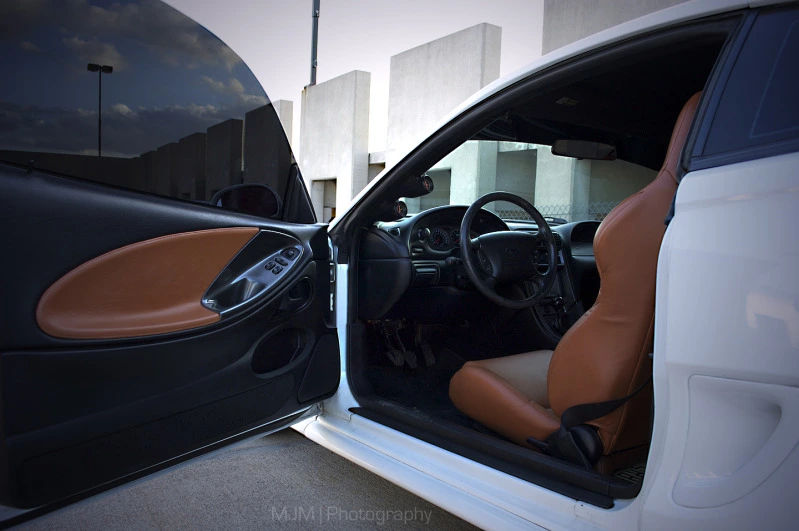

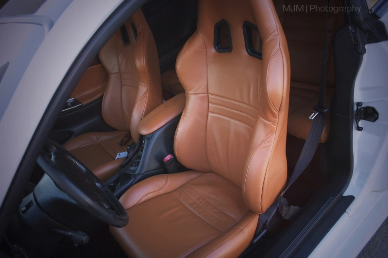

Here's Jonbeat from sn95forum's cinnamon interior he had done:

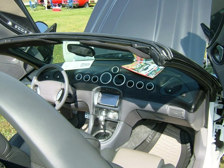

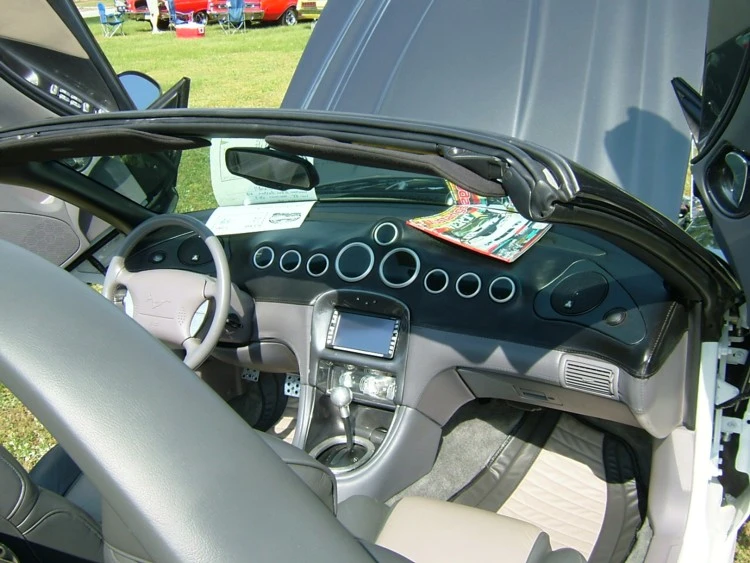

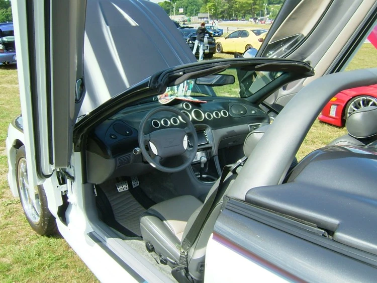

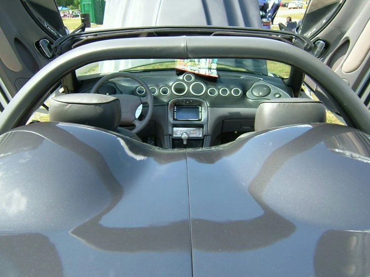

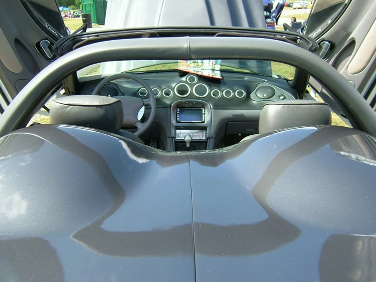

then there is the extreme of onebad95's interior:

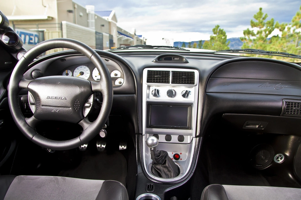

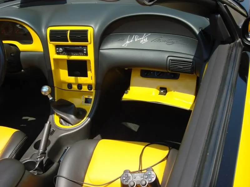

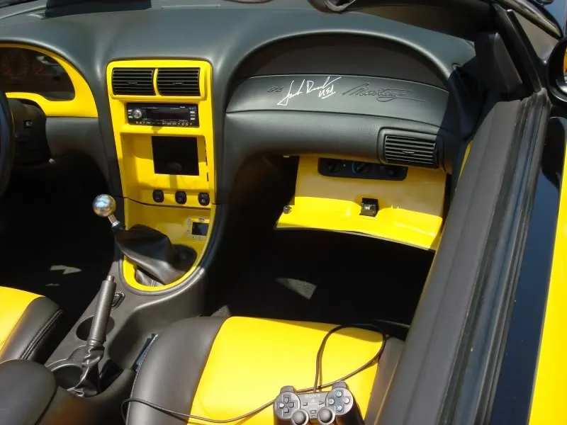

saw this at carlisle couple years back. i'm pretty sure above the shifter is air ride controls:

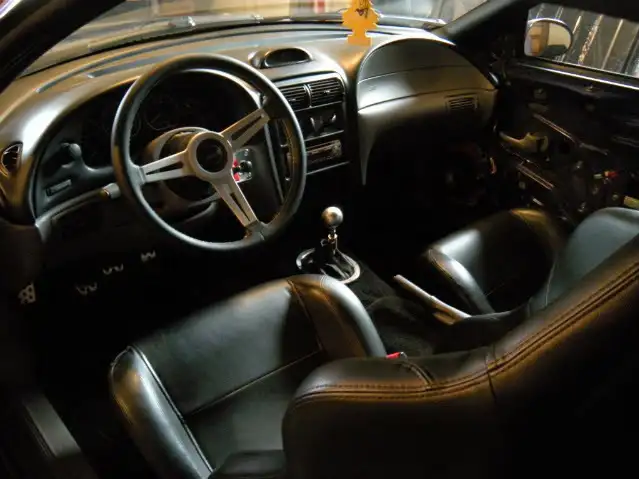

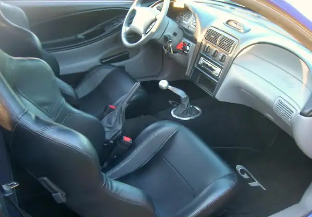

Deleted my console for more of a muscle car feel. Had to trim off the dash level where it normally comes down to meet the center console.
Added a custom push button start to the right of the steering wheel that you can see in this pic.
Added a 3 spoke wheel for more retro feel, but unfortunately had my door skins off in this pic so it doesnt give the completed feel it had.
I was pretty proud of my interior and how different it was from the norm. Every mustang guy that saw it in person always complimented the creativity of it.
Edit: I have to caution anyone that decides this looks cool and wants to go for it. There is a small control module of some sort under the head unit that I relocated (if I remember right it was for the Mach 460 sound, so I pitched it completely). There is also some bracing for the dash I cut away and welded two small pieces of round bar in to support the dash. Without this the whole dash shimmies, and the steering wheel bounces when you hit bumps. It wasnt just as easy as pulling out the console and slapping in new carpet.
I've done the LED swap too and the HVAC, been considering the neon strips but I haven't decided if it would look tacky or cool. It depends I guess.
What do you use your AFM ashtray for?
And onebad95's interior is a little toooo much for me. The rear seat delete, only two seater idea is neat though. and the dash speakers.
I've seen the console delete in foxbodies and it looks great. I never thought it would look good in our cars, but you proved me wrong. It looks gorgeous, and yeah that is the 3rd amp for the stereo system underneath there.
I aspire to have this clean of a car:D
Your steering wheel is pretty cool too, probably cut a few pounds off our huge wheels. Really looks nice with the floor shifter.

right now i'm only using two of the switches. top is for the manual fan, 2nd is for the neons. the other two will be for the methonal injection whenever i get around to doing it.

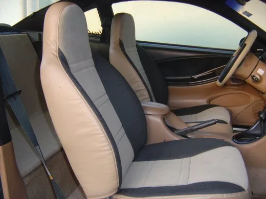

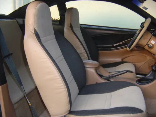

Retrimmed front seats from a junkyard 2001 Jeep Cherokee (modified seat bases to accept stock seat tracks):

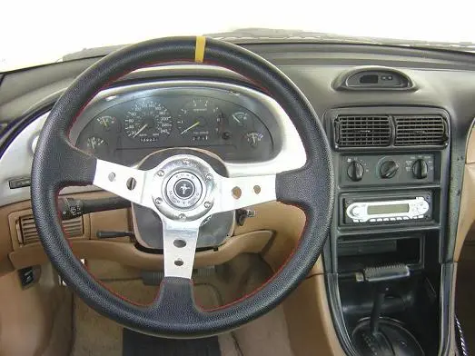

El cheapo aftermarket steering wheel for retro look:

I've seen people swap out different seats a few times before, for a sportier look and wait reduction. Great find:p[/quote]
Thanks. Those Cherokee seats are very comfortable on long drives, have much better lateral support for hard cornering, AND have a combined weight of 24lb less than the stock Mustang seats. The manual seat track conversion to the driver's seat shaved off a further 6lb.
The rear seat delete saved 30lb, the lighter steering wheel (no airbag) saved 5lb, and removing the knee bolster reinforcement plate saved 2lb so my total weight reduction just from interior mods alone was 67lb.

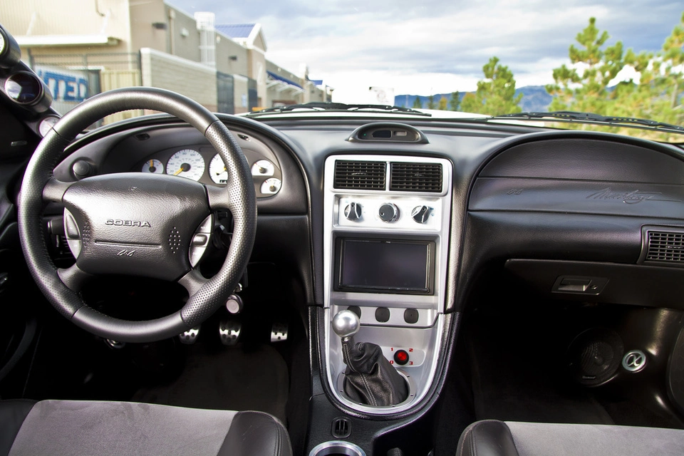

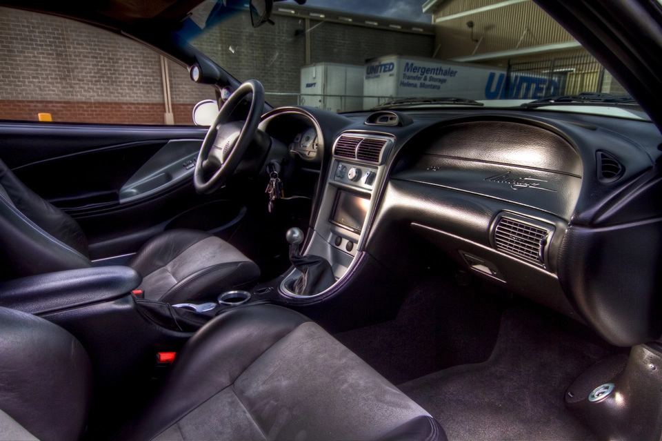

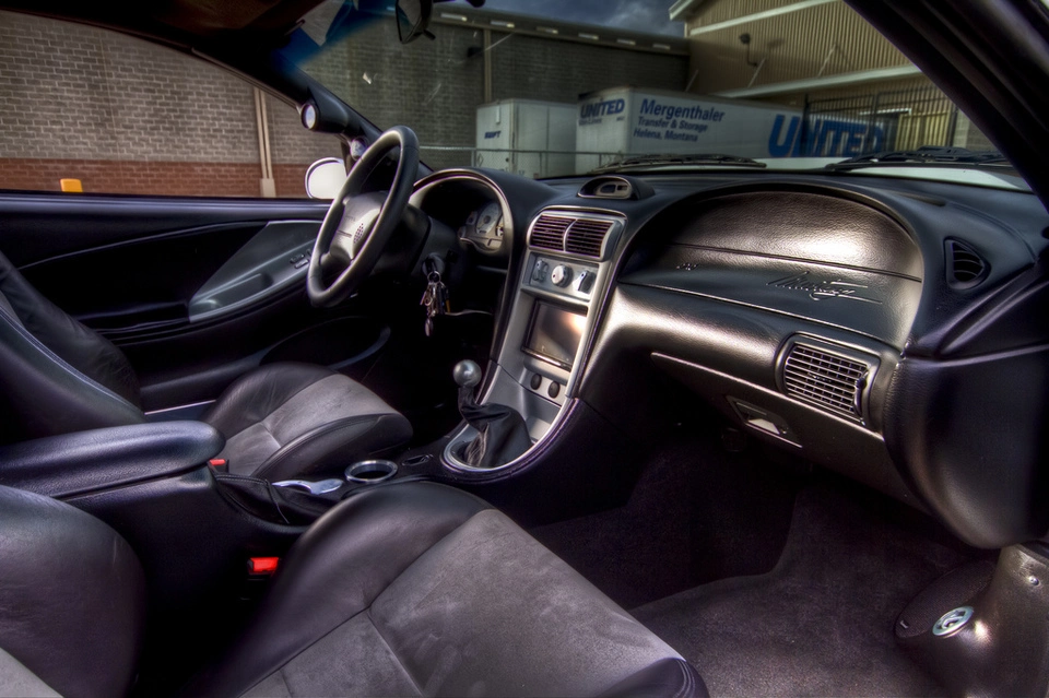

There is a ton of money in my interior.. I prefer factory looking stuff for the most part.. When someone sits in my car, they have no idea nothing is original, but if you sit in a regular SN95, you realize there's a huge difference..
And NOTHING beats an FR500 wheel.. I won't own a mustang without one..
back seat by MattWhidden, on Flickr
gauges_1 by MattWhidden, on Flickr
passengers shot by MattWhidden, on Flickr

Nothing wrong with a good fr-500 steering wheel. It's sweet lookin, are those the same diameter as stock?
For the most part I usually hate painted bezels because they stick out too much in an unfactory or weird way, your silver panels came out great though!
And I love that custom housing for the speakers on the floor/wall by the feet. That's what I'm talking about. Neat work turbogt.
