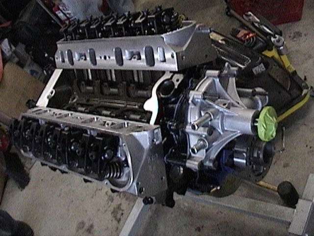

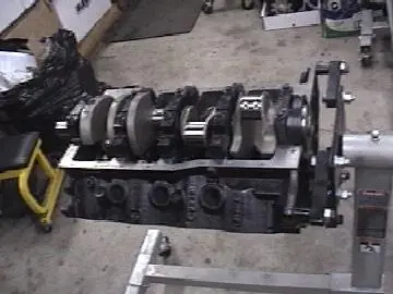

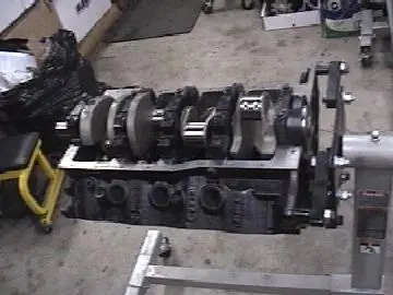

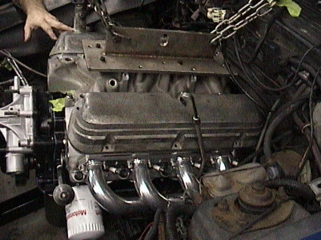

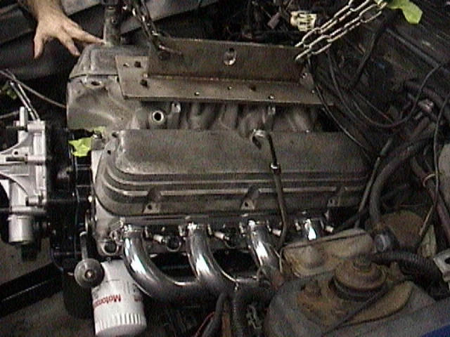

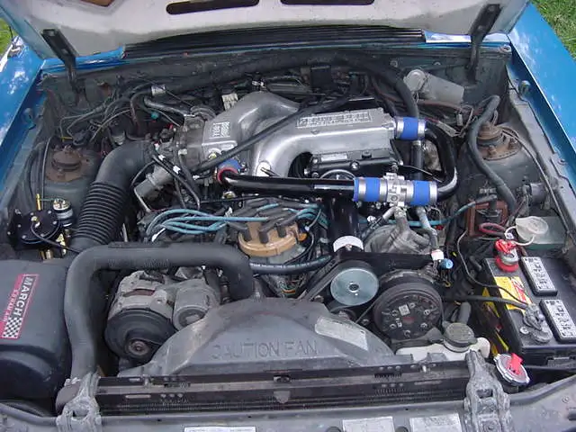

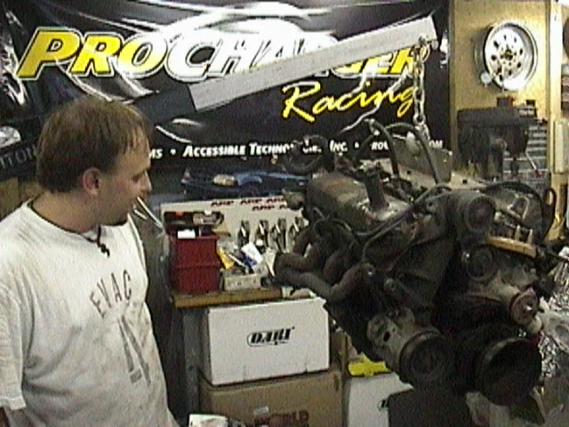

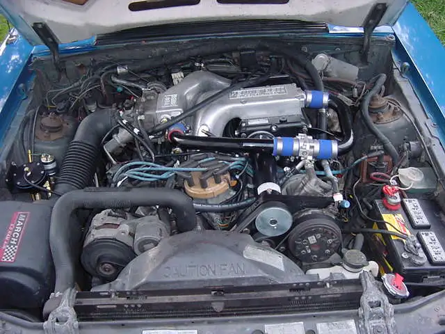

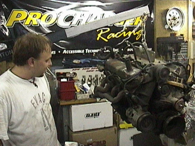

Anyway, I figured I could go ahead and post what I've got pictures of so far. Rick has some more pictures that I still have to get from him but these are good enough to give you an idea of what's going on. The first pic of course, if of the old motor. The old motor was just some basic bolt ons and the KB. Made great power for what it was but like everyone else on this forum... That just won't do. hehehe
So here it is...
Rick91 GT looking at the old motor and trying to figure out how it ran as well as it did. lol

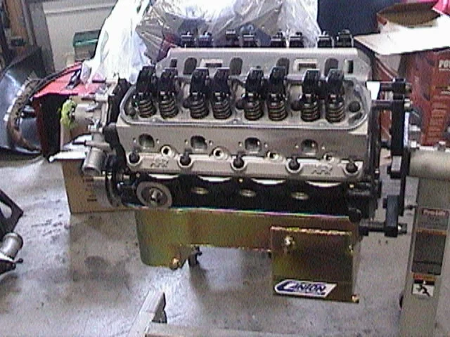

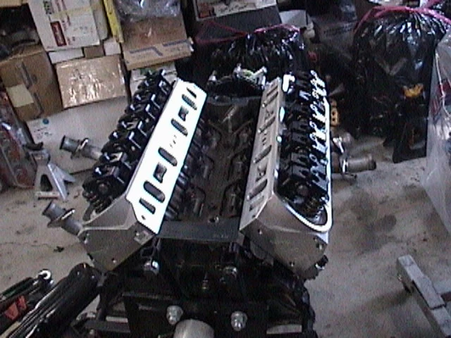

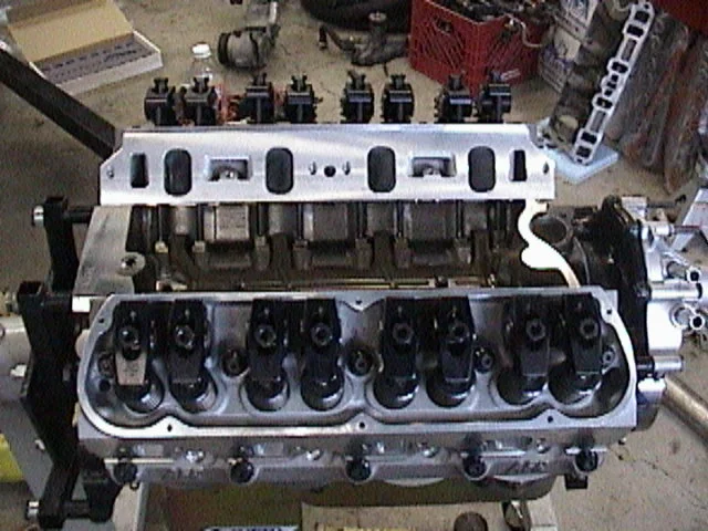

DART FTW!!!
Ed Curtis custom. To my knowledge, there are only two of this particular grind in existence.

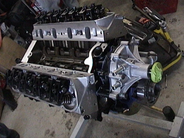

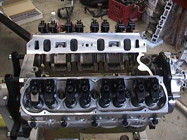

Rick91 GT setting the ring gap (better him than me)

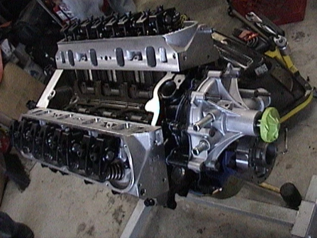

Mmmmmmmmmmmmmmmmmmmmmmmmmmmmmmmm! Looks like JEWELRY!!!!

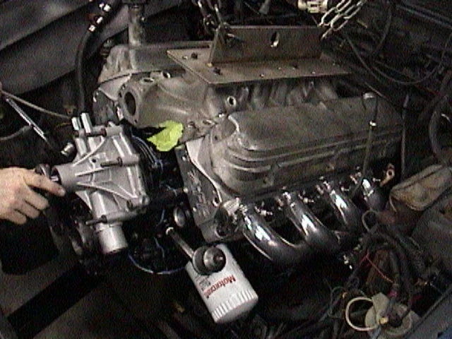

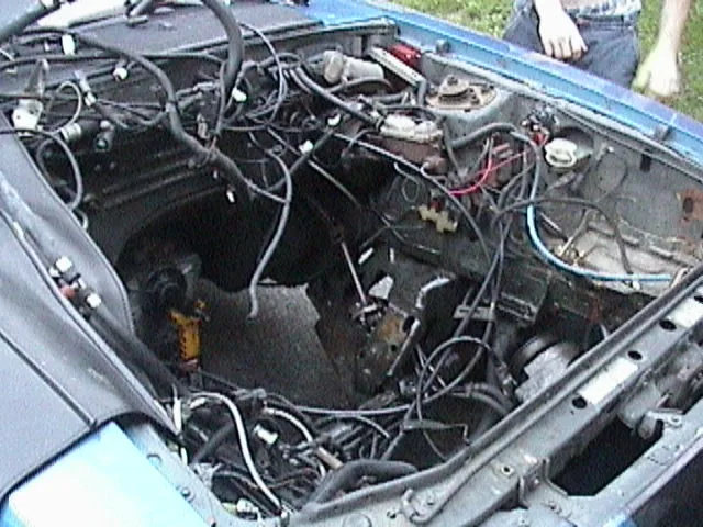

Random Combo Pics

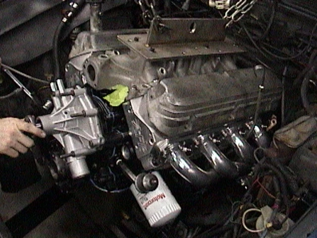

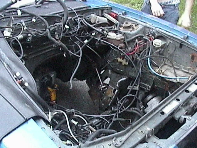

Initial fitting to the car. Hmmm... I wonder if it'll all bolt up?

Before anyone says anything... YES! I'm going to replace the valve covers! LOL They've been painted black since these pics but what I want is a set of stock style covers that have been dipped in chrome. I just really like the shape of the stock style covers.

The pics were taken at Rick 91GT's place. The video was done in my garage here jsut a few nights ago in response to someone asking for a sound clip.

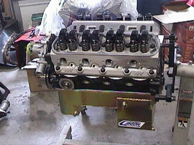

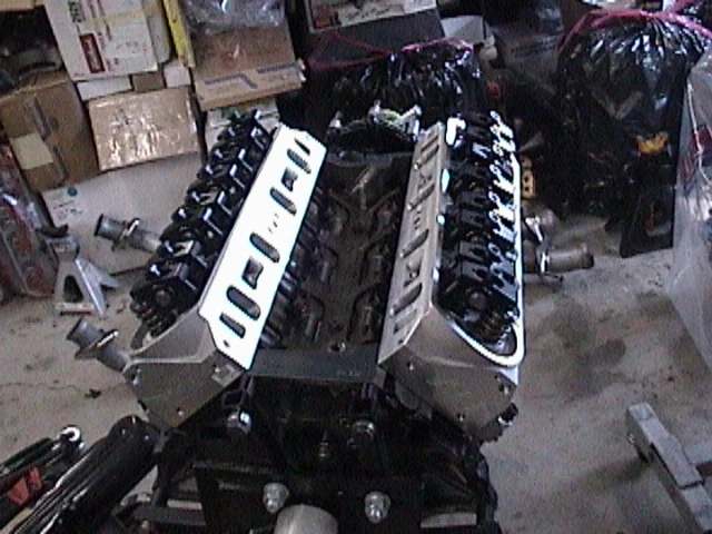

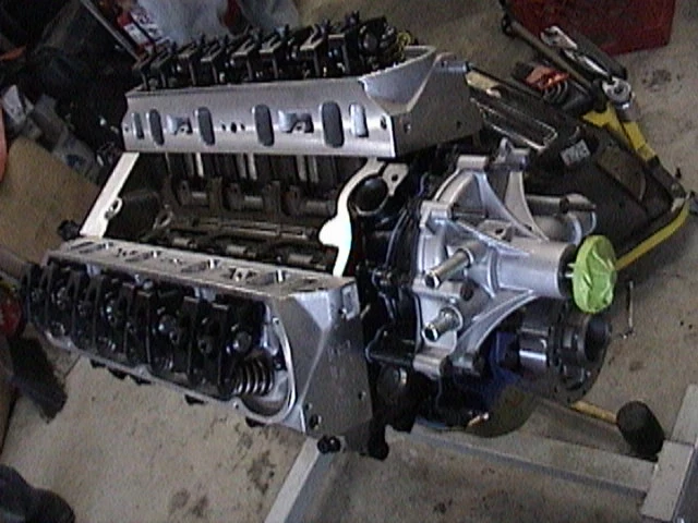

The heads are AFR185s. I'd considered doing the 205s but also wanted to remain backward compatible with emissions. After talking with Rick and he conversing with Ed Curtis, I decided that the 185s would be my best bet.
All forged internals, zero balanced, 327 Stroker. ARP throughout and studs where they could be applied. RR are 1.6 ration Trickflows. Springs are upgraded from what comes with the heads in order to deal with the Kenne Bell. Hardened pushrods, deep oil pan... Am I forgetting anything important?
Oh... Billet STEEL flywheel. I know I know... Rick wanted to go aluminu too but teh steel has the charactersistics I was looking for in a DD and I also didn't want ot have to install a scattershield.

pistonhead351 said:
looks awesome! but im just curious, will you have to use epoxy on the lower intake to get it to match up to the oval head ports? or will they be gasket matching the heads?
I'm not sure what you're talking about. The ports on the heads are a near perfect match for a set of Felpro 1250's. They also match up very nicely to my lower intake.
pistonhead351 said:
hmm, intresting jw. as most sbf heads are not that oval but have more of a rectangle shape. nm, how much hp are you projecting?
I'm anticipating 500+ to the wheels.

srothfuss said:
Hum... KB + dart based SBF = Torque box reinforcments needed
Roger that! I've got a set in the garage that I also got from Rick.
Needless to say, I still have a lot of work ahead of me to make things "right".
5 Lug, 4 wheel disk is also in the works along with a stiffer rear suspension.
