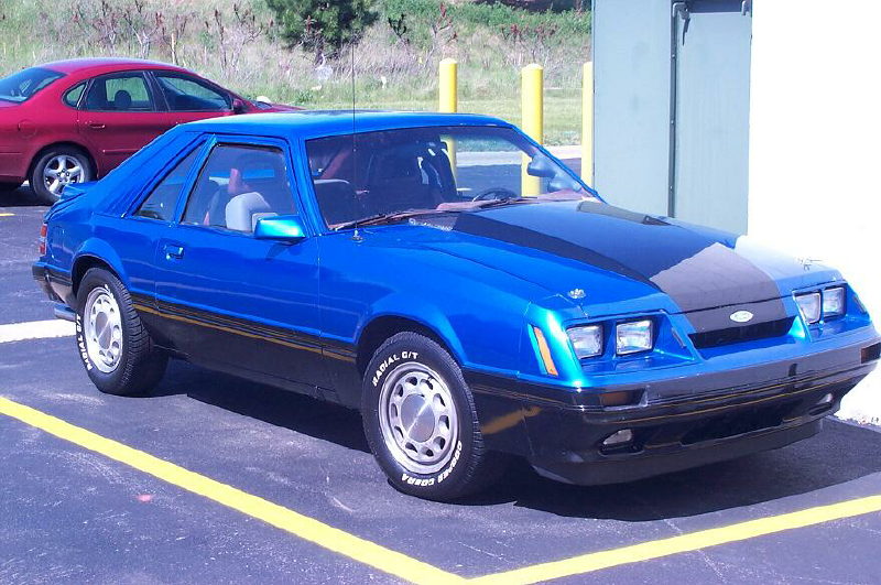

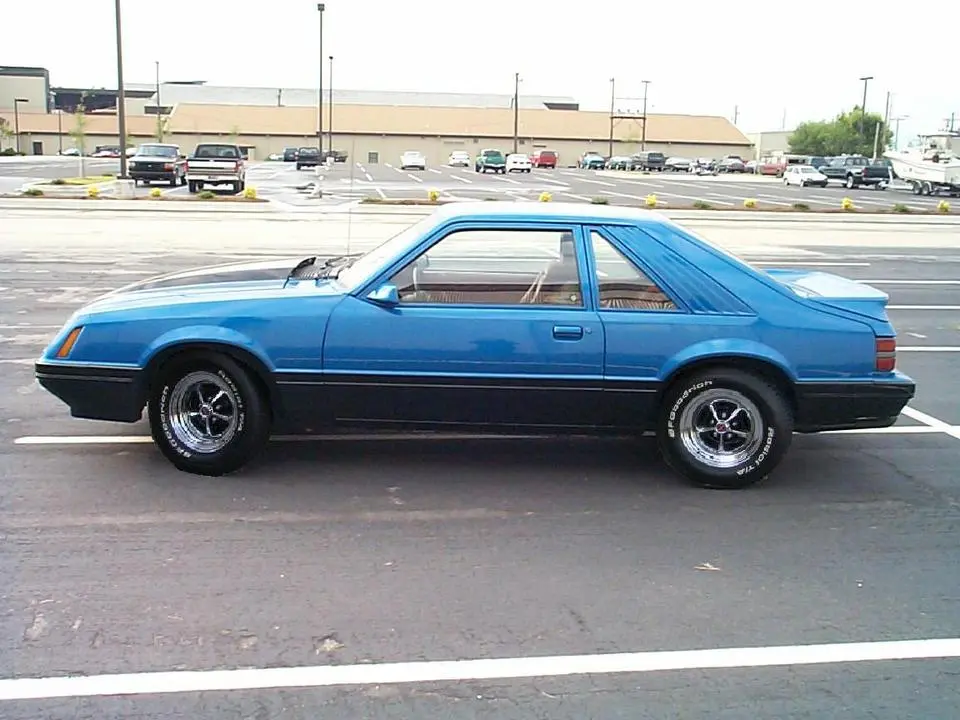

The old school muscle car look the Magnums give to my car, gives me wood. hehe
I'd thought about the smoothies before. They'd also look really good. They're old school looking too. I'd def go with the 17s though. I think he's got 21s on the pic above. LOL
