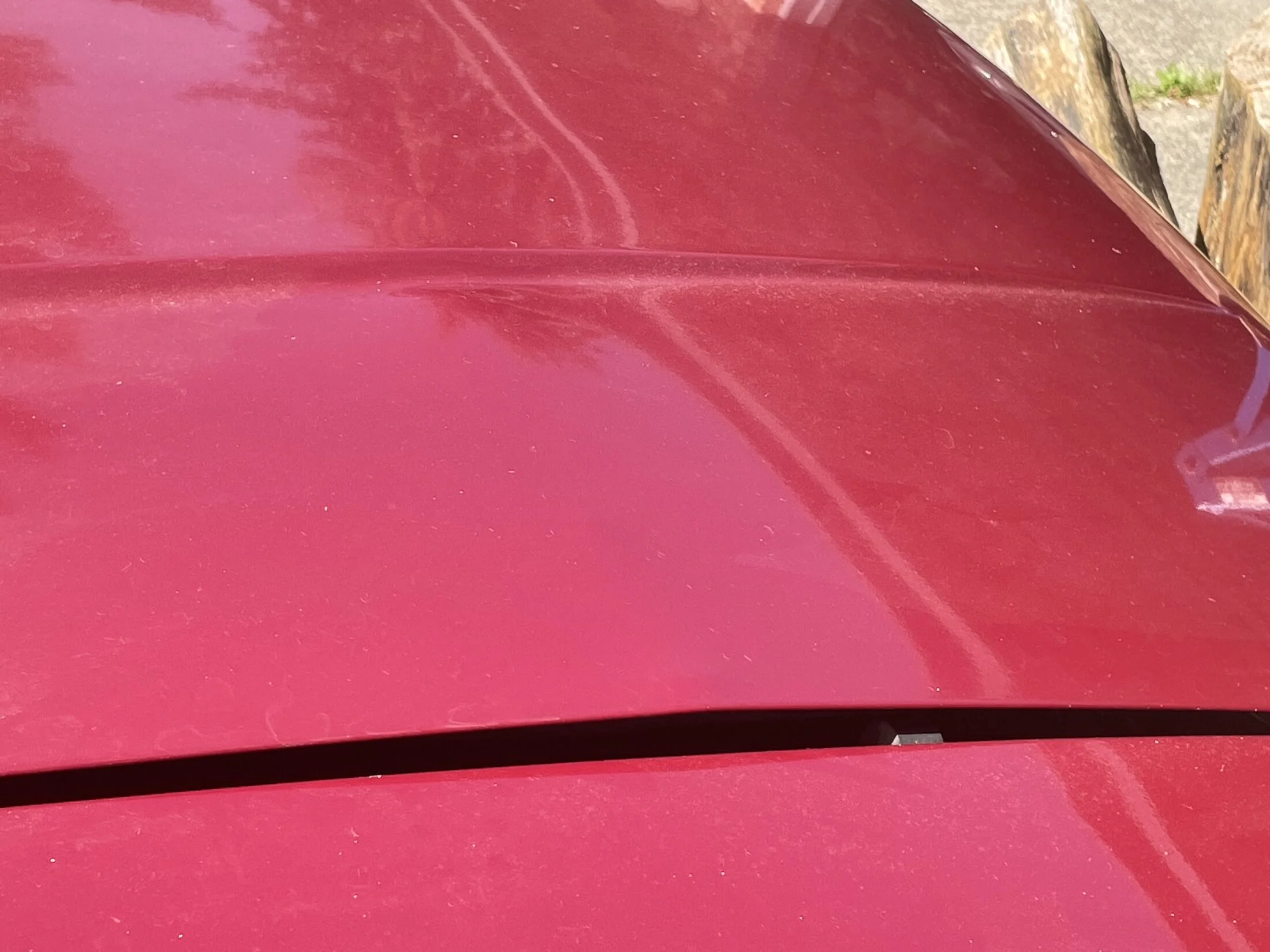

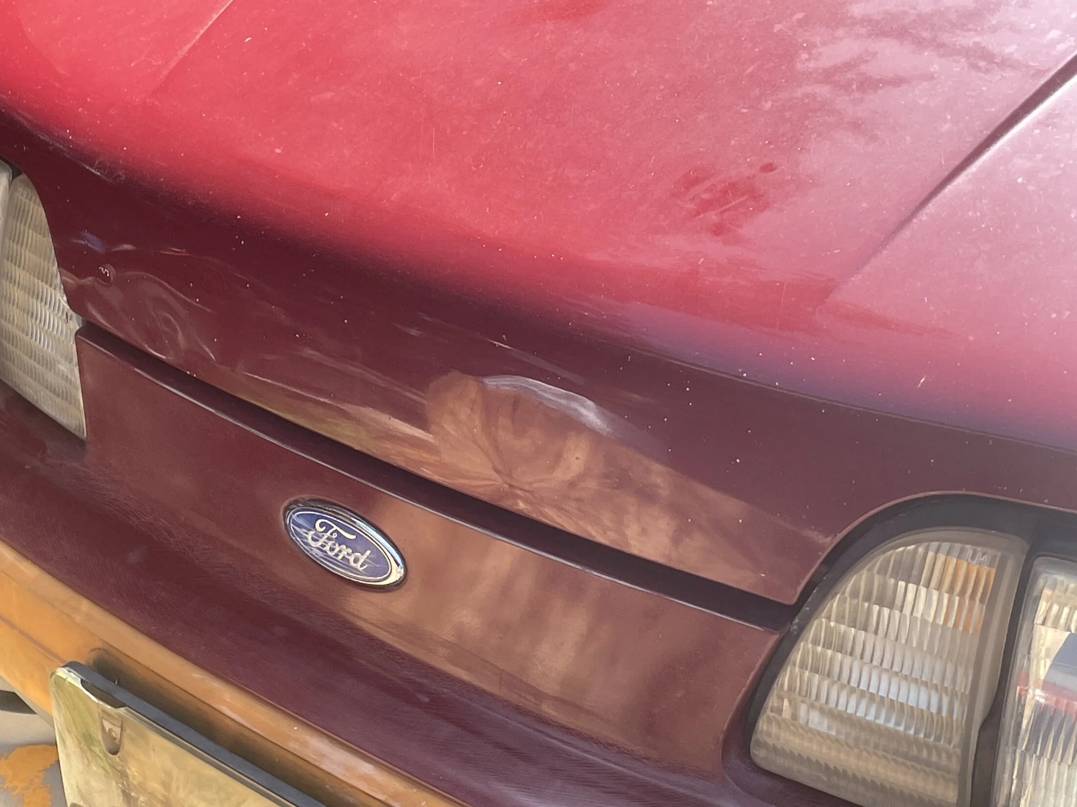

Been a while since my last update. I was driving the car pretty much daily till Memorial weekend. That Saturday, I wanted take the wife's F150 to my mom's to do yard work and haul some stuff. Her Vert was out of gas so she took the 89. Well she ended up rear ending someone with it. The hood took the impact, right on the nose. Front bumper, fenders, header panel are not damaged. However, the radiator support is pushed back where the latch is a tad. By my rough measurements it is a little less than a 1/4". A bummer to say the least. The insurance paid to get the car fixed, so that is good. Here are some pics. As you can see the hood is kinked.

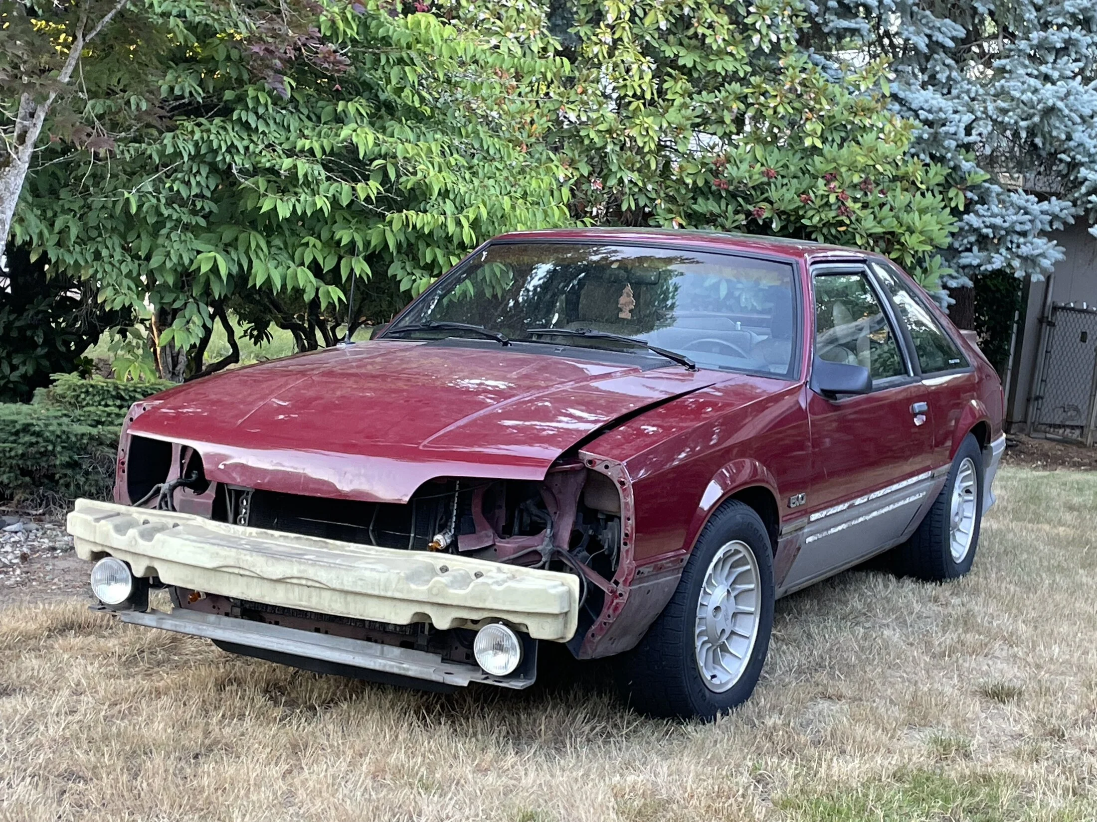

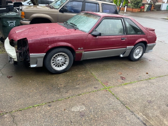

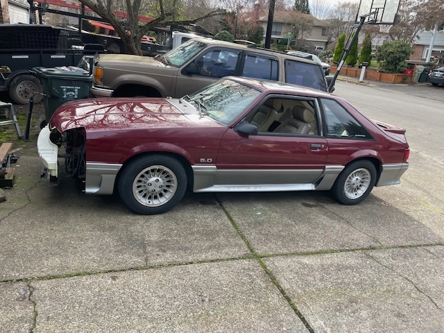

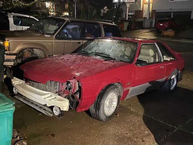

So my body guy of 30+ years retired about 5 years ago. It took me a while to find someone that wanted to work on the 89. Seems like nobody wants to work on older cars anymore. I ended up going to a mustang show a few weeks ago and there was a guy that had a booth. He worked on some of the club members rides so I went to see him. Since he is going to refinish the front bumper I decided to have him repaint the rest of the ground effects at the same time so all the titanium matches. So the last couple weekends I have been removing the bumpers and ground effects. Looks kind of naked now. I still have to take off the passenger side door molding and clean up some of the skirts.

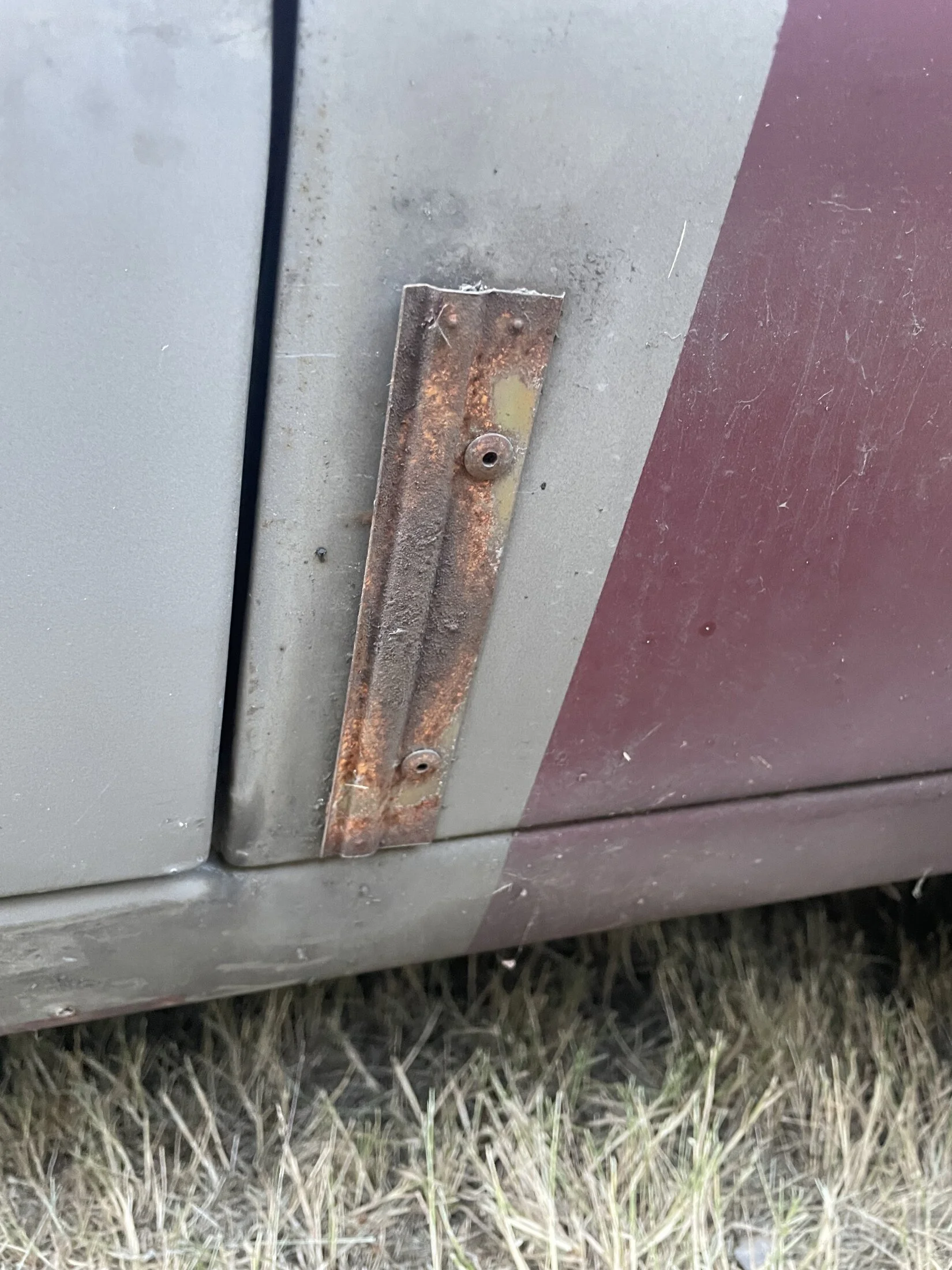

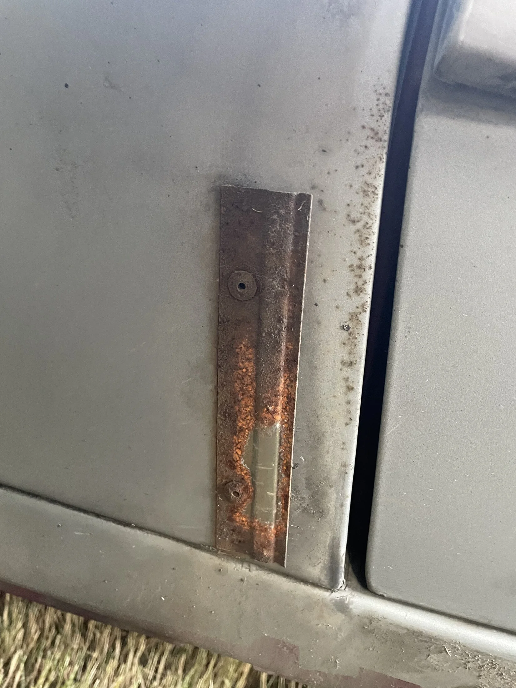

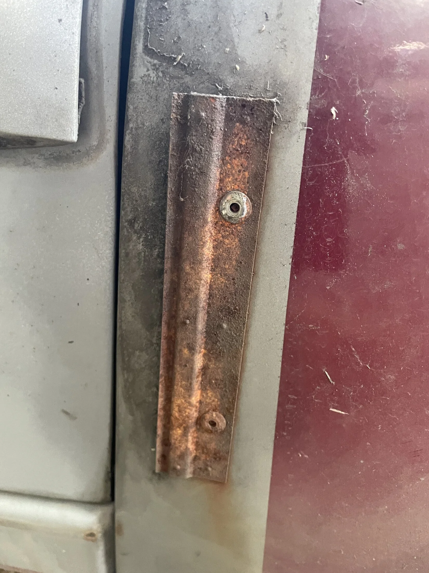

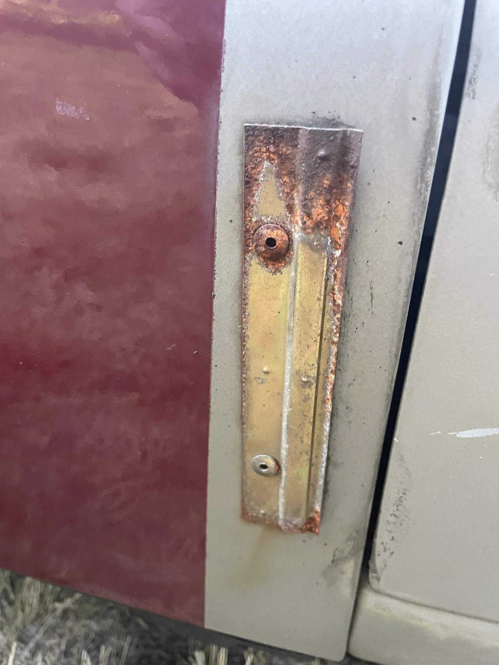

Second is on the ground effect brackets. Some of them are rusting slightly. They still seem solid. Should I replace them or just treat them?

I would pull the brackets off and have them nickel plated. You could anodize them but my guess is that finish will scrape off when you reinstall the effects.

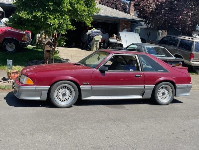

After lots of hours, working in the evenings, I got the car all back together and aligned early last week so we could go to the show this past weekend. Car is about 1.25" lower now

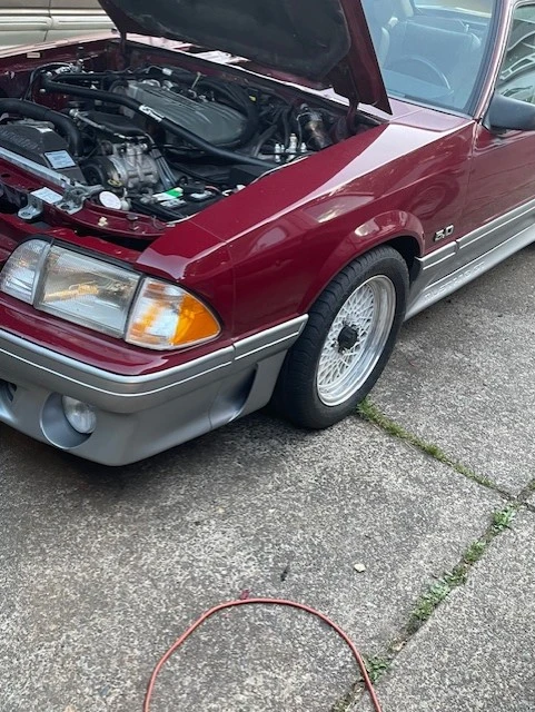

Here are a couple pics from the show last weekend. The wife was nice enough to wax both cars :D

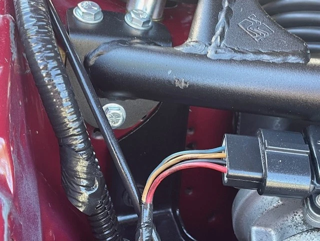

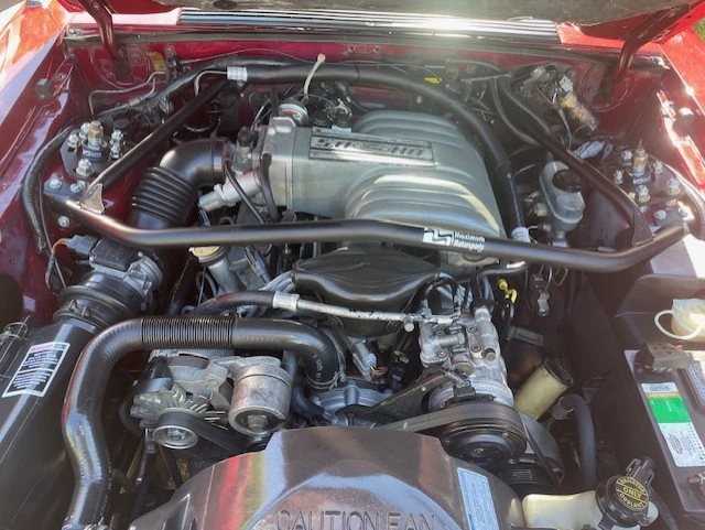

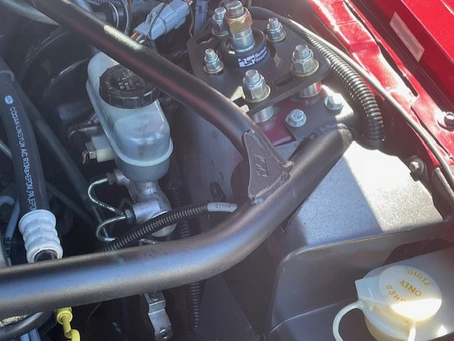

Here are a couple pics of the engine compartment. I had to modify the coil cover and the MAF bracket, The coil cover is JY one I picked up a while back so I could save the original one from being modified.
