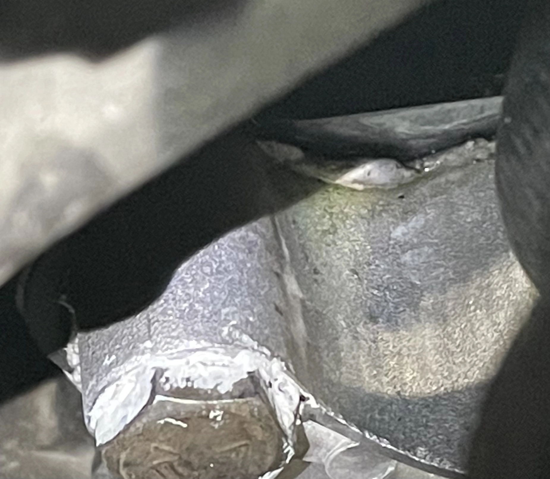

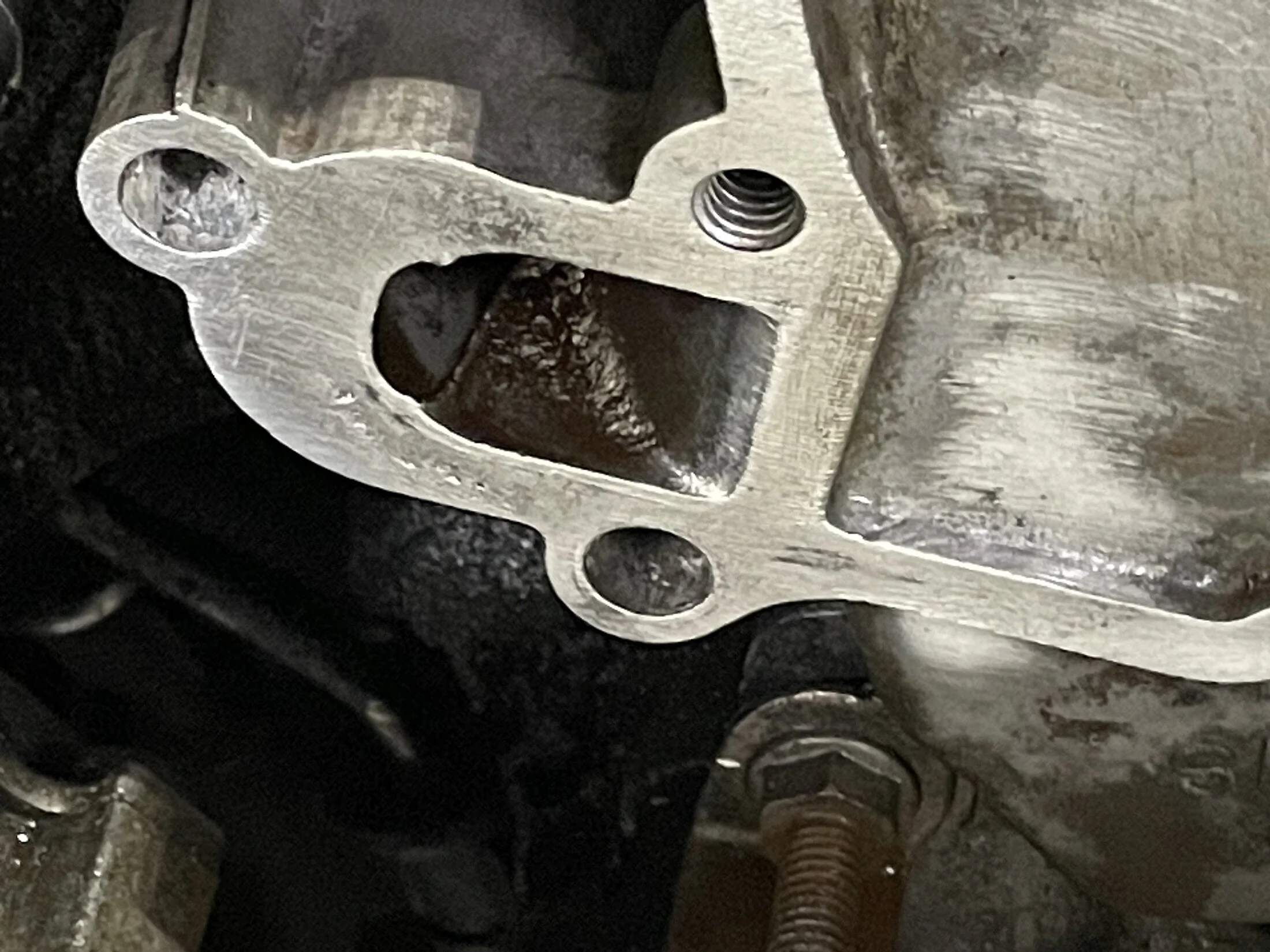

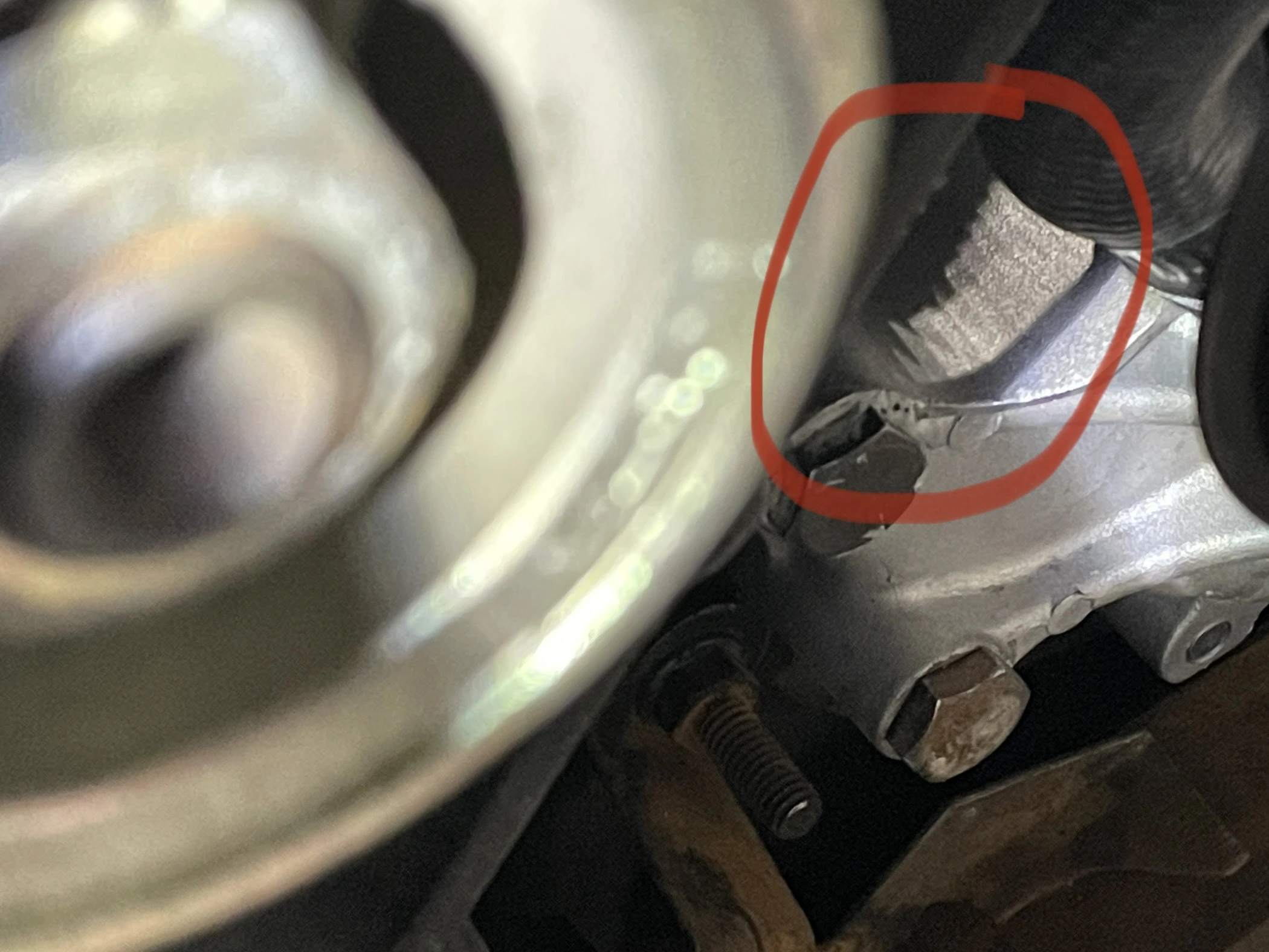

Got home late from work tonight. After I ate I went out and swapped cars around and put the 89 in the garage. I took off the belt, fan clutch, ac bracket, and shroud. Then I put my pressure tester on. 5psi didn’t do anything. Bumped it up to 10 psi and it started leaking from here.

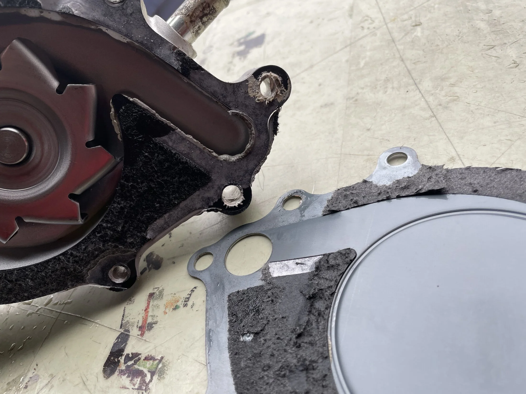

This is the same spot I saw pool up before. It leaking from between the pump and the rear plate. I drained the coolant and pulled the pump off and notice there is no gasket here.
My theory is that because there is no gasket in that section it allows the rear plate to defect when the pressure builds up. Looks like the felpro gasket has that piece. That is as far as I got tonight. I will clean the timing cover off in the morning and see what that looks like.

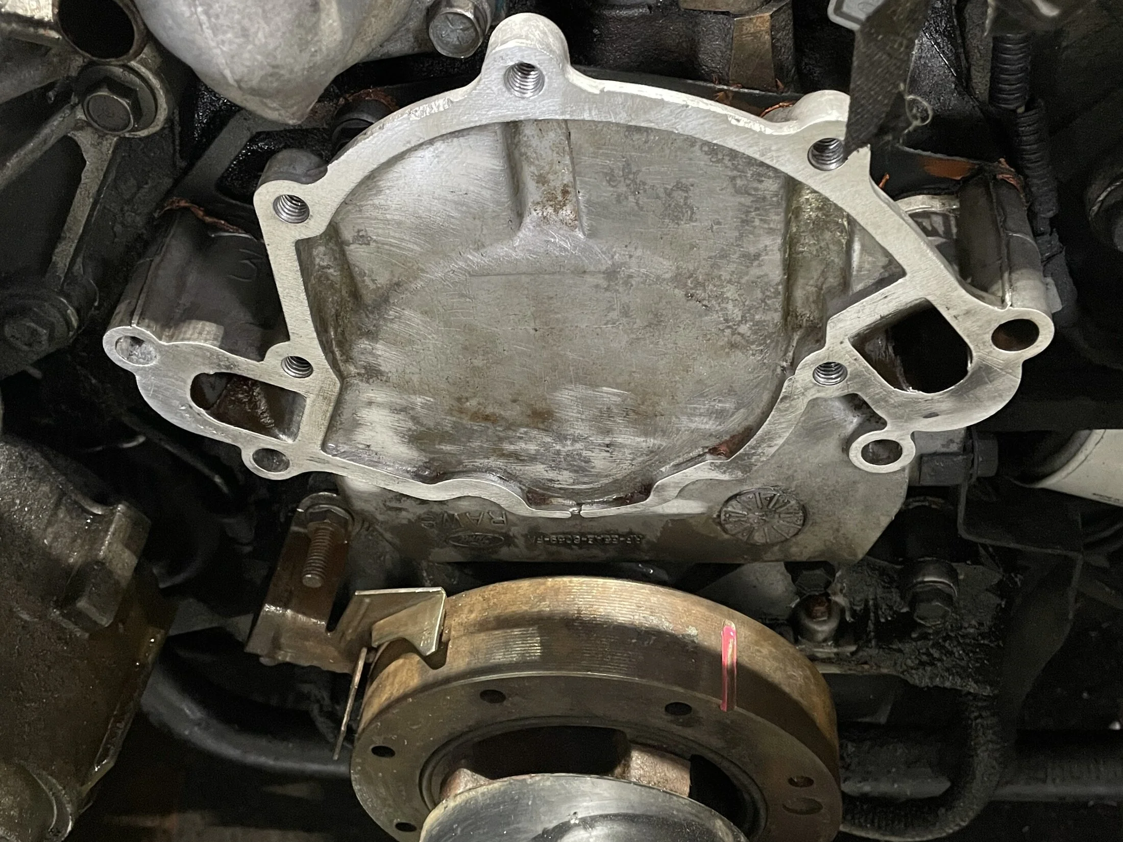

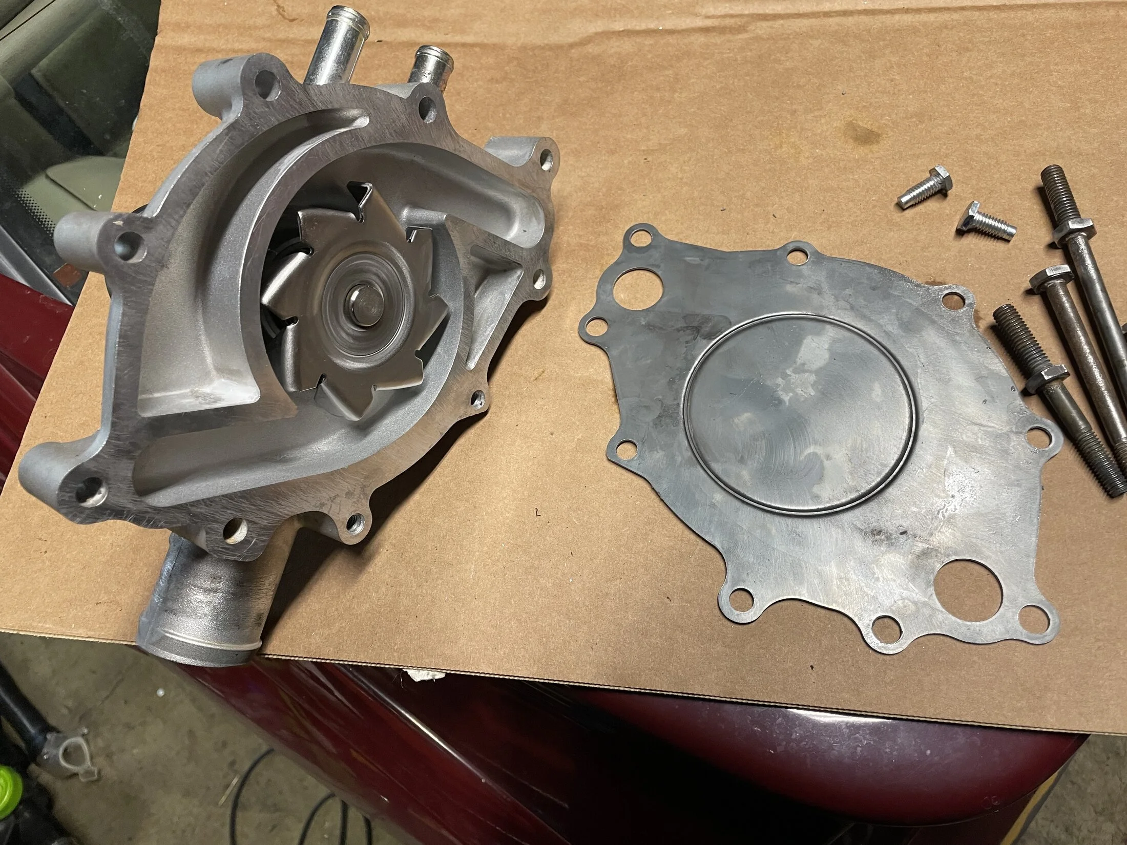

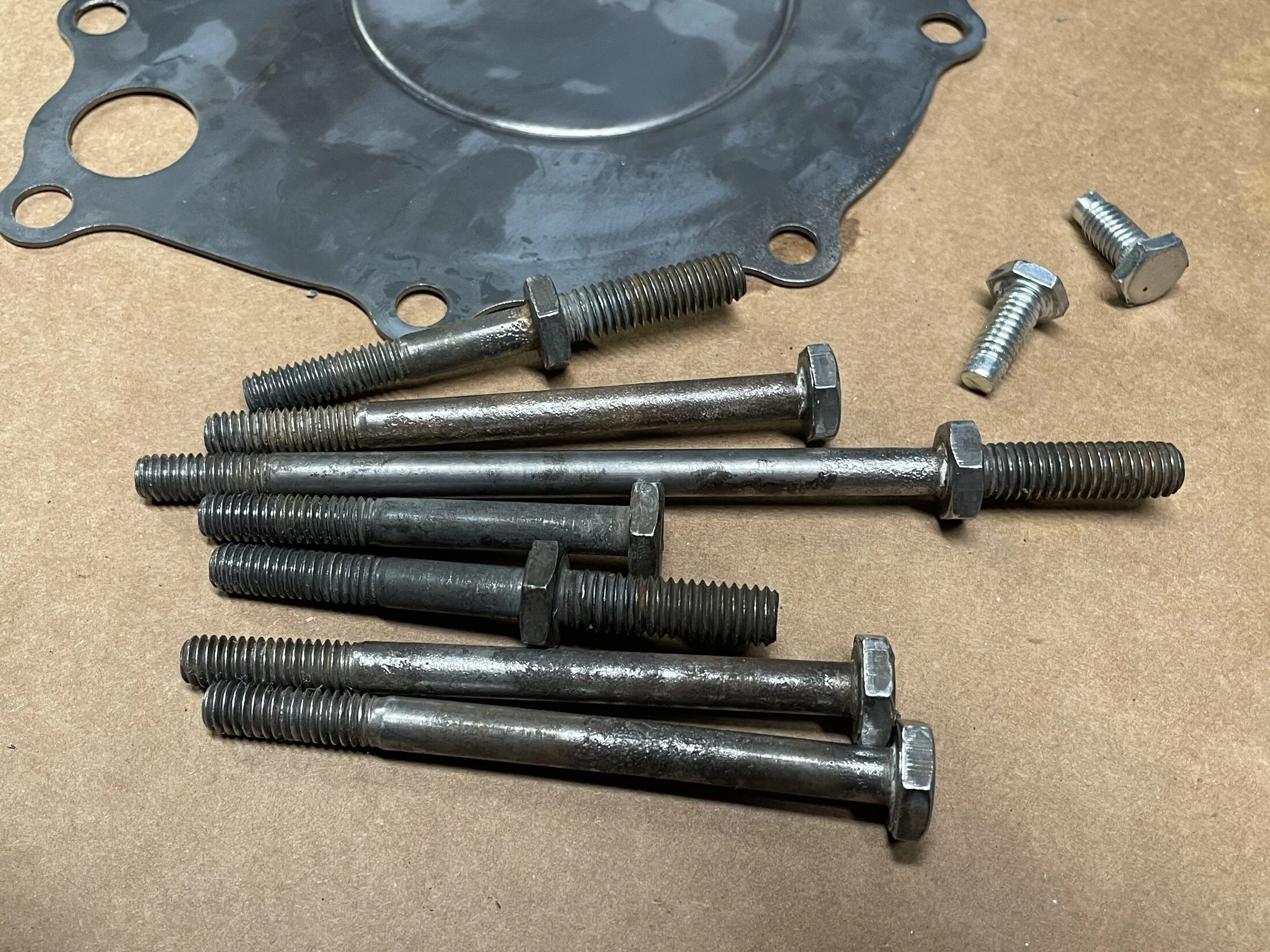

As usual thank you for the input:nice: yes it is one of the four long bolts. I used a ton of the permatex thread sealant on the long bolts. I replaced the water pump about a month and a half ago. It is probably got 800-1000 miles on it. I just did a bunch of cleaning today. Cleaned the bolt, water pump, timing cover and chased and tapped all the threads. Bolt show a little bit of wear but the threads are good. Timing cover looks ok. A little pitting in one area but I don’t think it is too bad? Nothing seems warped except for the rear cover to the pump maybe? I used a straightedge all around and didn’t see anything alarming on the timing cover or the pump itself. This about all I had time for today.

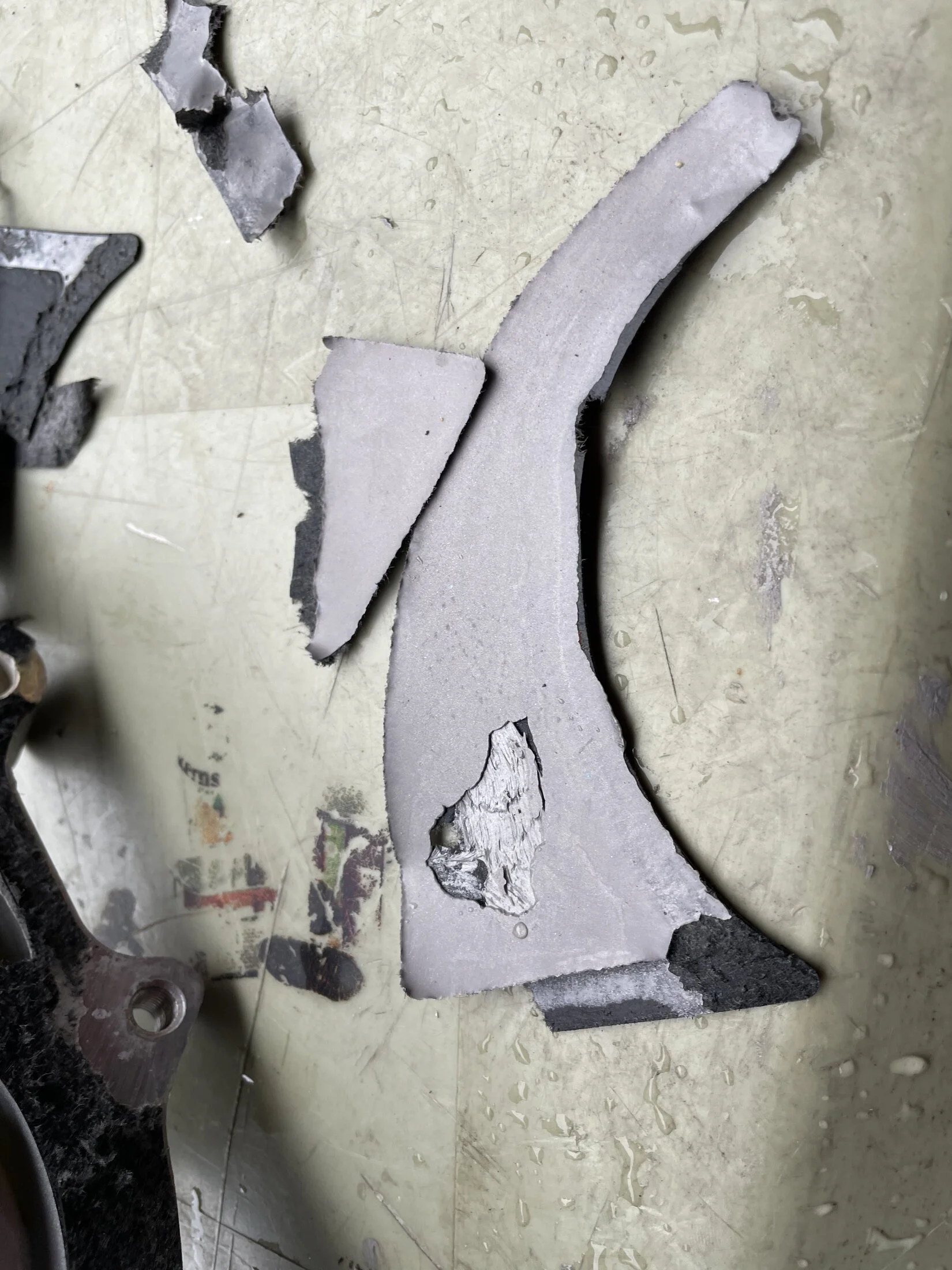

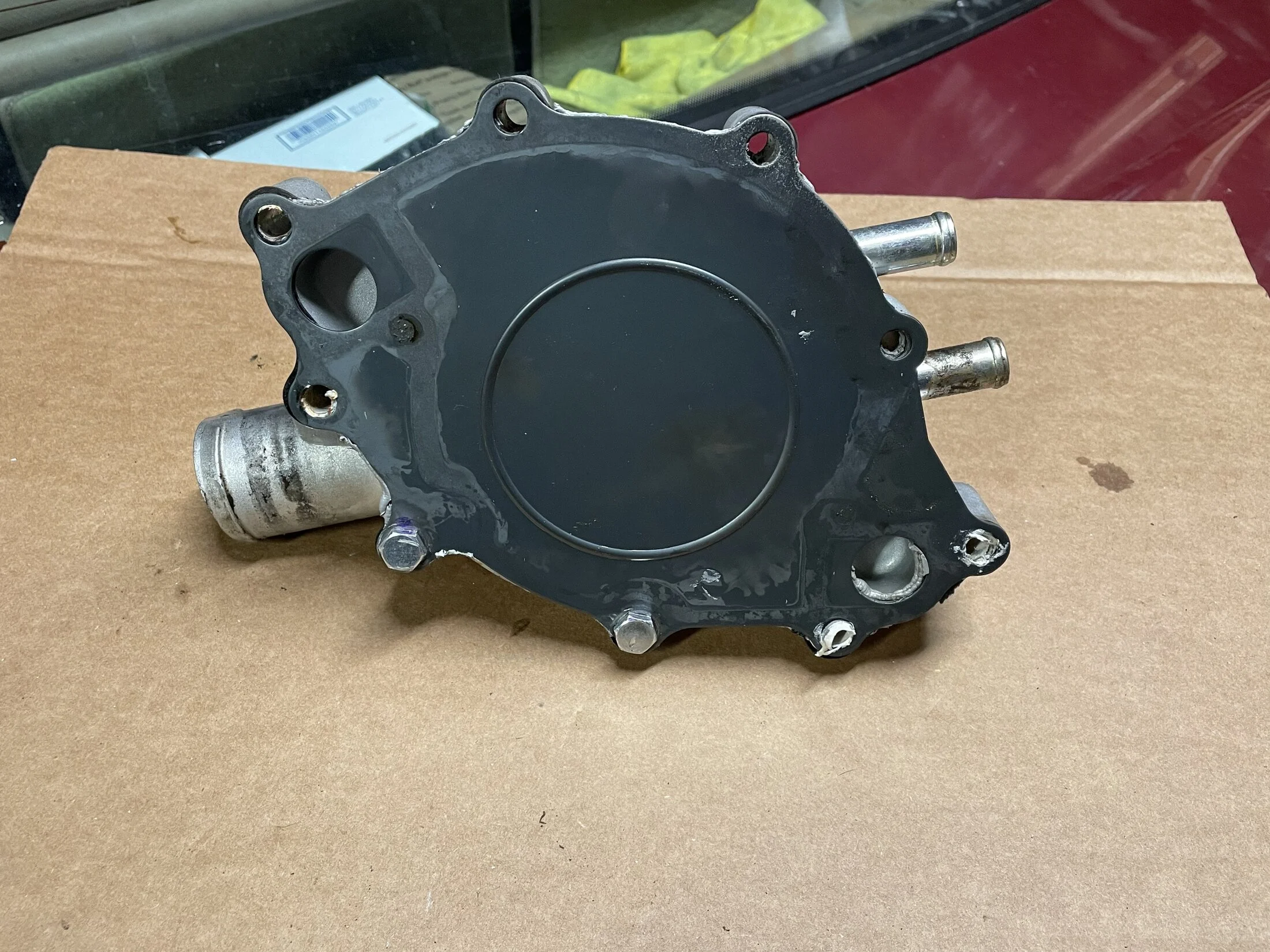

So here are a couple pics of the pump and the rear cover. The right stuff doesn’t seem to stick real well to the cover? The gasket came off real easy on both sides.

The two short bolts the hood the backing plate to the pump don’t look right for some reason. Do they have the really thin hex head? Just do not look like what’s on either of my cars.
Yes, those two on the back have a real thin head
Not sure what the right stuff is
I just use gasket adhesive and put it on the pump and the plate and none on the front cover side
All the bolts that go into coolant get the liquid teflon pipe thread sealer
You can use the cheap teflon at lowes or HD in the plumbing section
Those bolts look okay to reuse

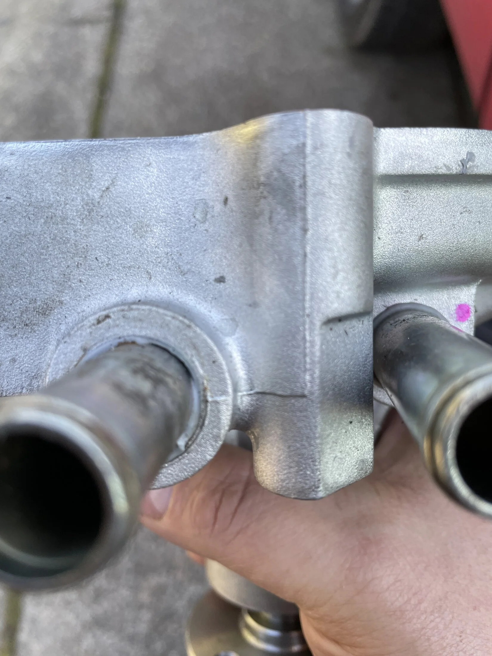

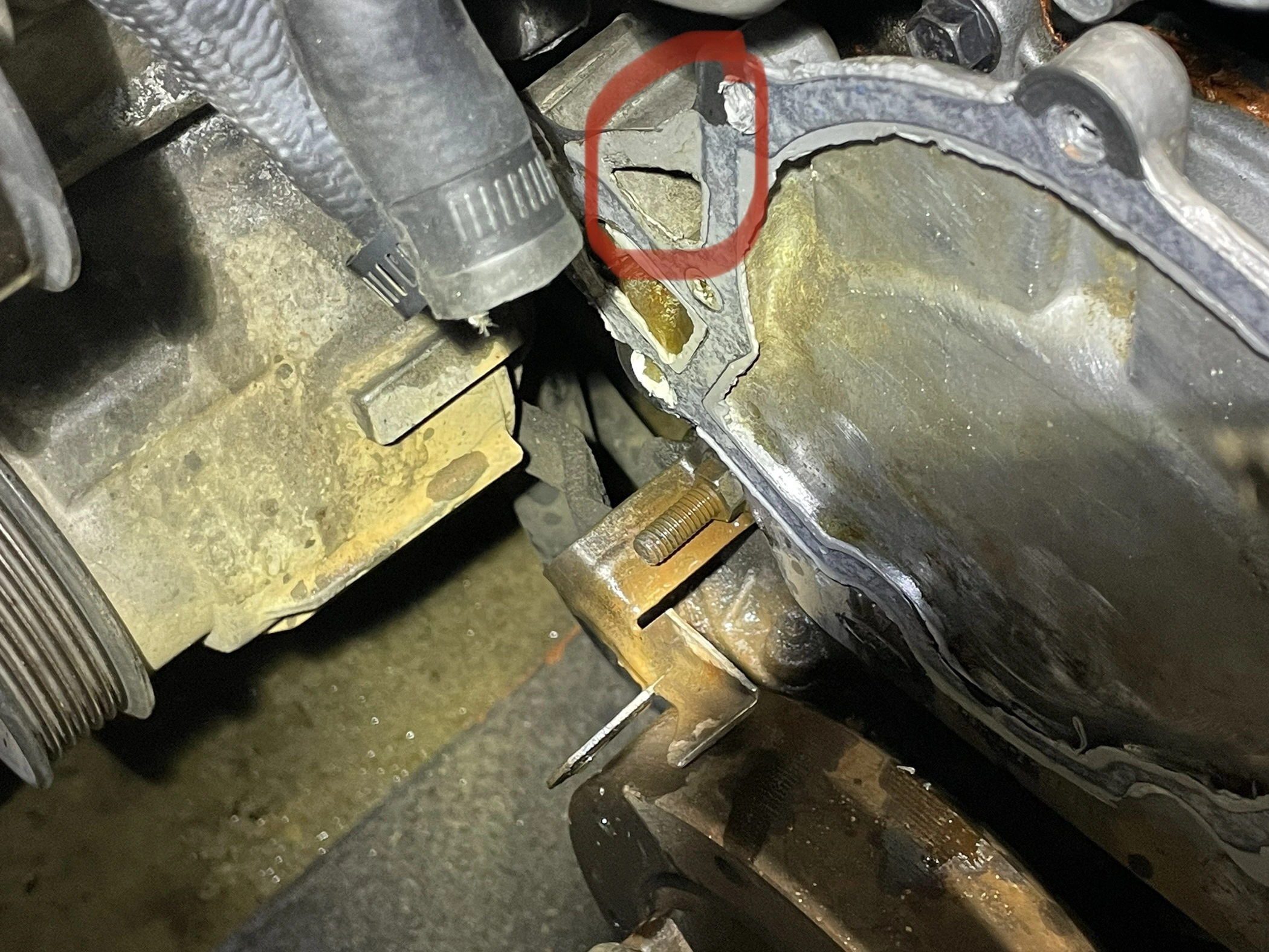

Think I finally got the water pump leak under control. So far so good. Had to get another new pump under warranty. Didn’t even think to look at the hose connections at first. Learned something new :nice:
Reactions: 90sickfox
I think the coolant was leaking from the gap. Unfortunately you could not see it when the heater hose was installed. The leak gradually got worse as time went on. The third time I put the old new pump on it leaked right after I filled the cooling system. I didn’t even start or drive the car. Usually you had to drive it to get it to leak. Taking it off again is when I noticed the sealant missing around the tube. It had to be something odd because the pump and rear cover were sealed perfectly that time.
