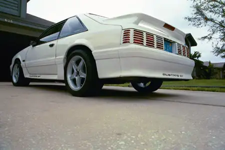

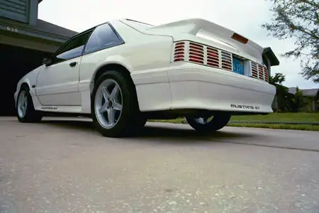

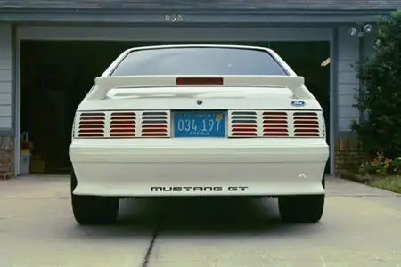

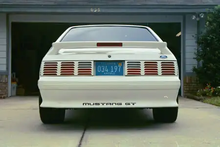

didnt read the other posts but i have nitto 555 zr's all around on 9' cobra r's. They are 275/40/17 all around. The front rubs alot on the inside fender, i am really afraid to turn with it. I wouldnt suggest 9' in the front at all. I dont really feel a sacrafice in turning, i just feel really soft tires and alot of grip :)
