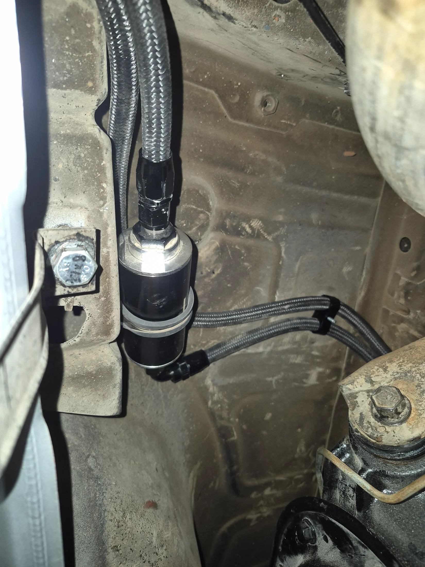

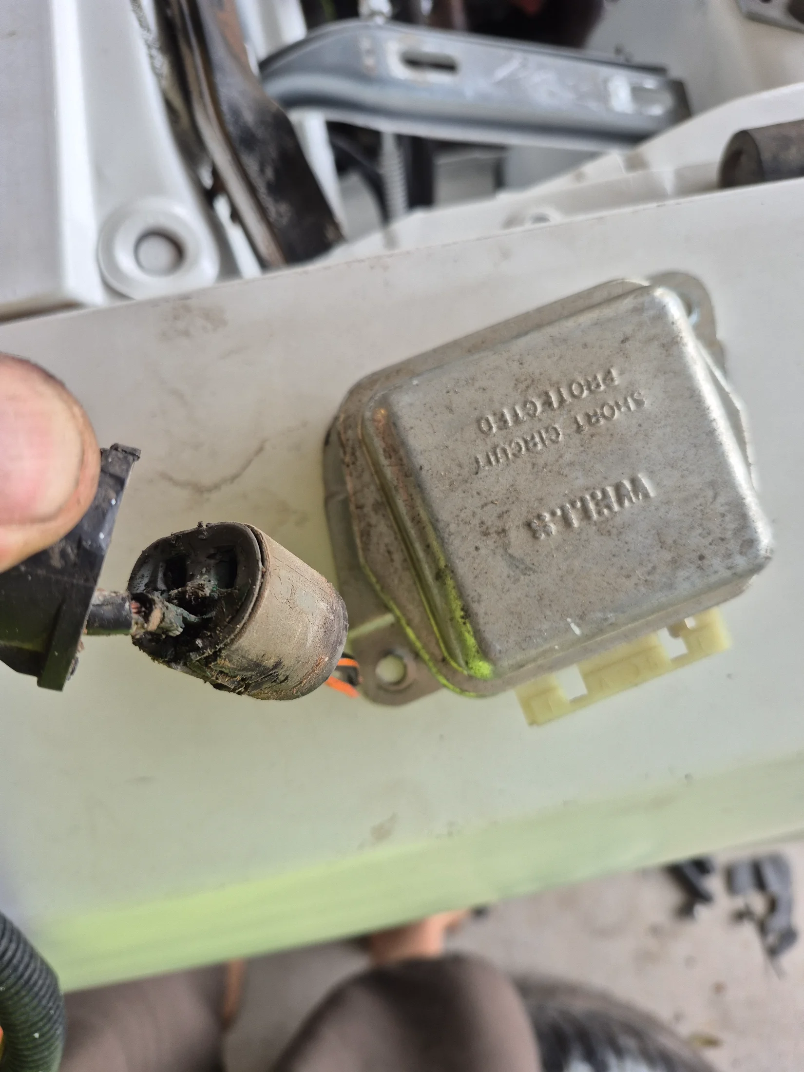

This should simplify the fuel pump circuit and allow for a better system. The previous owner had spent alot of money on the fuel system, new tank and lines, etc.. but the ground on the intake pump had the resistor in it.
Shortened the feed line into the filter and mounted the filter close to where it would have been on a later foxbody. Started securing the lines and working my way forward. I also need to secure the new midline for the rear brakes.

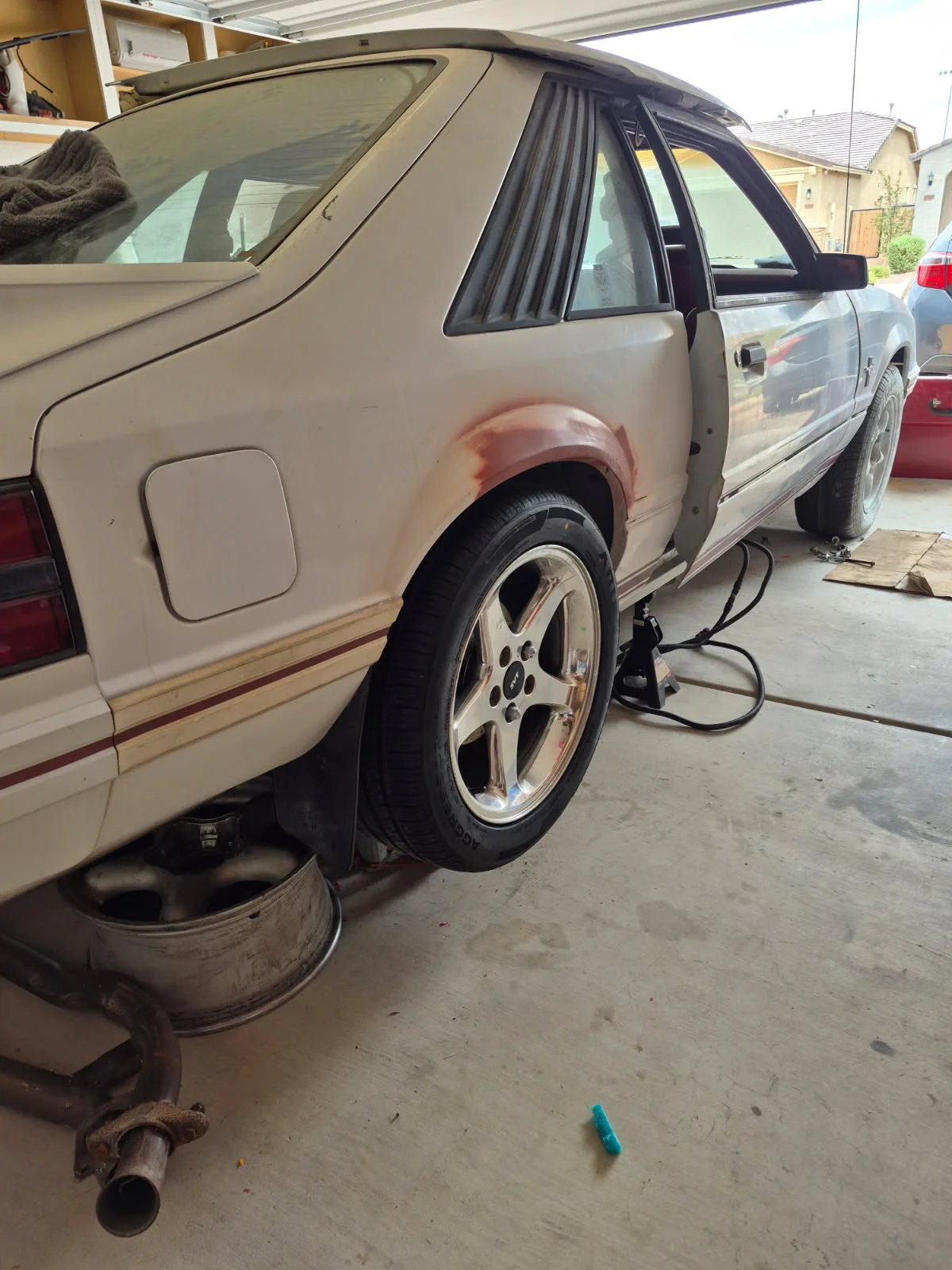

Got a great deal on some near mint 2001 cobra wheels and put 255 45 r17 0n the rear.

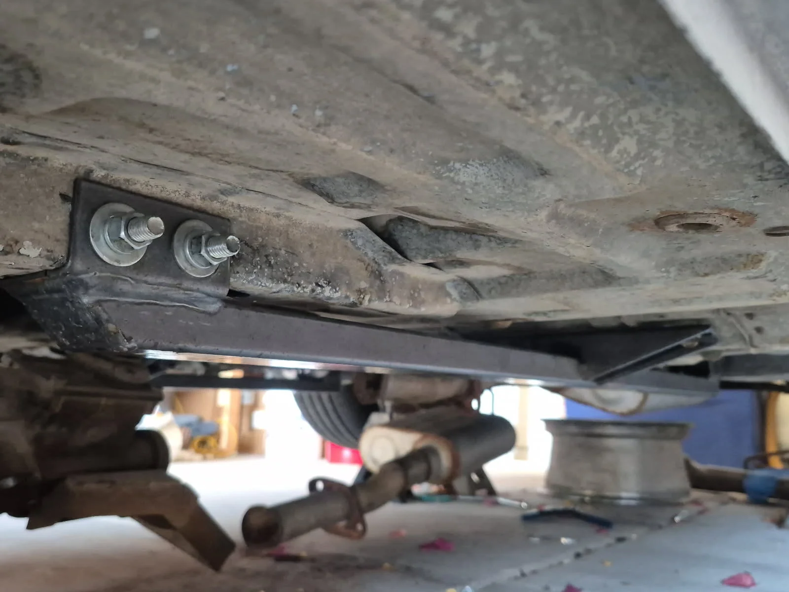

Installed the bolt in BBK subframe connectors.

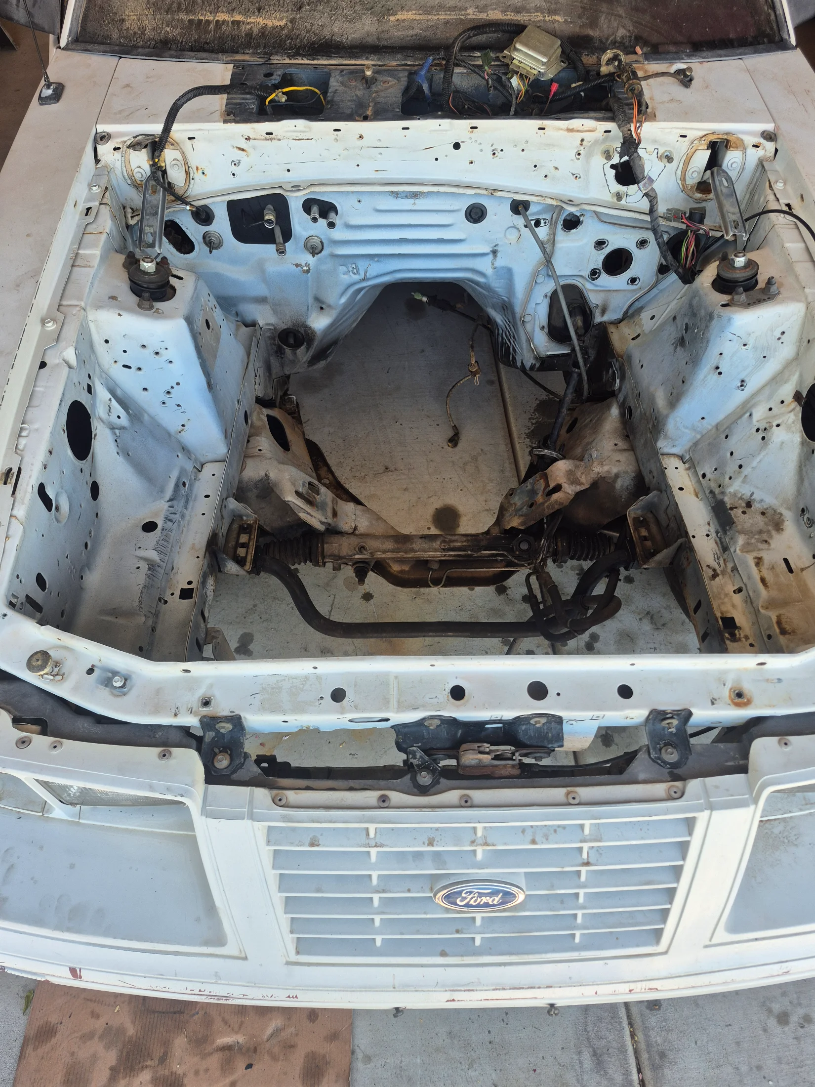

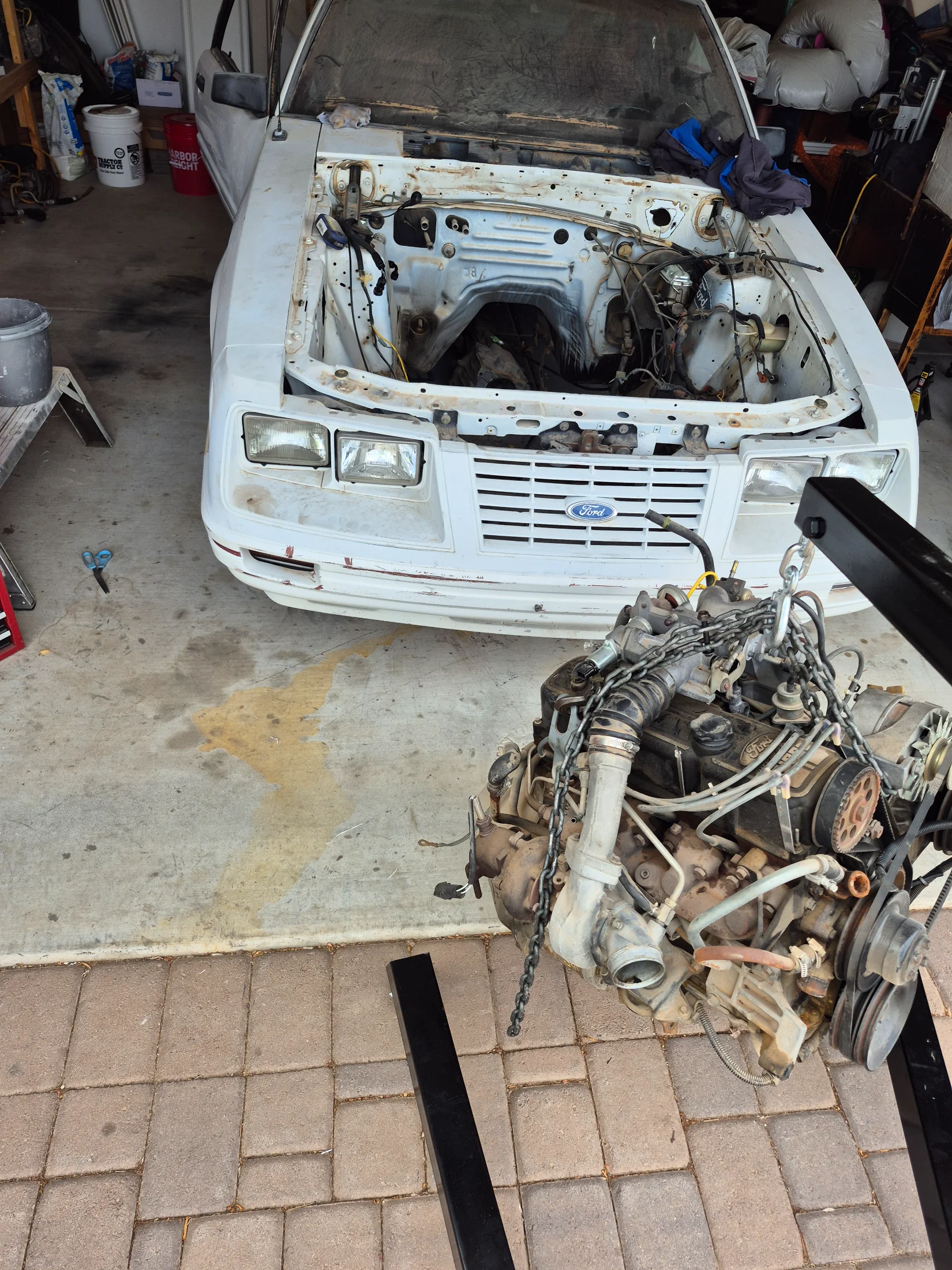

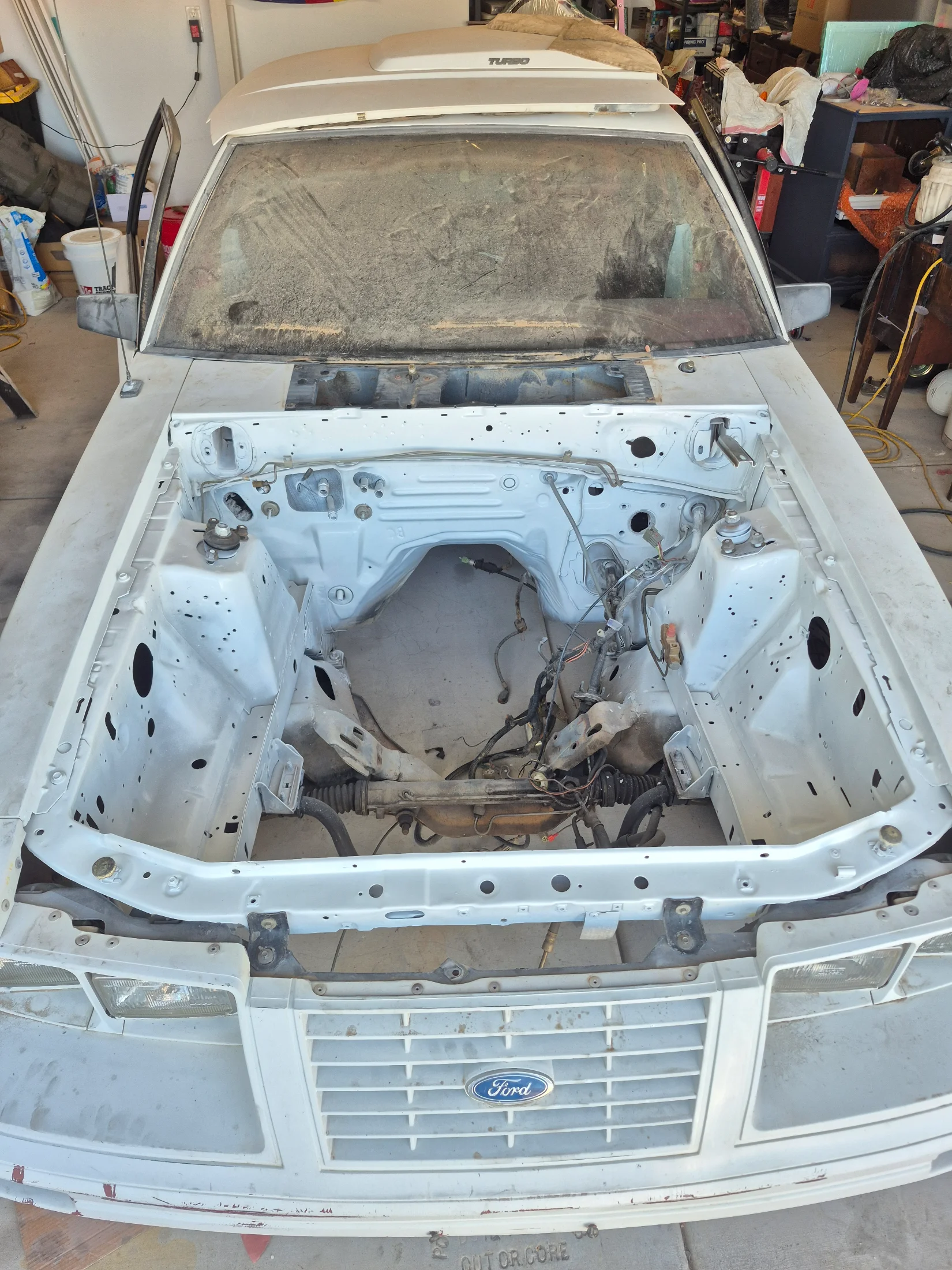

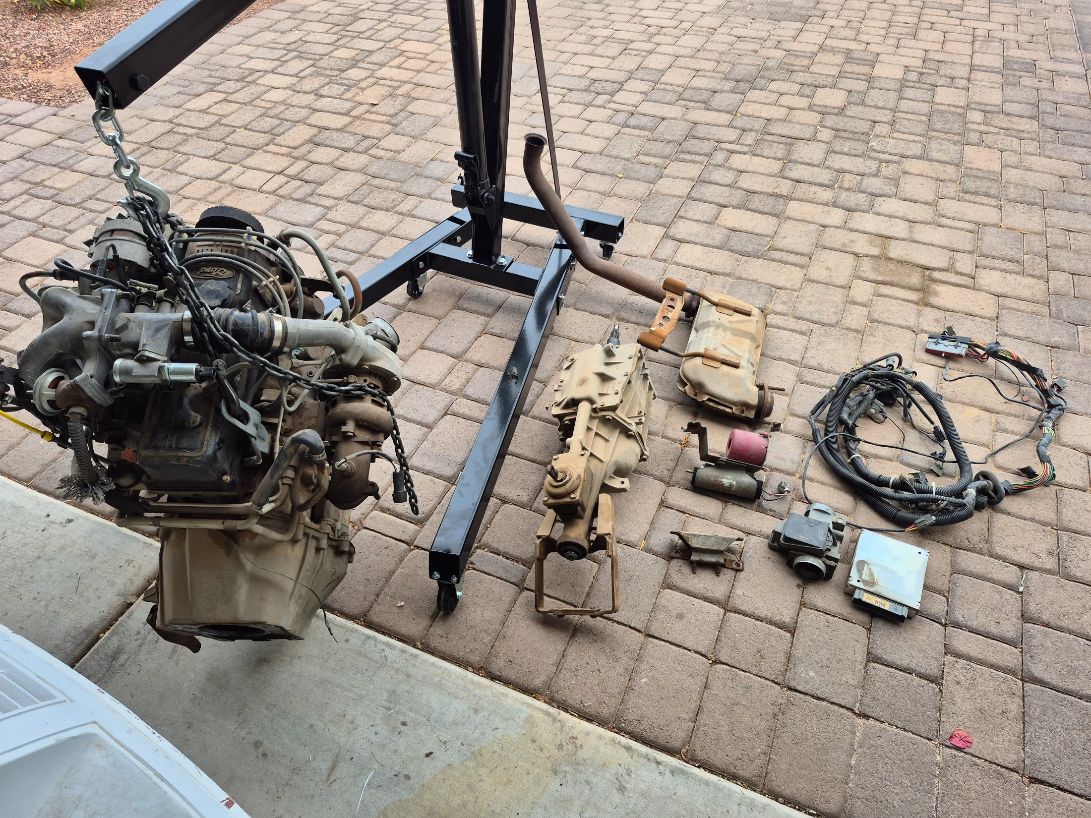

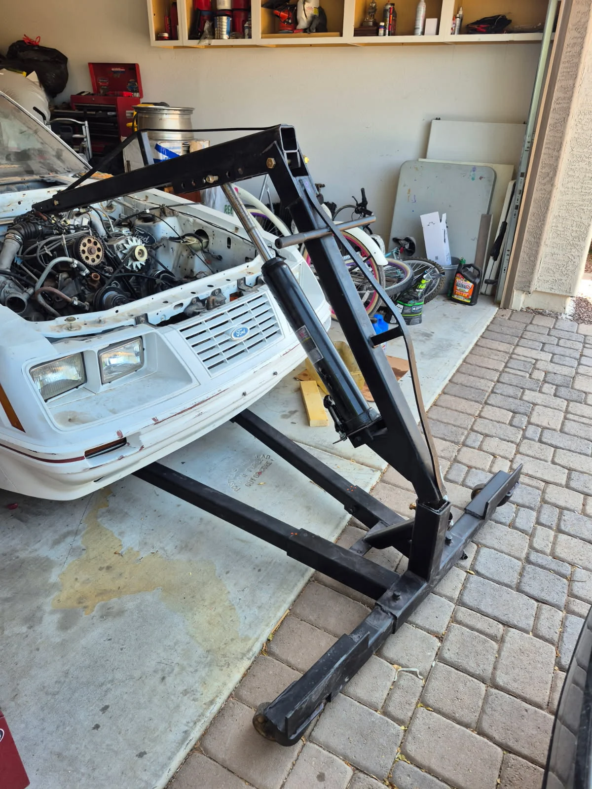

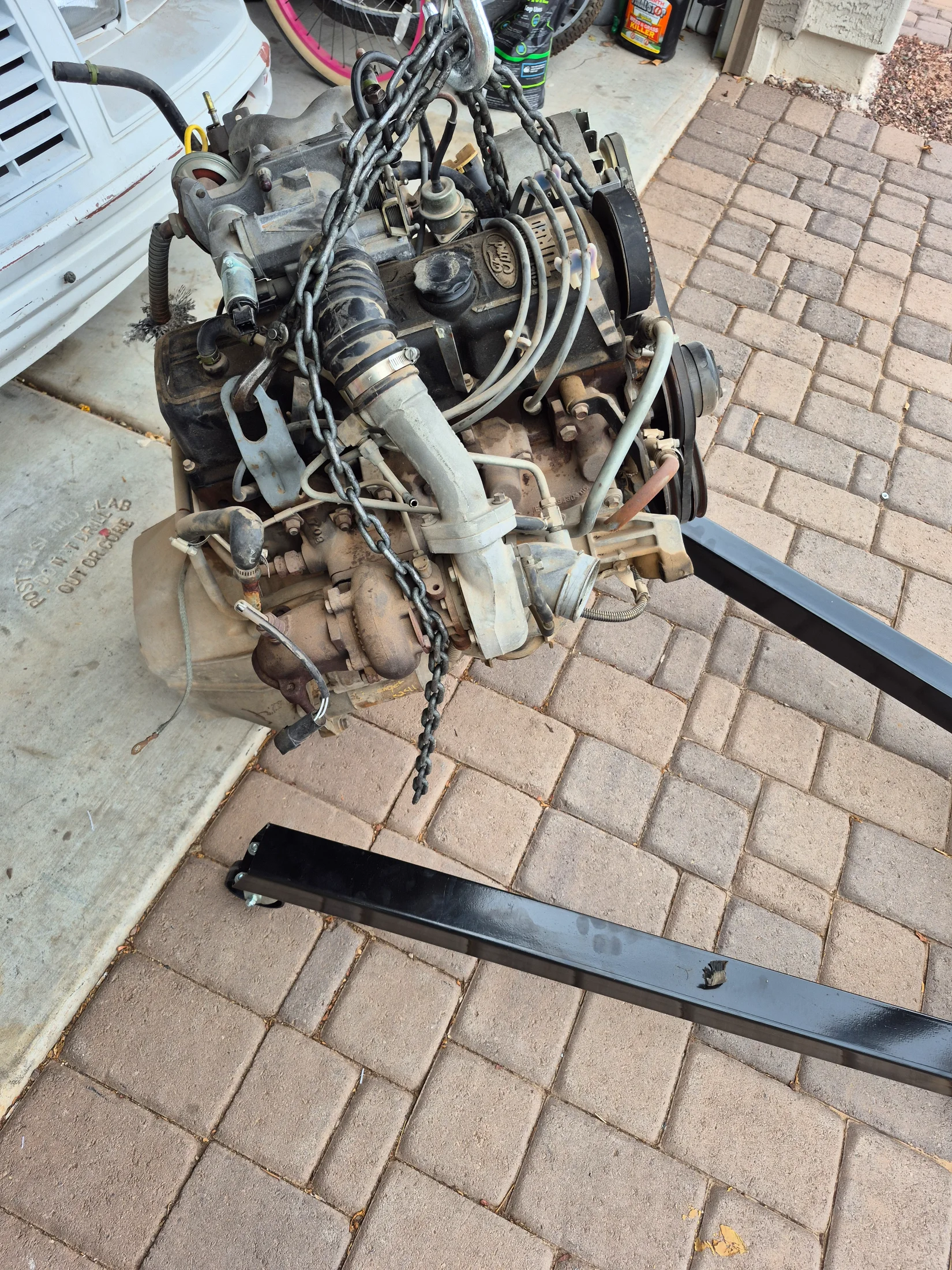

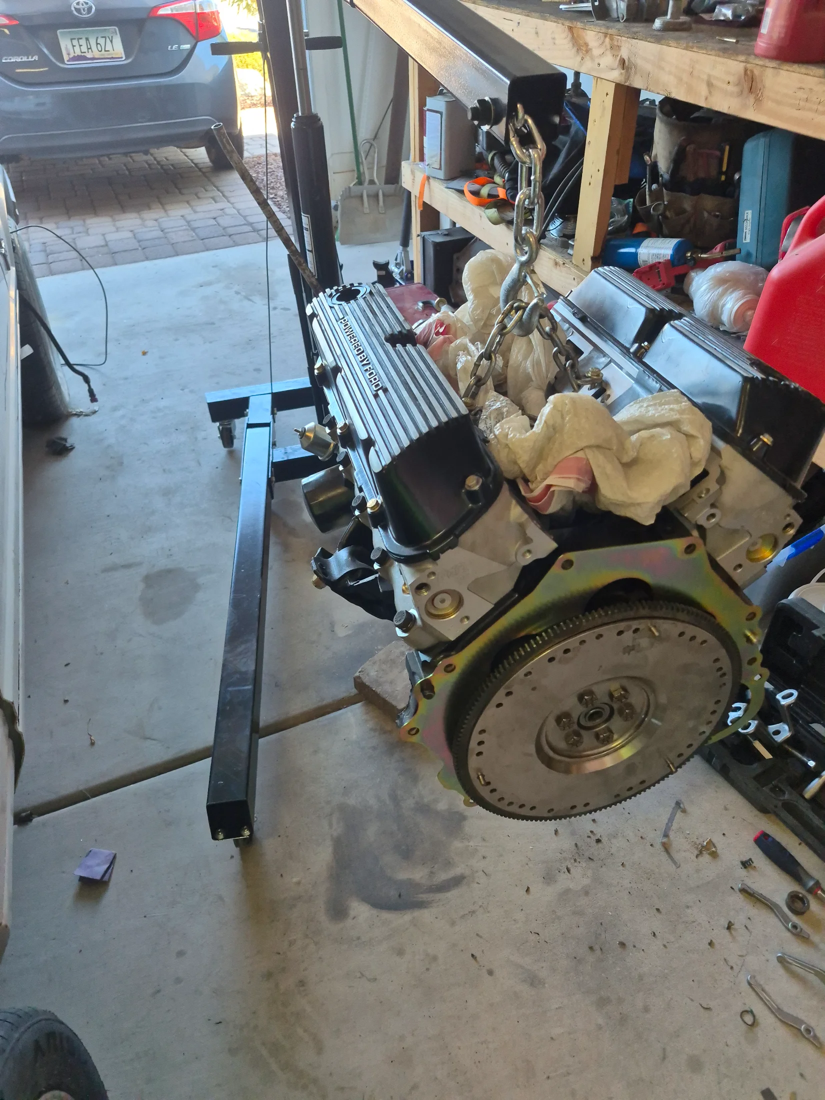

Next I bought a "cheap" engine hoist, I had seen the reinforcement welds on the hoist but figured it would work for the 4cylinder. I did not even get off the mounts before it snapped. The guy I bought it from was cool and gave me my money back. Leson learned, not all good deals are good. oh well ordered one and should have it soon.
Hopefully next weekend Ill have the old motor out and get started cleaning the firewall for paint. There is a local paint store that will mix paint and put it in an aerosol cab for $30.

Well glad the hoist didn’t mess up your car. Just me but as soon as you get it running take it to a muffler shop and have them weld those subframe connectors in. The bolt in style don’t offer a lot of stiffness.
The dirt track boys used to really like those motors but I have no idea if they still run rear wheel driver in that class anymore or not but it may be another source to sell the parts.

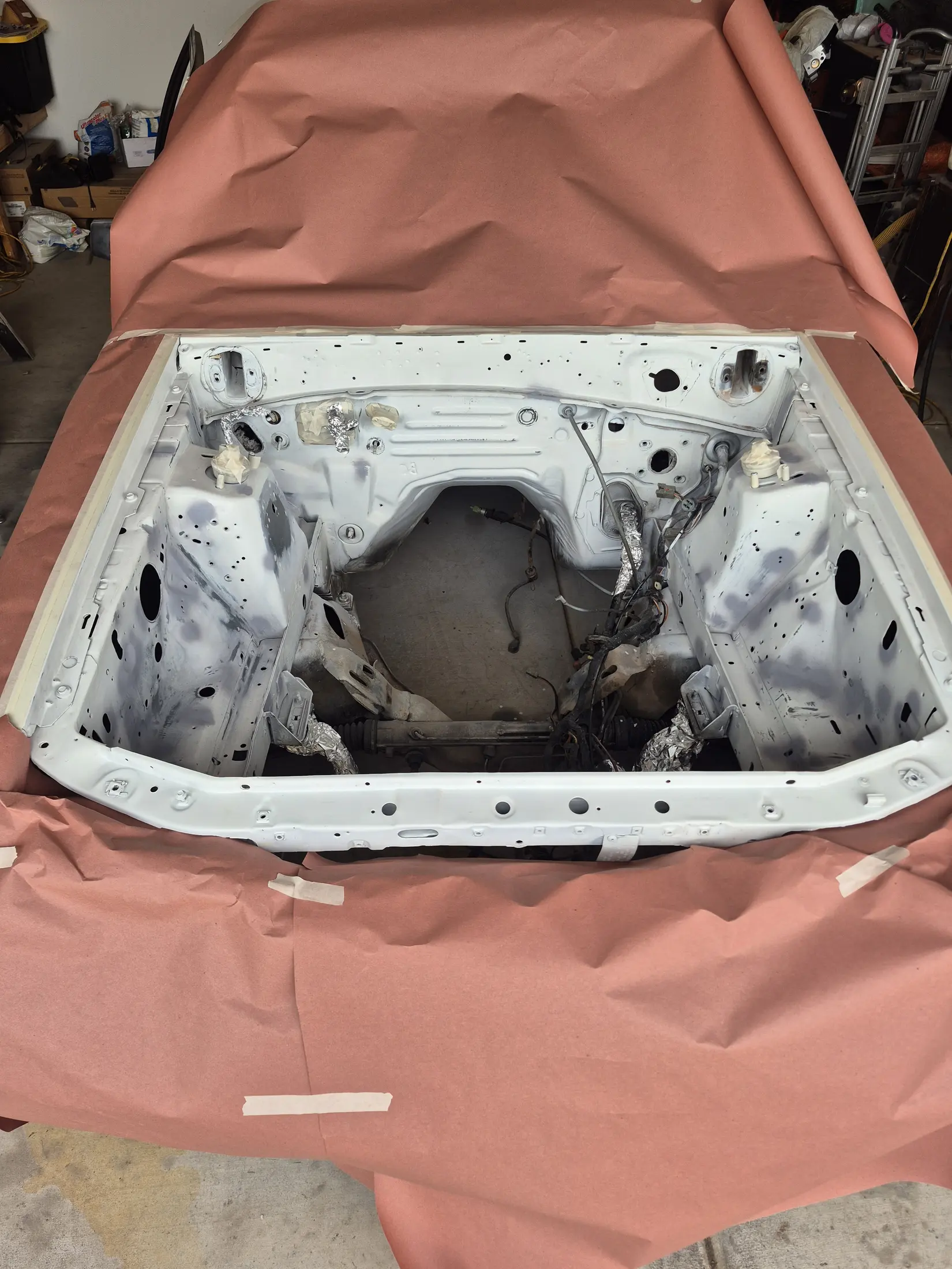

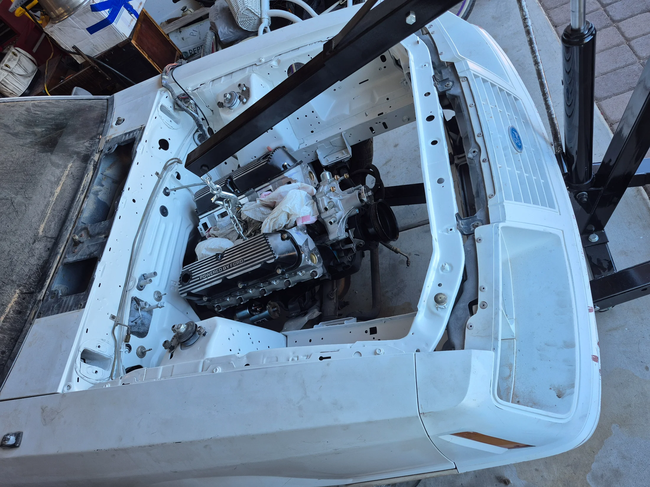

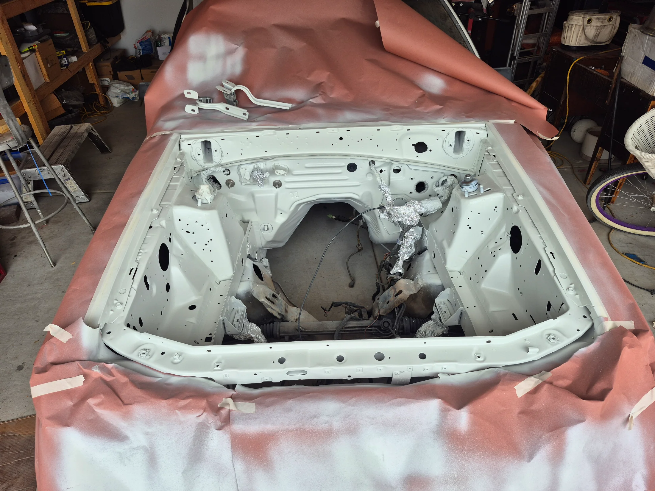

Well, I got impatient and sprayed it. I was not going to post about my mistake but it could help someone else. I should have waited till it cooled down and taken my time and prepped it better. My rush job looks bad a d cost money. Oh well, need to scuff it and re-shoot.

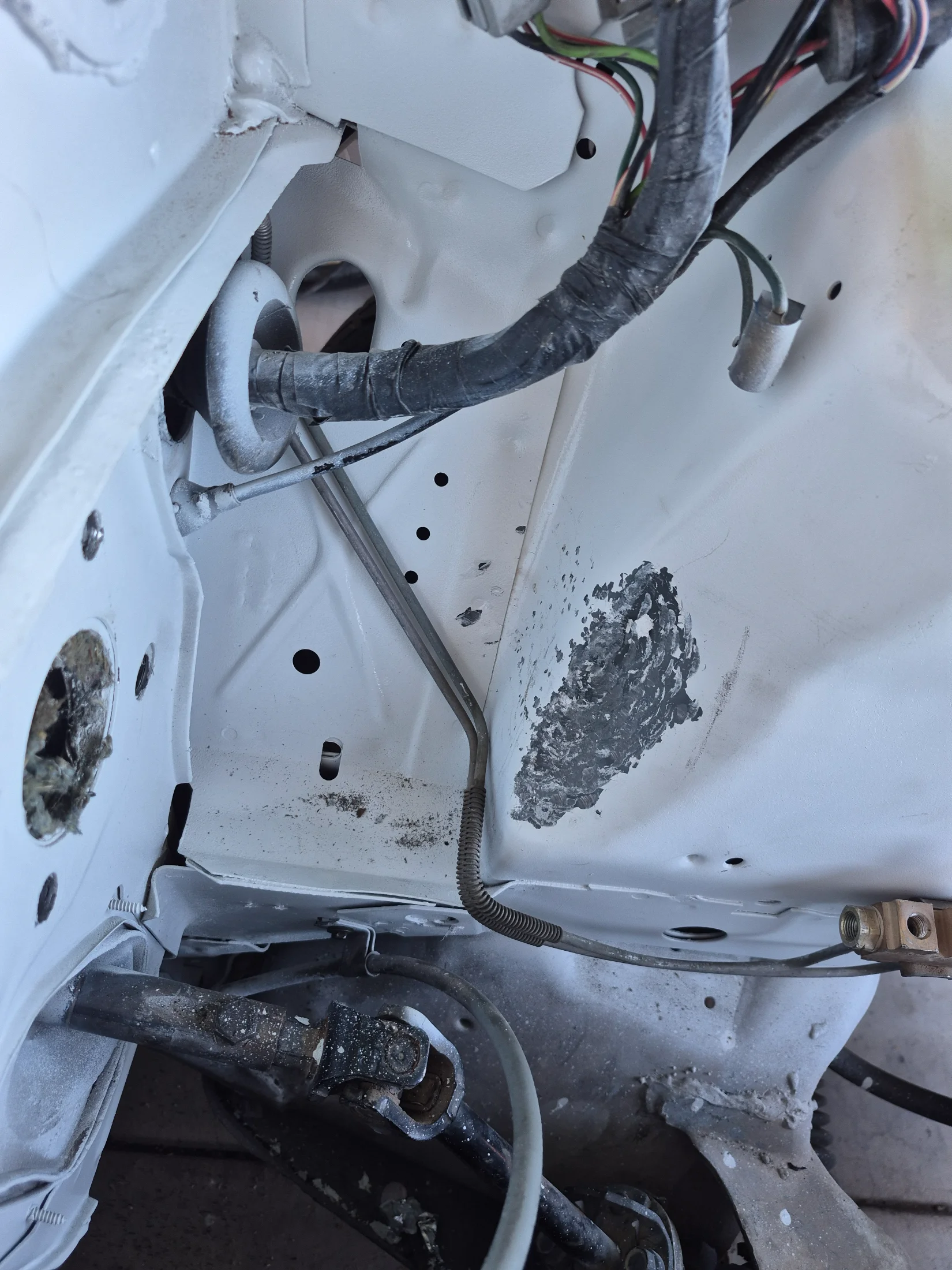

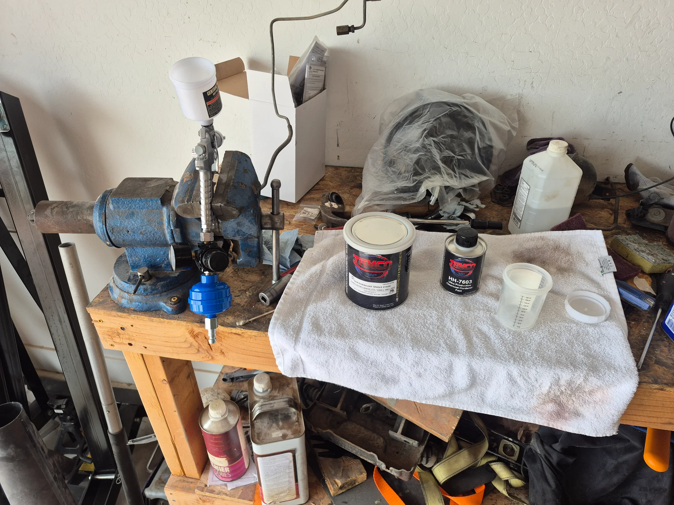

After a period of time I finally got back to the engine paint. I sanded down my hurried mistakes and spotted in some primer. Stripped down and masked the bay better. I bought the touch up gun from HF and some single stage from Tamco. Overall I am pleased with he result. My hand is to big for the gun and I was bumping my adjustments, i ended up with some orange peel. The tip was .8 as well a little to small for the paint. The oxford white looks good and now I can start the assembly.

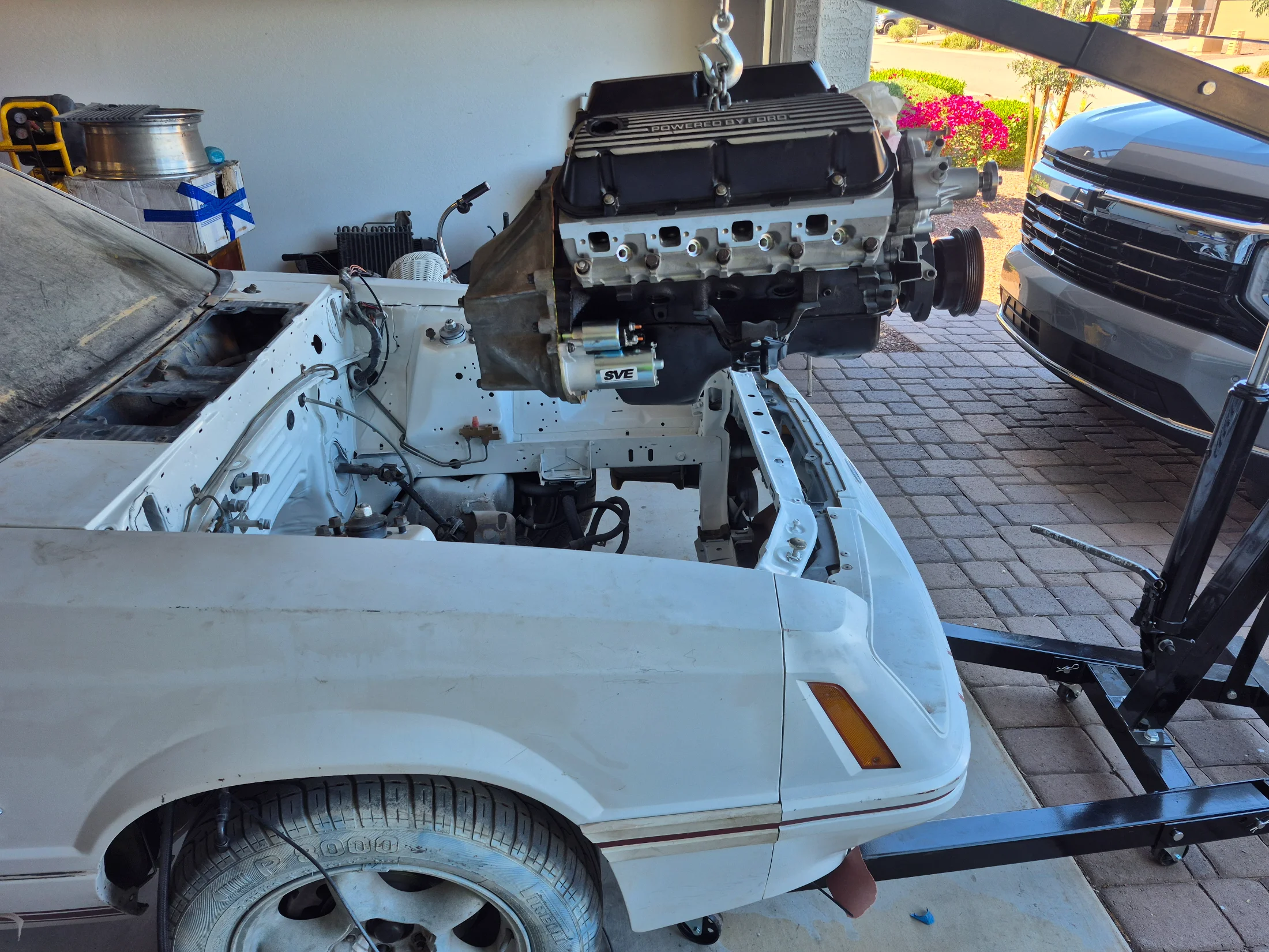

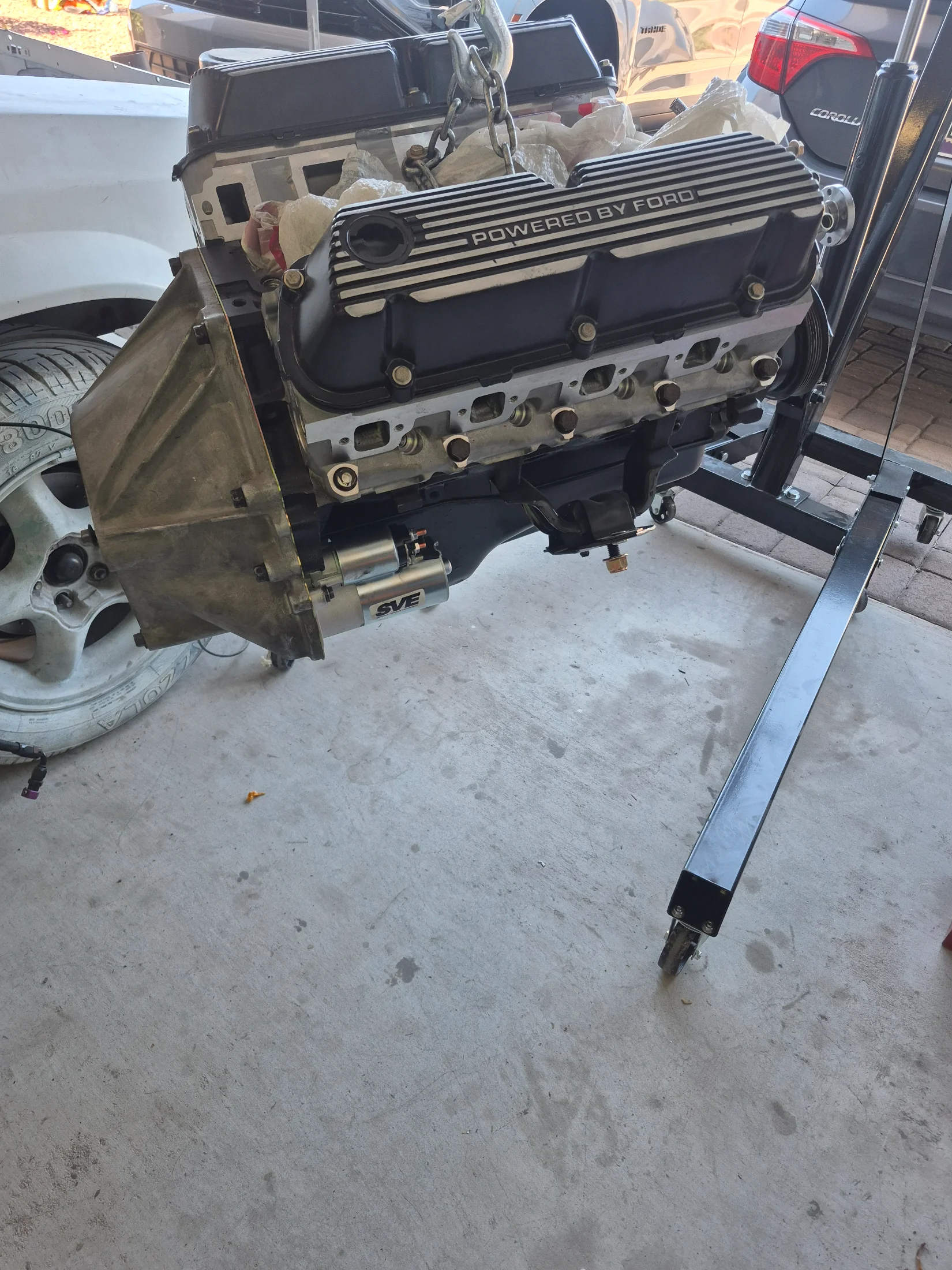

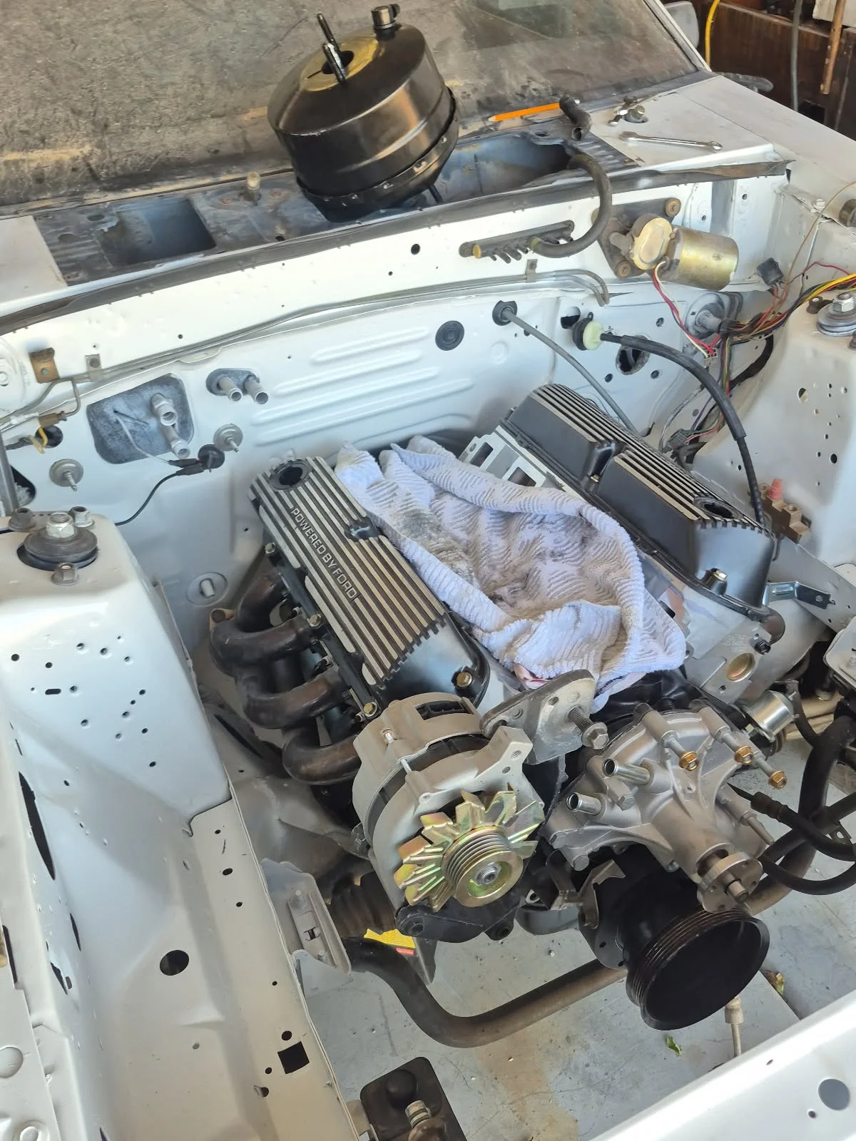

Yep, it is much better with a clean engine compartment. Had to run to work and install my clutch fork pivot and then throw it all together. Now that its in there, its a little anticlimactic. Lol

I would not say anticlimactic at all, more like its going to look very proper when the motor is all dressed out and the core support gets filled up. Then its back to complaining about how full the engine bay is when you have to work on it.

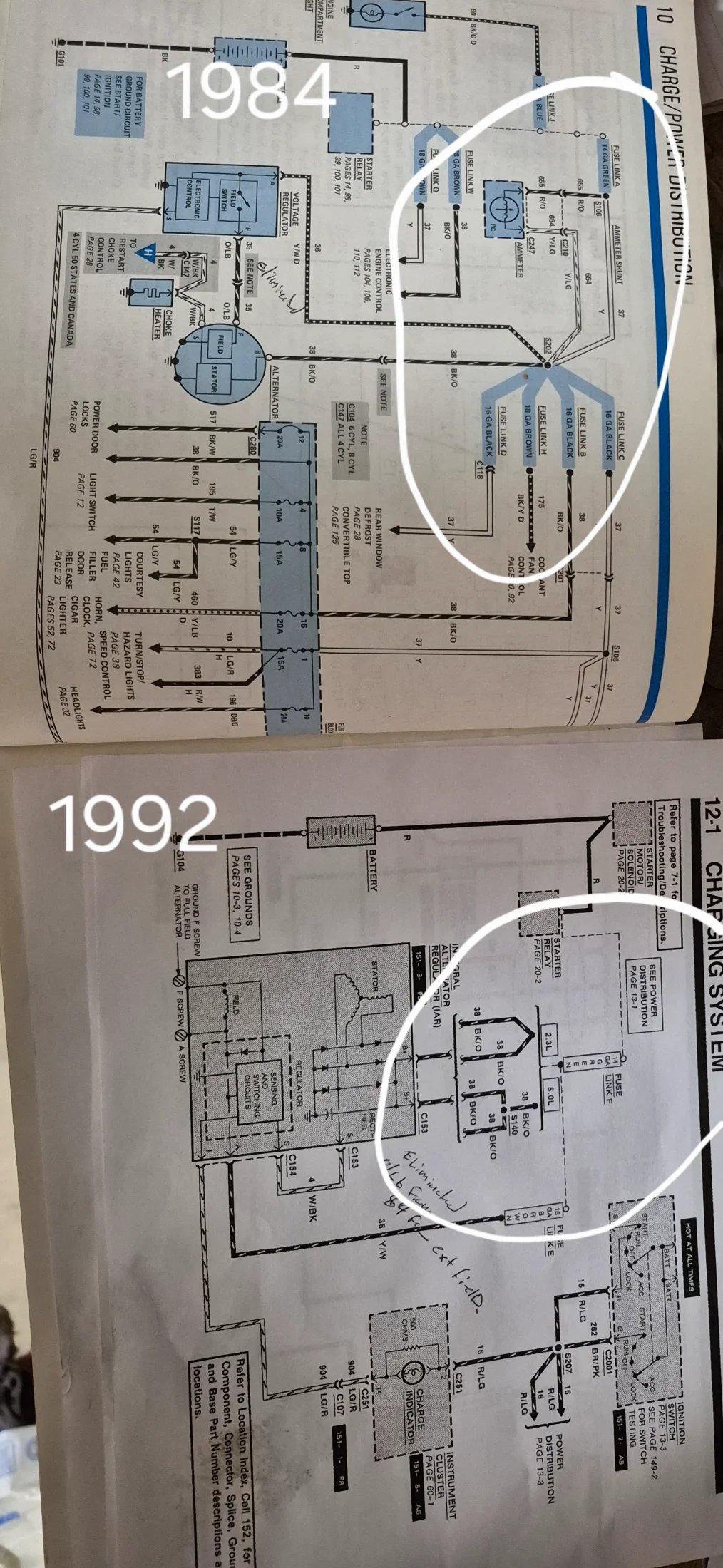

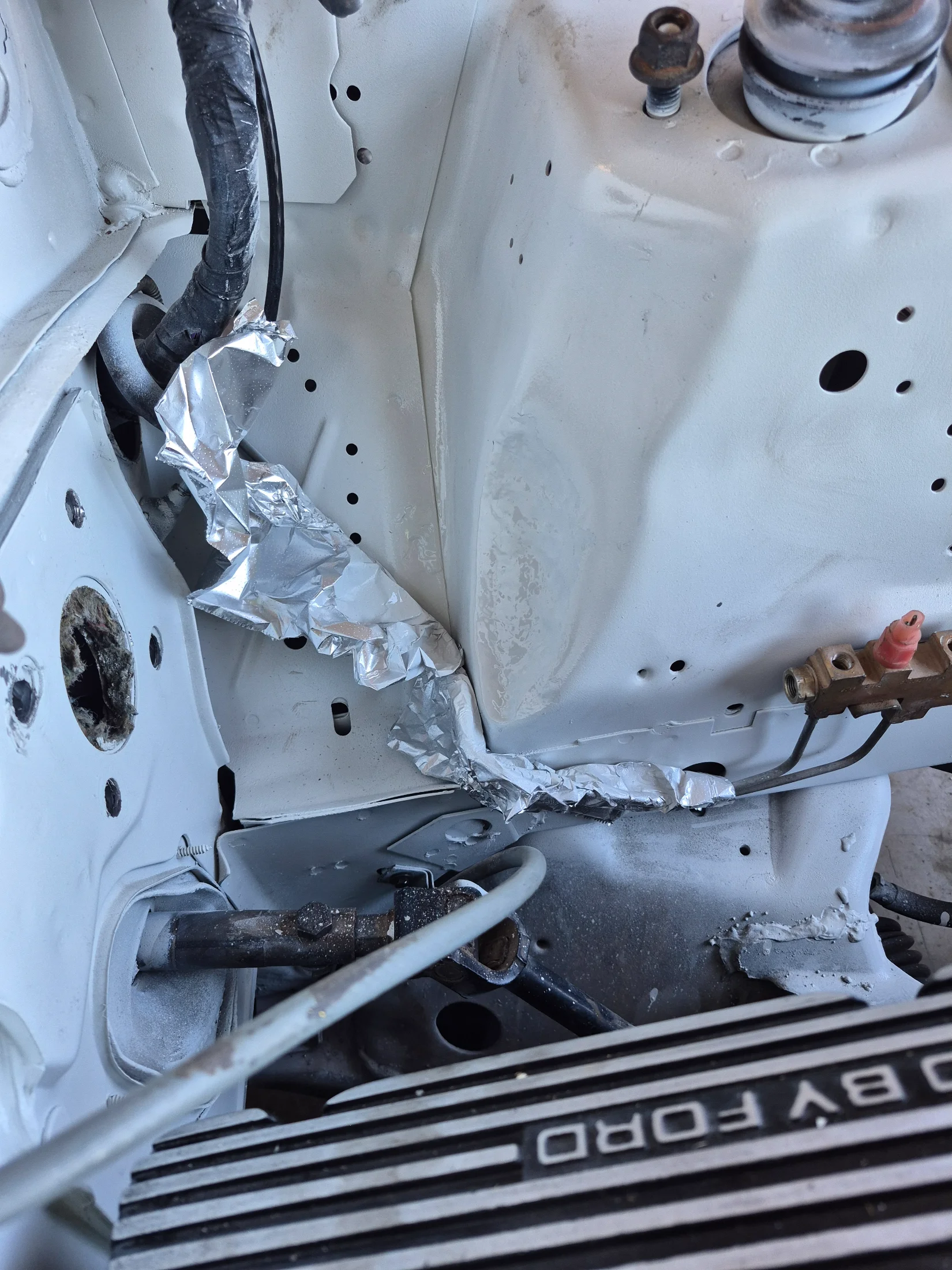

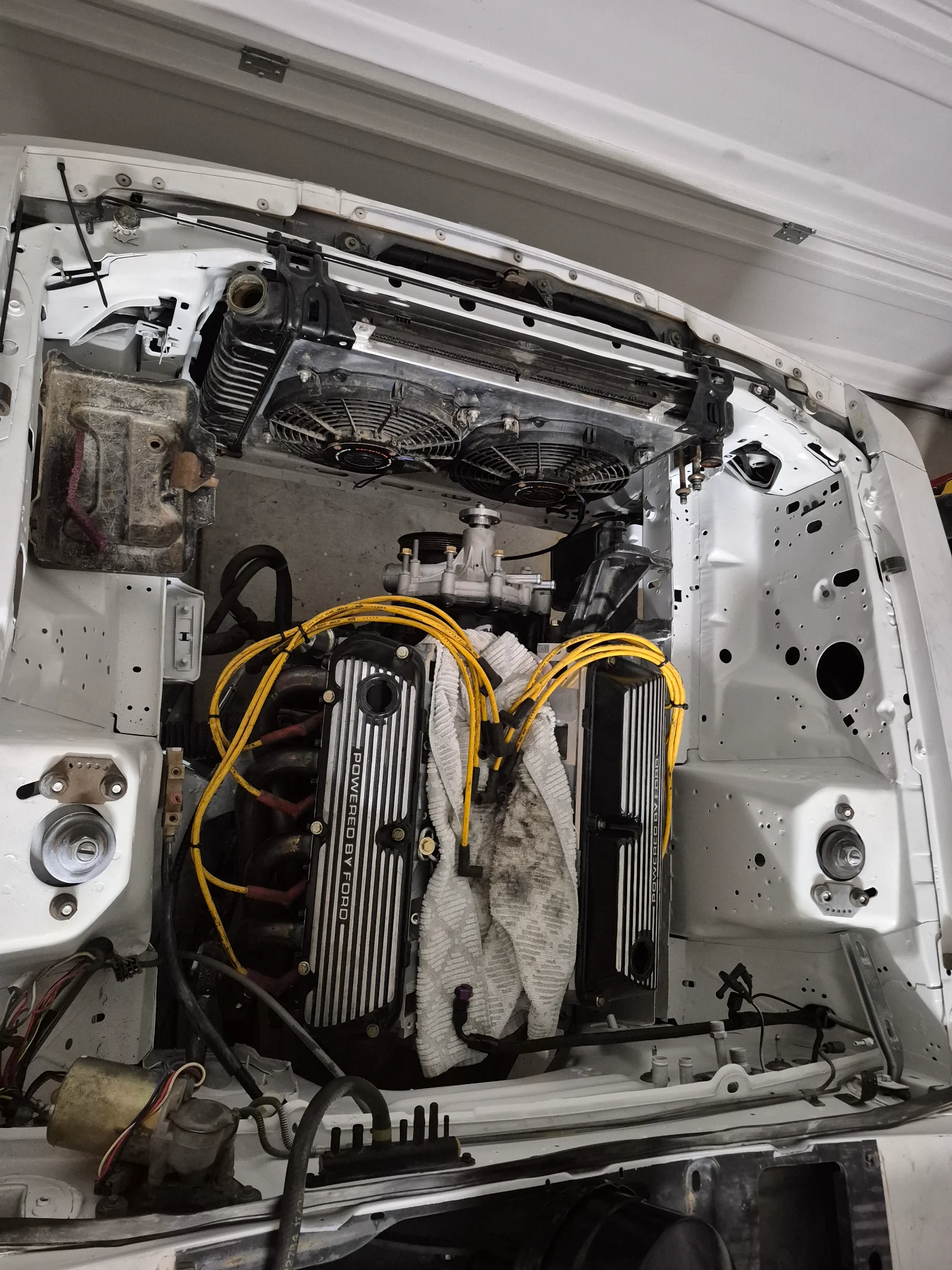

I got alot done this weekend. Got the drive shaft and half the h-pipe and almost done with the wire tuck. The passenger side is done and the drivers side is getting there. Part of this swap is putting a 2g alternator and getting rid of the external refulator. I am a big fan of running fuses off the battery in a battery fuse block such as a newer gm product runs. With my wire harness now out the engine bay, the level of protection need to go from the 80s to a modern solution. I do not like fuse links. Ill post more pics as I move along. I need to make battery cables and an alternator harness. I am running a 92 up starter as well. In the wiring diagram it shows how to integrate the two systems
