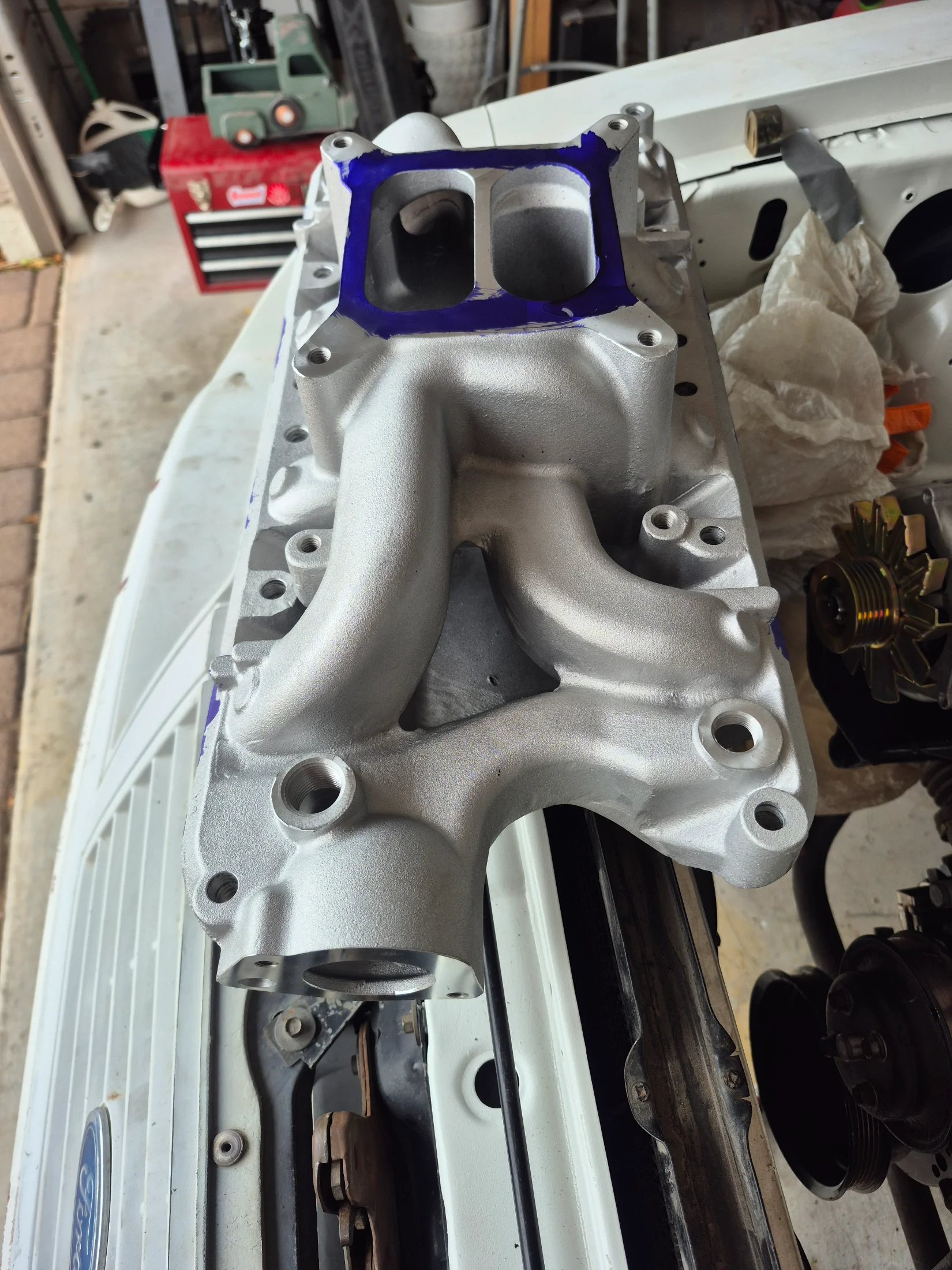

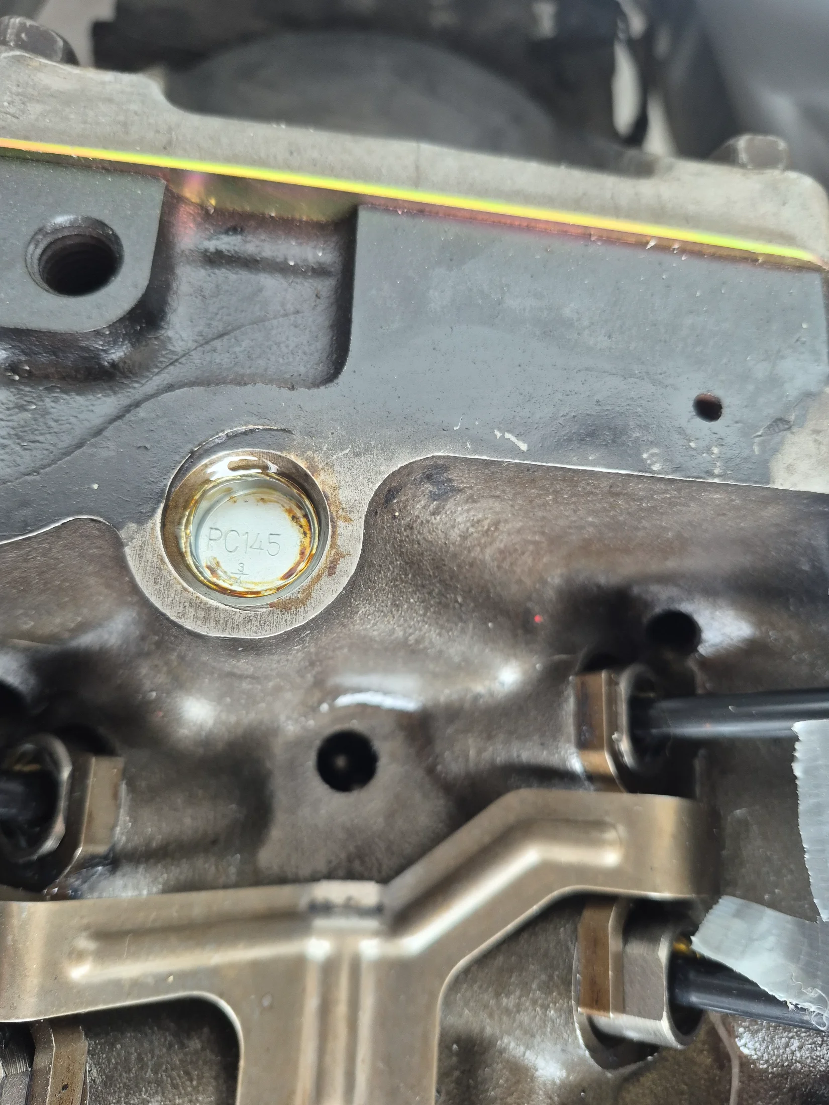

I got my Amazon air gap.intake and it looks pretty good. Im going to clean up the casting flash and install it. I primed my motor and found thebplug on the rear china wall starting to seep. I used aircraft sealant and sunk it down to were I thought it should go. Any suggestions?

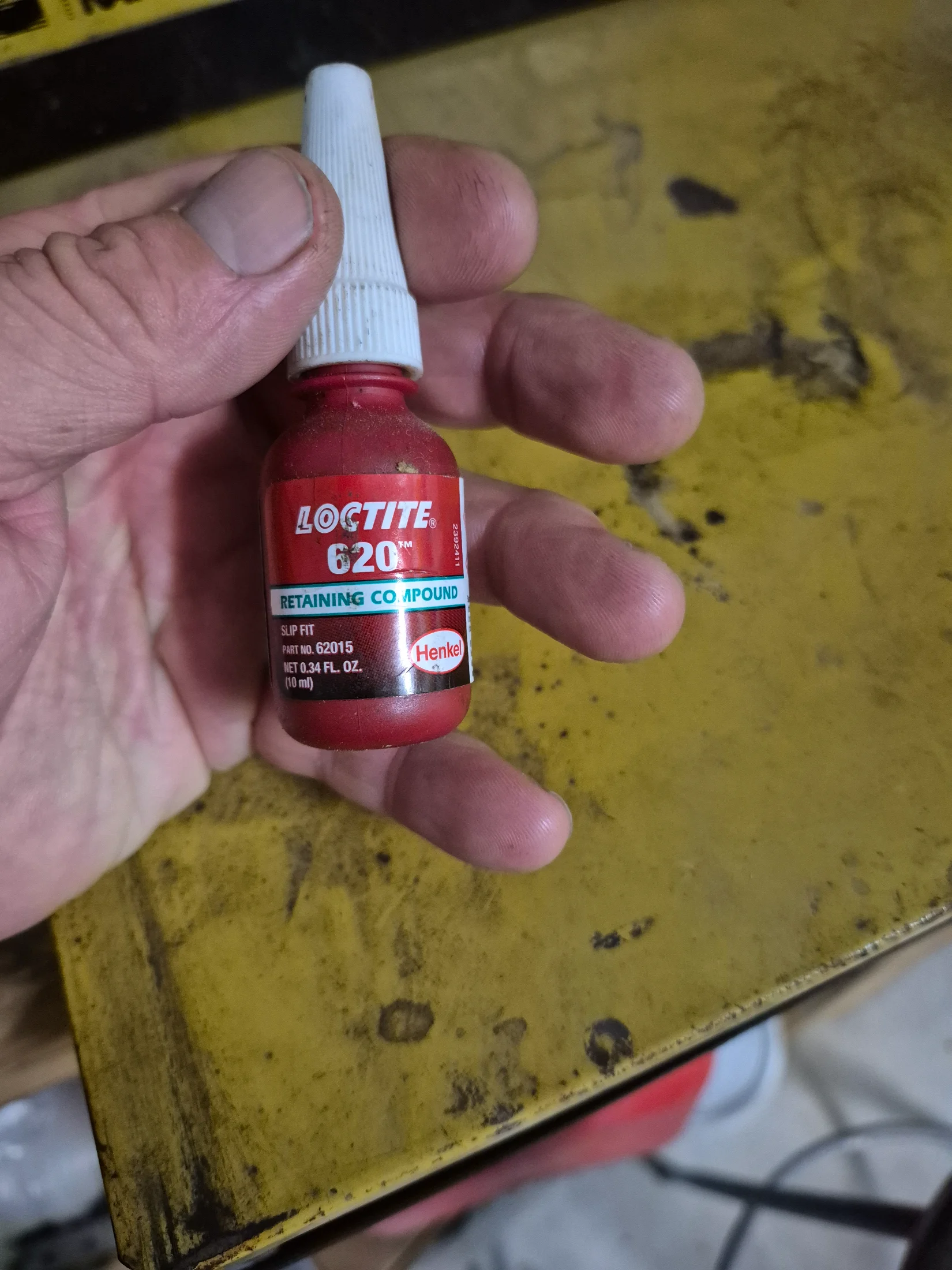

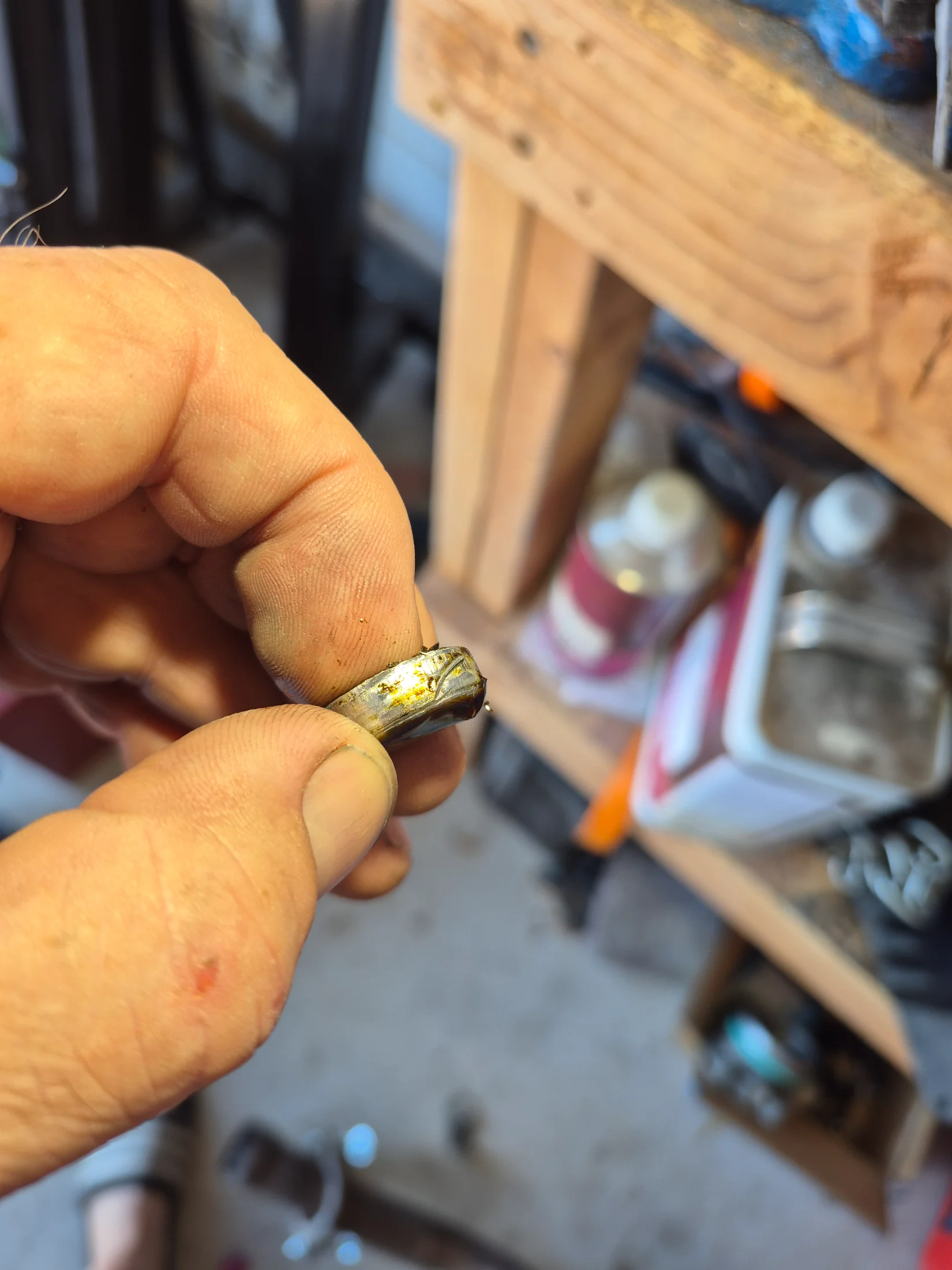

I installed another plug and primed it and it leaked as well. I Finally got the third plug to seal. I used a 3m scotch bright to rough the edge of the plug to rough up and used a liberal amount of this retaining compound. Let it set for 24 hours. Hit it with the prime tool, no leak. Not ashamed to admit i used Gemini to trouble shoot this. How many of you guys use this tool for specs or quick technical questions?

I had ordered an Amazon air gap intake and it looked pretty good. I started cleaning up the flashing. The one issue i have is the rear runner port is not square. I squared it up best i could.

Looks familiar, other than missing the "ProComp" branding on the runner.
Are you thinking of cutting the plenum divider as well?
Reactions: mattcrp1
I blended the divider and smoothed it out some. the tbi adapter has it standing off the mounting surface some.
Reactions: LILCBRA
I kind of have of set that way. I am running out of hood clearance. The tbi is shorter but the air gap stands up more than a regular manifold.
