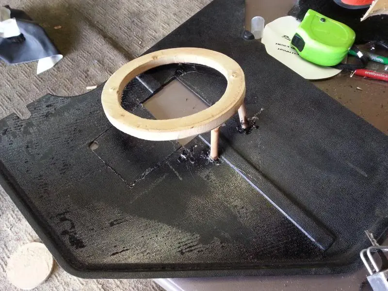

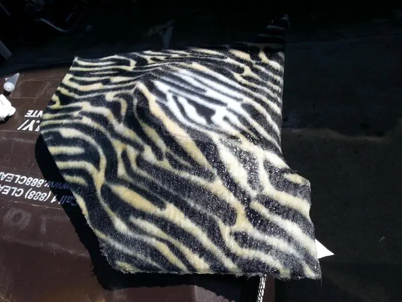

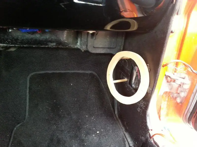

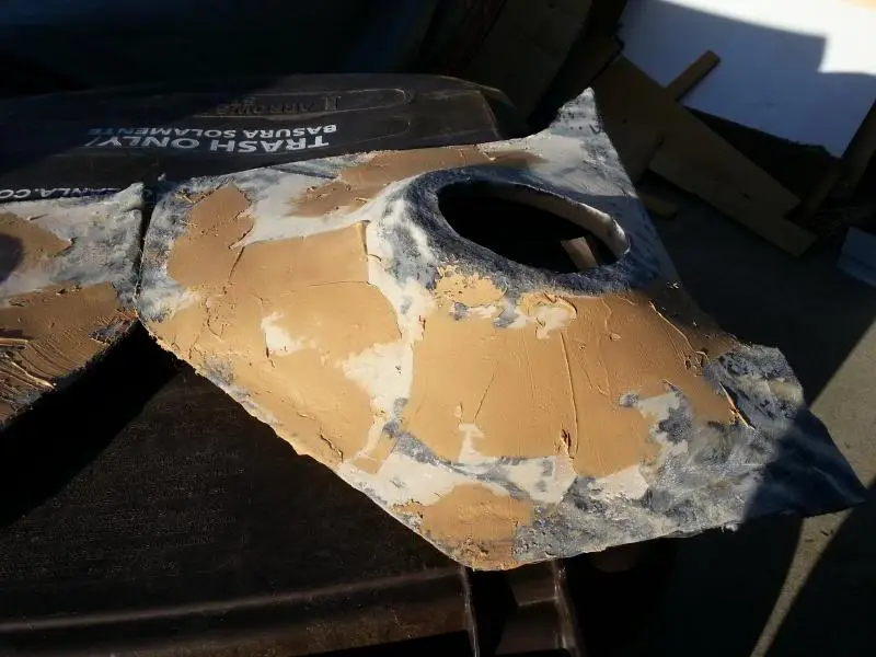

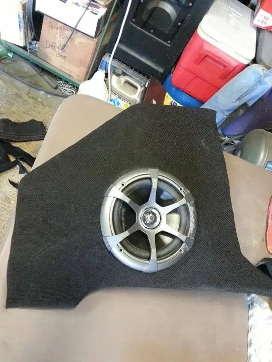

since i finally have a week before my next car show, i decided to make some fiberglass kick panels since the ABS ones point the sound to my ankles.I had some old "stock" kick panels so i was able to modify them.
Made my angle to point the sound upward

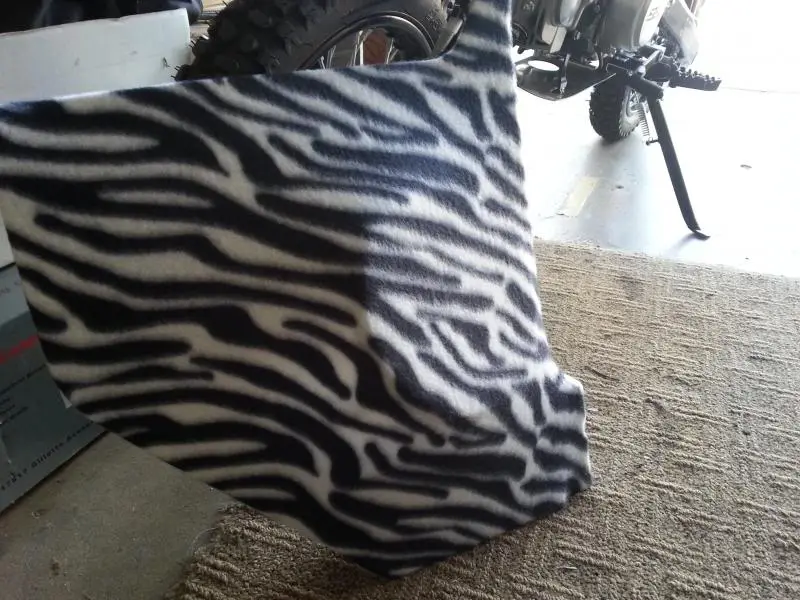

wrapped in fleece
resin'ed the fleece

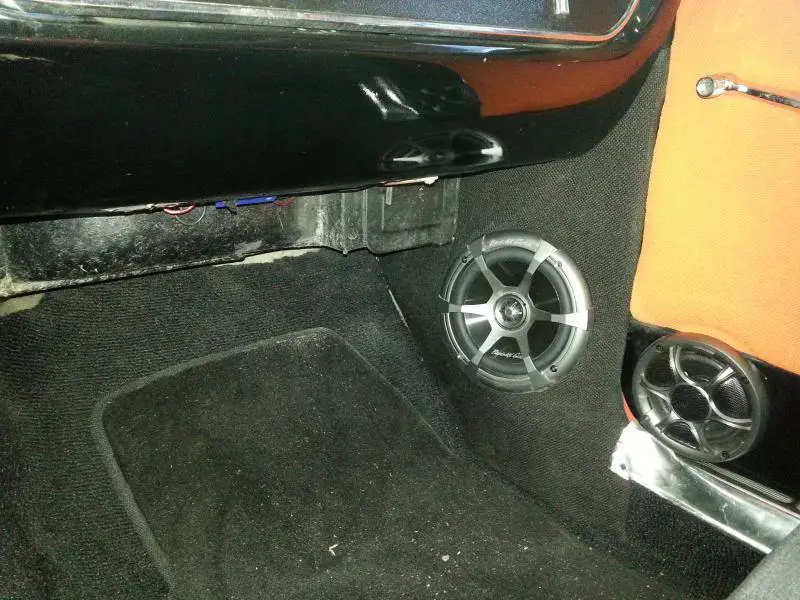

smoothed out a little, gonna be covered in suede later,tweed for now
wrapped

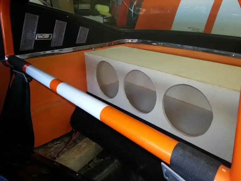

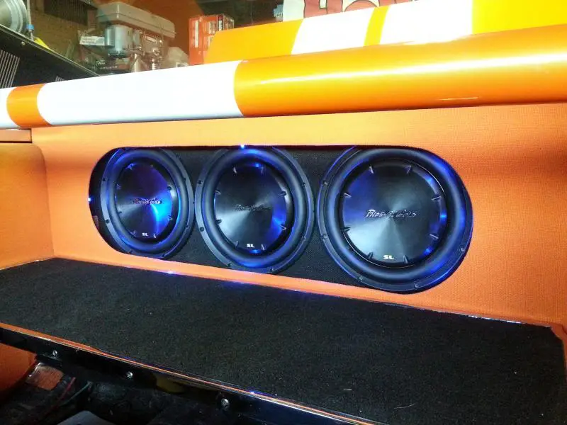

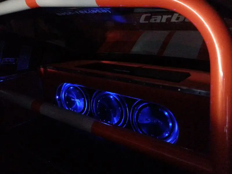

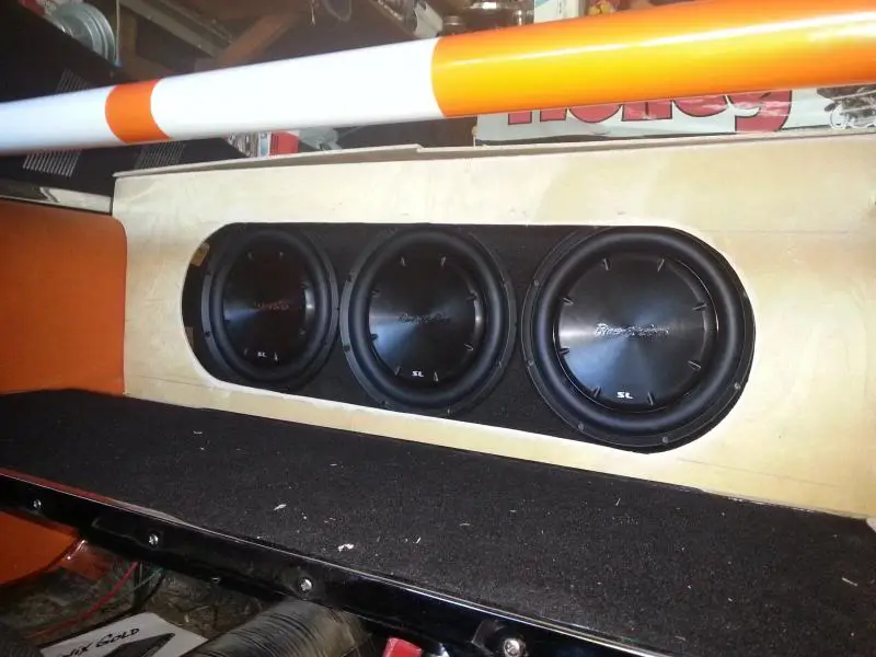

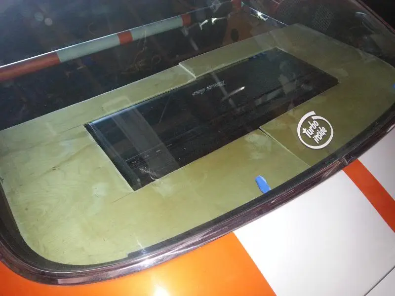

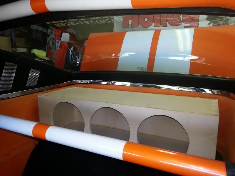

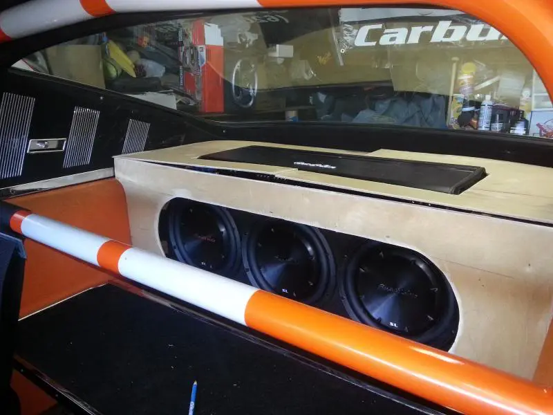

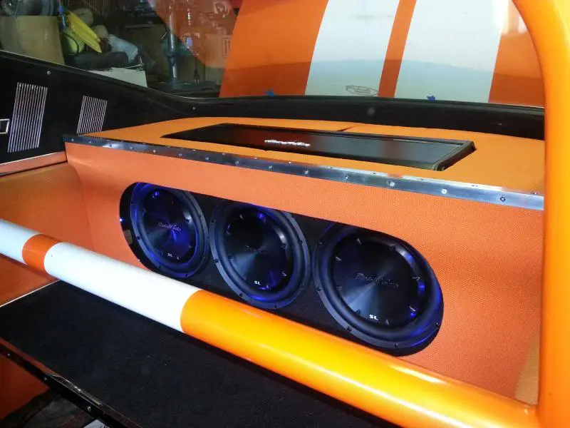

now im working on a box for 3 10"s and a 5 channel under plexi.After the car show in a few days, it will come out and the im going to redo the interior in tan suede/vynil
Man, You cut up your "Zubaz"!
Seriously, nice work. I need to do the same thing to my kick panels that already have speaker holes in em so they can hold a decent driver.
i bet most don't know that you can use cloth with fiberglass resin, and old pair of blue jeans can make some prety cool parts. any type of fabric that will absorb resin will work even burlap. it will not be as strong as fiberglass but it is interesting makes some prety cool lamp shades.

i like the lights:nice:
