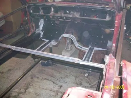

Got my floors cut out and just need to finish driver side rocker and torque box. Debating on whether I should go full floors or put in long pans. I've already have the long pans but got a major case of while I'm at. I'm replaceing the firewall cause I did not want to patch it up. The cost of the full pans are expensive once you add truck freight. Not going to be a trailer queen just a high end weekend driver. Decisions Decisions..
Also how do you change the title - spelling is horrendous
There's a lot less welding involved in the full floor, and you get better results.
Trans tunnel is okay. I chewed it up a little taking out the seat paltform.
BTW 2+2GT You gave me some advice on putting car on a jig. That was spot on. It has helped immensley in keeping things lined up. Since I went this far - I'm leaning heavily on full pan.

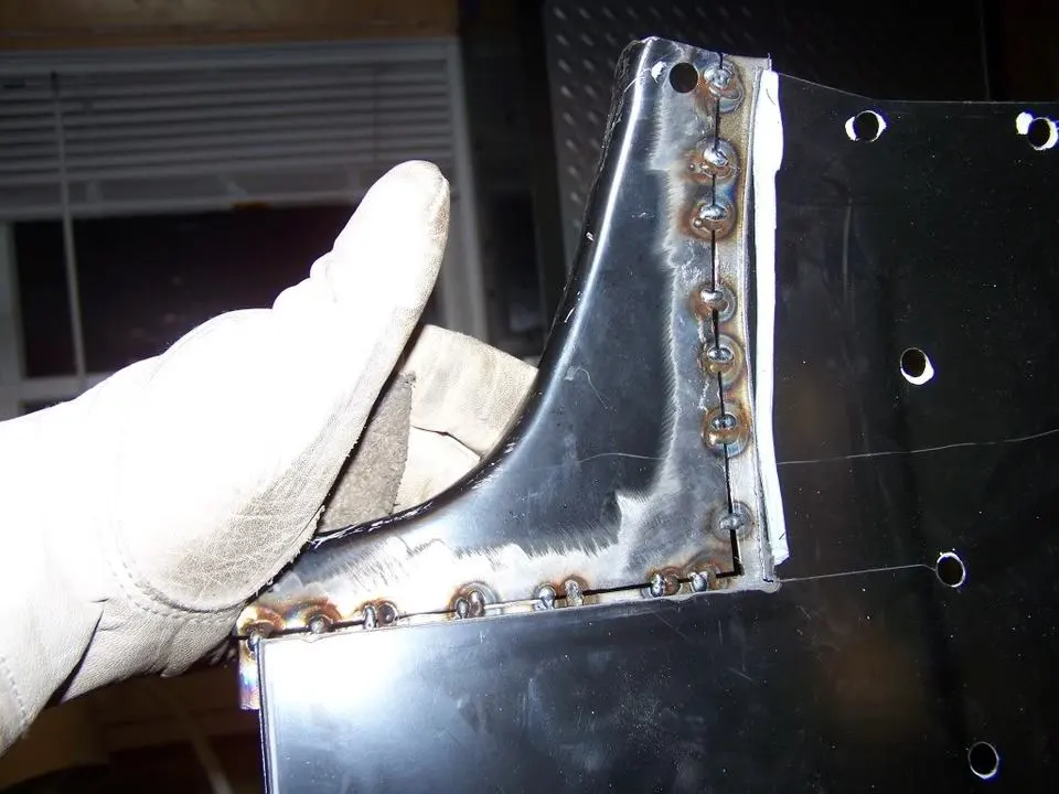

Their are pro's and cons to both. The full floor plan did not fit well. It was not wide enough (do a search and you'll see it is common problem). I cut the flange off the long pans and used that to make up the difference. Also the area around the rear torque box and wheel wells was terrible. I had to fabricate and extention to get it to reach the PS wheel well. Also around the front crossmember it took a lot of beating to get contact so I could weld it. On the pro side it looks nice when all installed. Be prepared to do a lot of rossette welds.

Extension fit up
Installed - notice around the front crossmember I needed to "stretch the metel to get contact

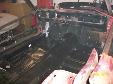

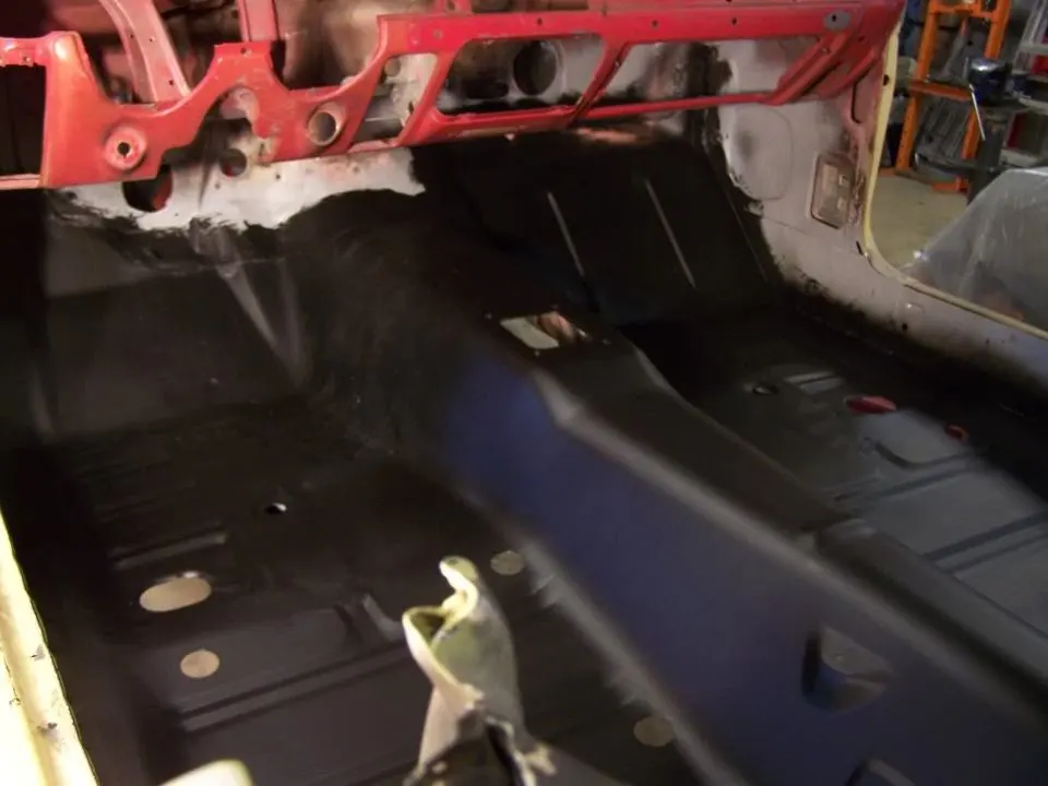

Well almost done. Was not too bad. No swearing or big hammer. Did not need to stretch metal. Around wheel wells not too good. But overall happy with results and glad I went with full floor.

Looks great!

Pretty much like you did on extension fit up - just after the fact. Will use some cardboard as a template. I think the full floor and long pans have the same issue. I bought long pans thinking I would go that route - they had same fitment problem.
Nice job!!
Glad it went in easier for you than mine did.
How are you going to deal with the wheel wells?
Thanks. Will fab around wheel wells - pretty much like you did on extension fit up - just after the fact. Will use some cardboard as a template. I think the full floor and long pans have the same issue. I bought long pans thinking I would go that route - they had same fitment problem.
