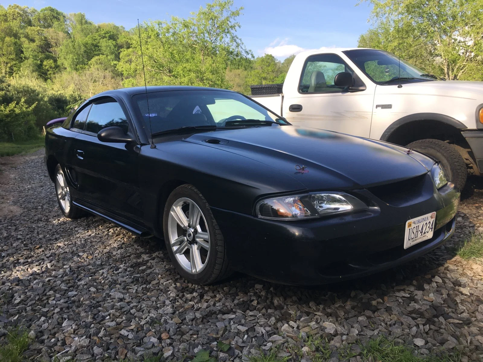

I’ve swapped out the dented front fenders and sanded and rattle canned the hood that use to be a horrible purple and swapped in some one piece headlights. A complete paint job is still off in the distance since the hood has major dips in it from the previous owner trying to sand the purple off and made some dips in the fiberglass. I really want this thing to get moving a little quicker off the line so to speak enough to satisfy myself to get the car straightened up and painted

The 3.73's will definitely help with getting off the line. That will be a nice addition. The body of the car appears to be in really good shape. Once you get all the dings and scratches out and ready to paint it will look nice. It already looks pretty nice as is. Which heads did you say you were looking at?
