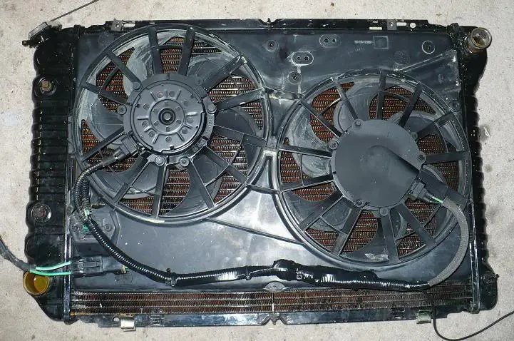

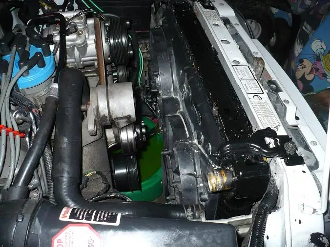

Here is a picture of them mounted to my radiator.
I use a Hayden part # 3654 fan controller. The fans are both 2 speed. It capable of utilizing both speeds. When the car goes 10 degrees above the specified temperature they kick on low speed. If it happens to go up 10 more degrees they will kick on high speed. When the A/C is turned on the both go on high speed. There is a probe you stick in the fins of the radiator to pick up the temperature. I'm very happy with this set up compared to the stock belt driven fan.
