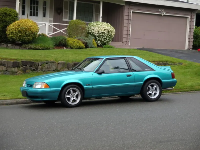

The 255's will fit just fine, as I mentioned in your other thread. 275's is probably pushing it a little bit with the quad shocks. You're probably going to have to test fit to get a definitive answer. My wife's car came with a set of 16x8 4-lug Cobra R's on it. Personally, I'm not a fan of these wheels in 4-lug.
Note that it had 225/50's on the front and 245/50's on the rear and kind of has the rake thing going on a little bit. This is at stock ride height.

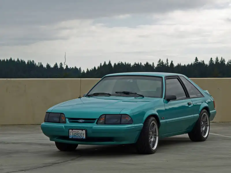

This picture is with the 255/40R17's on 17x9's all around and Eibach Prokit springs.
thats a great looking car! those pictures help a lot to see the stance i was looking for. I actually just saw some deep dish 1990 ssc saleen replicas in chrome that look pretty nice, Now I think im leaning closer to the ssc wheel.
Thank you very much for the pics and info!
