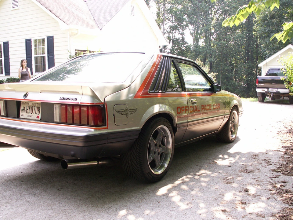

Im having a hell of a time finding good pics of deep dish wheels 10" or 10.5" on the back of a fox.... I know it requires some work ... Im bout to do it to mine soon but wanted a small idea of what it looks like.... Ive only seen 2 pics... Both red Notch's with bullets... 1 is vert..... I have a 89 GT and already am running 9" with 275's with room too spare... And am ready to do what ever is necessary to make this work....
Modular93fox on here has some custom modified deep dish Bullitts on his GT. they look great IMO, not too wide. He said he's running 275s now, but will probably get 285s next. He had them cut to 9.25", but thinks 9.5" would work just fine. This is on stock length axles:

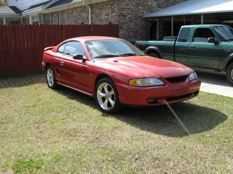

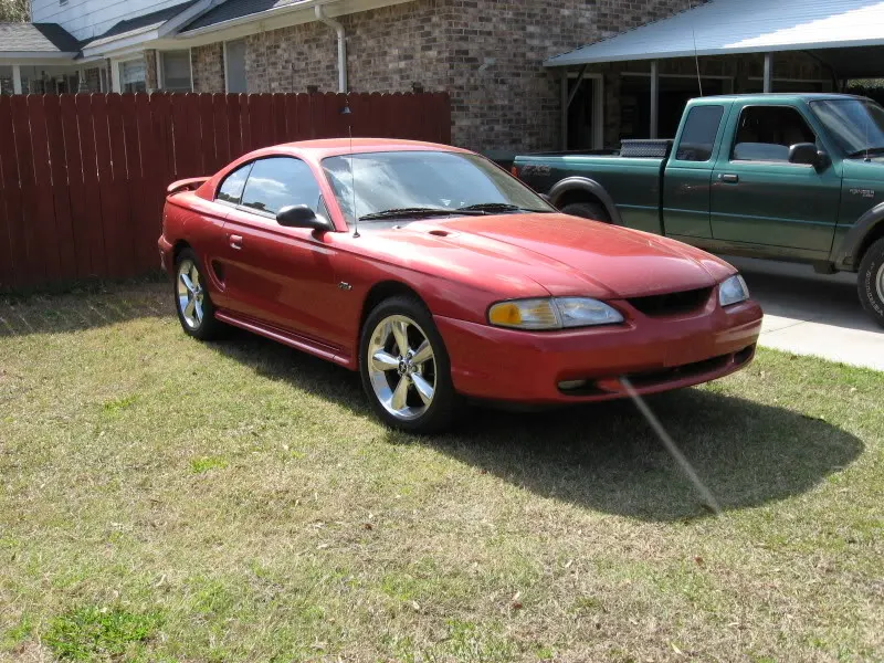

i'm running the polished 18" bullits that come factory on GT's on my pops 98.. they work great out back but need spacers in front
i like it alot.. real good looking car.. when he gets a truck its gonna be mine.. 6 speed swap and a kennebelle should help her out alot
