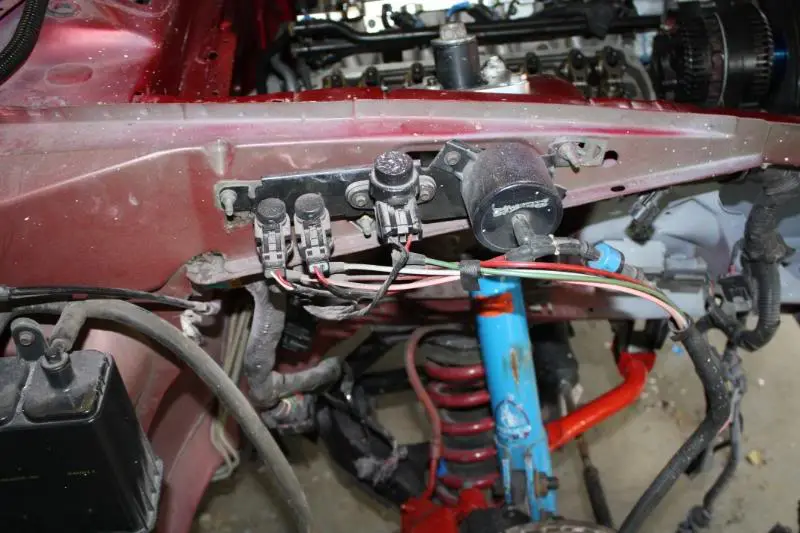

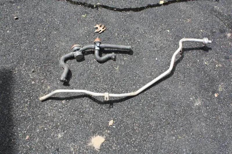

First... Is it safe to remove smog and keep cats.... (highflows)
Some people say the smog cools down the cats.... others disagree...
IS this all smog stuff???
All this vac stuff???
what about the tube on the back of the heads???
Im keeping EGR fox style....

I have also heard if you remove the smog stuff, you can burn up the cats more quickly.
From my understanding, that is all the smog stuff; plus the smog/air pump located under the alternator.
The tube on the back of the heads is for the Thermactor, I believe, and I am not 100% sure it is part of the smog stuff.
