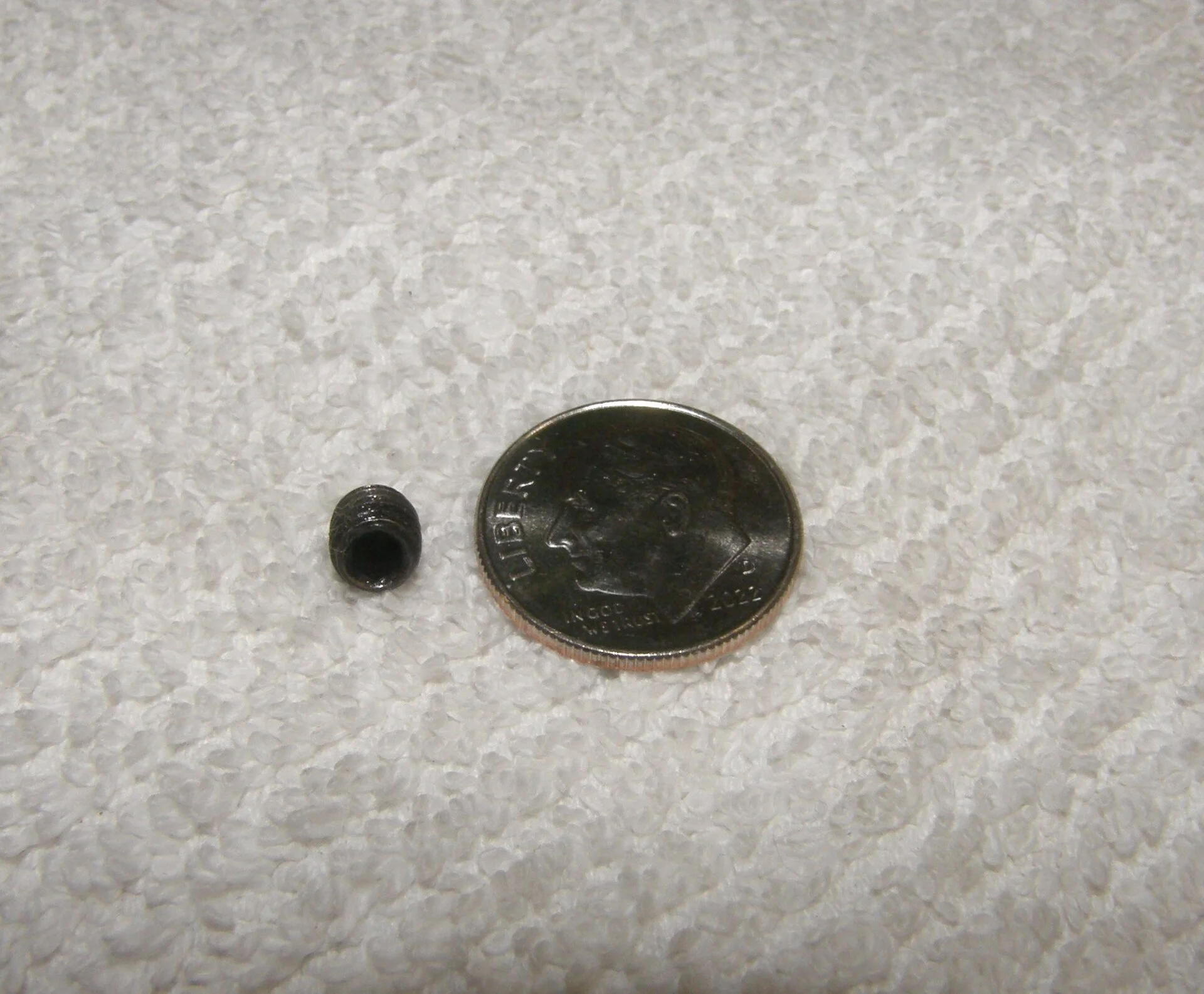

UPDATE:
Got that little sucker!

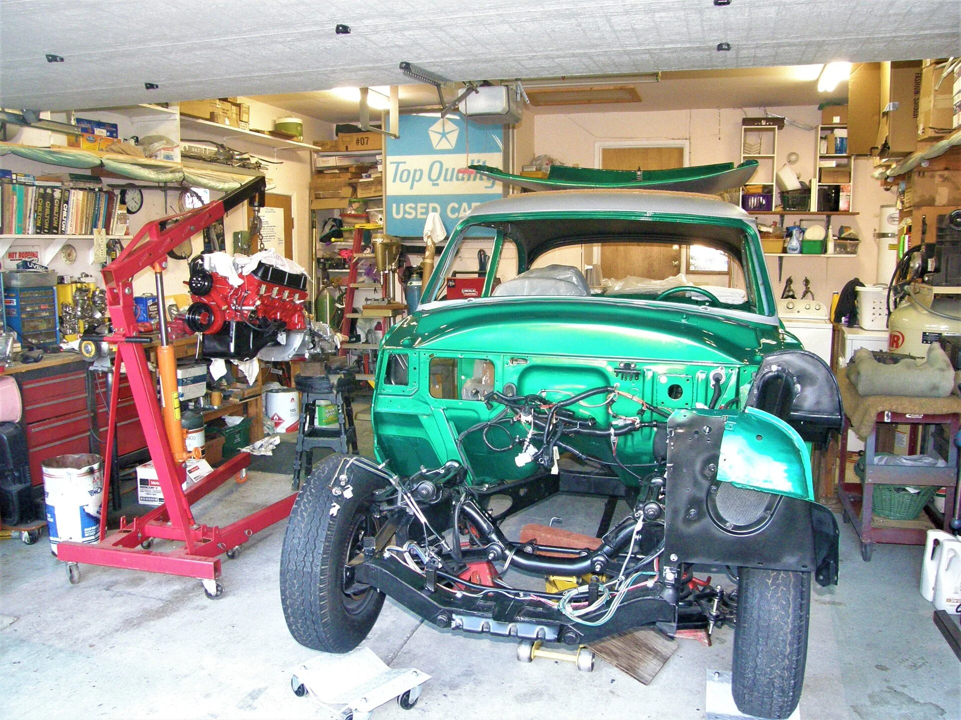

Flushed the motor 3 times with oil and it still didn't come out. Screw it.....out comes the motor! Wasn't too much of a pain 'cause there's no front sheet metal on the car.

Dropped the pan and there it was sitting in a far corner.......
That tiny little screw could have caused a lot of damage! Glad I got it. Tomorrow the motor/trans go back in. Moving forward!
In all honesty it probably would’ve just gotten stopped by the screen in the pickup and not really been a big deal, long as it’s not smaller than the screen perforations
One more reason to pick up the priming tool, it’s cheap insurance imo. Definitely worth the $15 on Amazon.
Any of us would have lost sleep had we not been able to find an object that small in our build.
I unconsciously exhaled when I saw you got it. :nice:
My fear would have been the off chance it doesn't make it down to the oil pan and somehow ends up staying in the rotating assembly and jamming somewhere..... catastrophically.
Once in the pan, i agree the screen on the pickup would have caught it.
