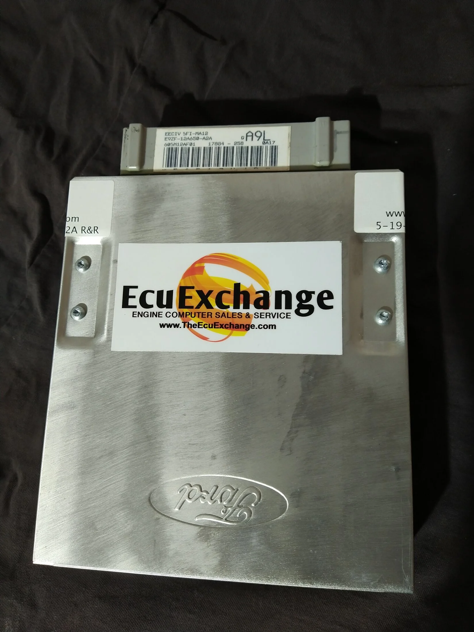

When I buy ECU's off of ebay I instantly send them right to ECU exchange for a diagnostic also repairs also being beefed up...
ECU exchange doesnt only fix and repair ECU's too they also tell you where to look for possible issues if the problems found arent the run of the mill issues like leaky capacitors so if you used them to repair your ECU and they neglected to tell you where possible problem areas are Im gonna be perplexed..

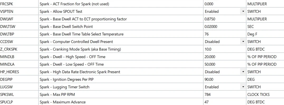

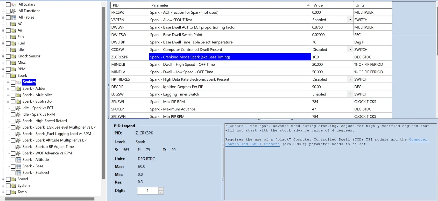

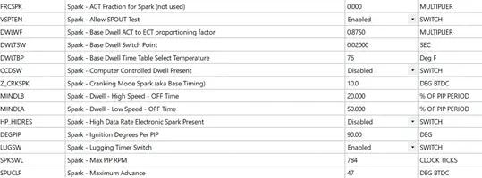

Advancing the ignition too far without making changes in the ECU cause the timing between the injectors and the spark events to be off causing the ECU to constantly make corrections causing the ECU and TFI module to run hotter.If you look at the third to last picture of the A9L computer settings you can see the spot where you can advance the timing the safe way where it keeps the timing and spark events happening at the proper times..
If you look at the second to last picture you'll see that Ford was actually supposed to set Mustang 5.0 engines with MT at 4 degrees BTDC but in order to utilize any other setting that would require them to change the module type settings fron NON-CCD to CCD also remove the 22k resistor and install a CCD TFI module so its a crapshoot on really how to get one to run flawlessly based off of this newfound information......LOL

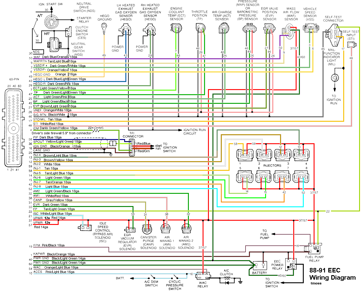

If you look at the diagram the fuelpump relay feeds off of the ECU relay trigger wire and it controls the power thats supplied for the fuel injectors too as each injector is triggered by the ground wire so if the injector harness wires are getting baren and can touch metal thats bad.........

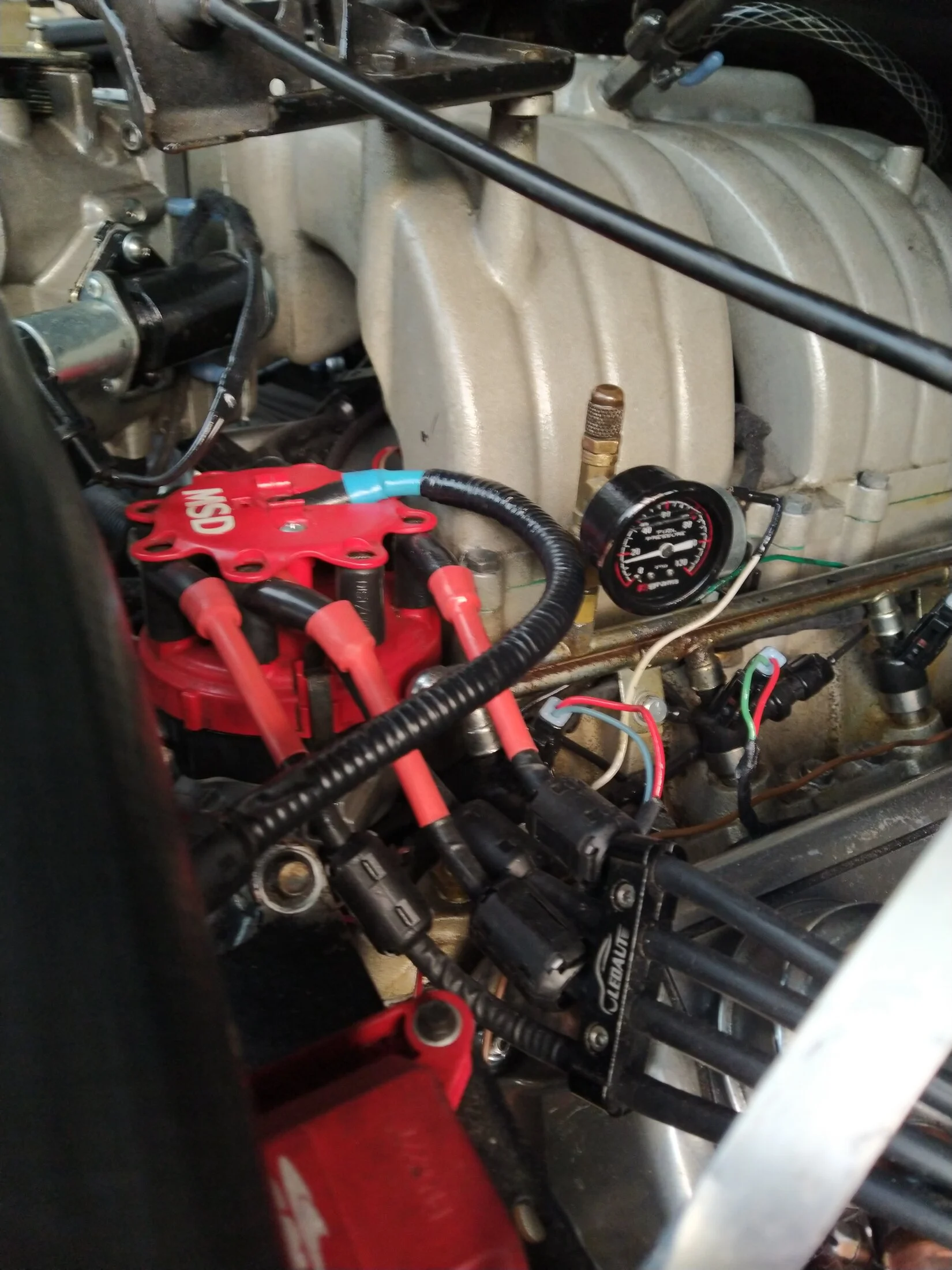

Another thing to do is a resistance test on the fuelpump and see if the inertia switch isnt raising the resistance and lowering the voltage. plus do a vacuum test on the fuelpump relay and do a fuelpump output reading using a gauge on the schrader valve coming from the fuel injector rail... On my injector rail I have a liquid filled gauge also a schader valve plus I also monitor my fuel pressure while Im driving so theres a fuel pressure sender switch that goes to a gauge on the dash too.....

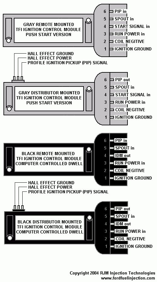

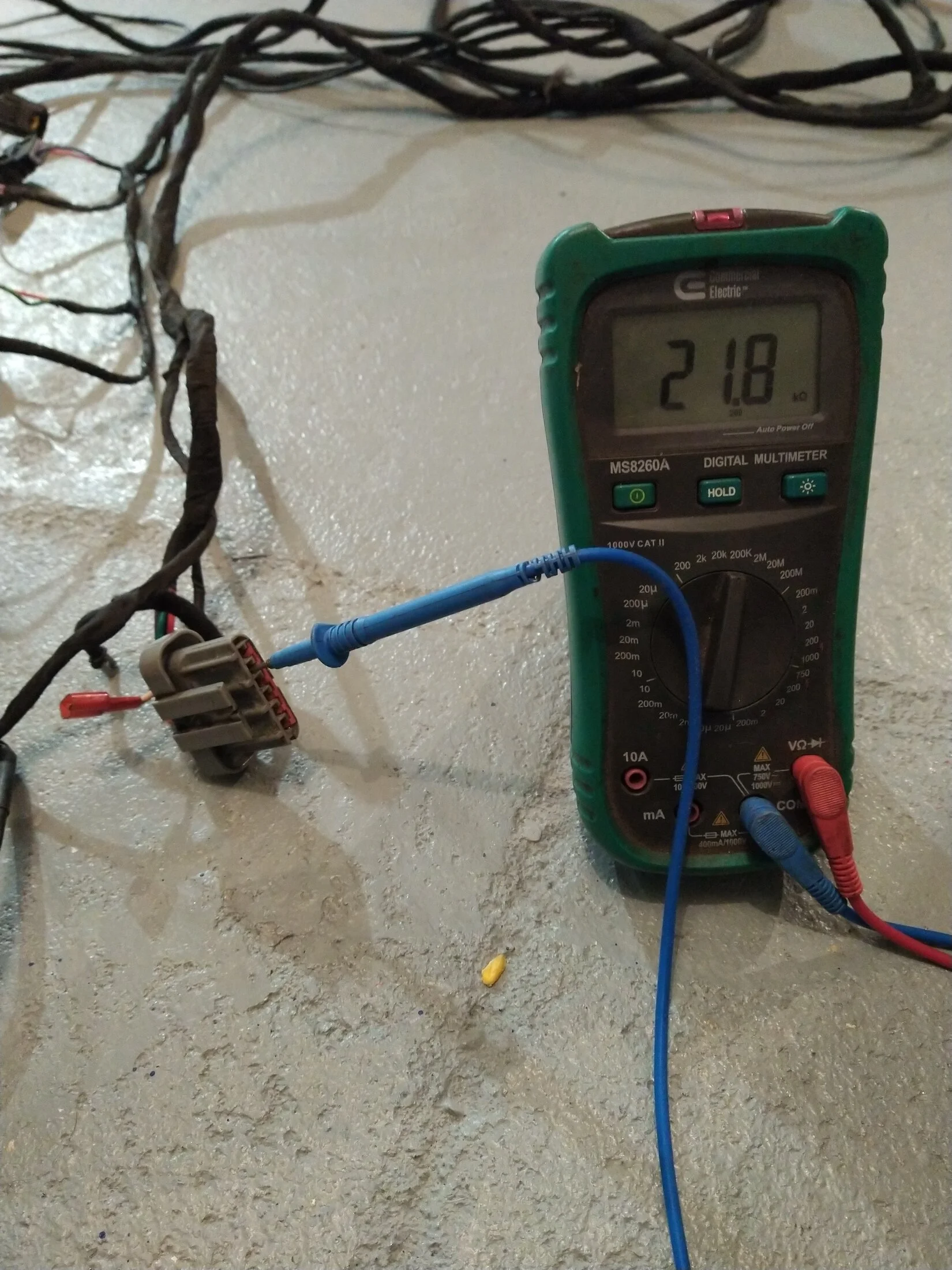

On pin #4 (IDM circuit) on the ECU plug going to pin #2 (coil -) on the TFI module should read atleast 22kohms if the car is a 5 speed manual and the TFI module should be the NON-Computer Controlled Dwell type TFI module..
If its an automatic conversion car there will be zero resistance between pin #4 and pin #2 but should have a 22kohm resistor installed in-line and the TFI module...

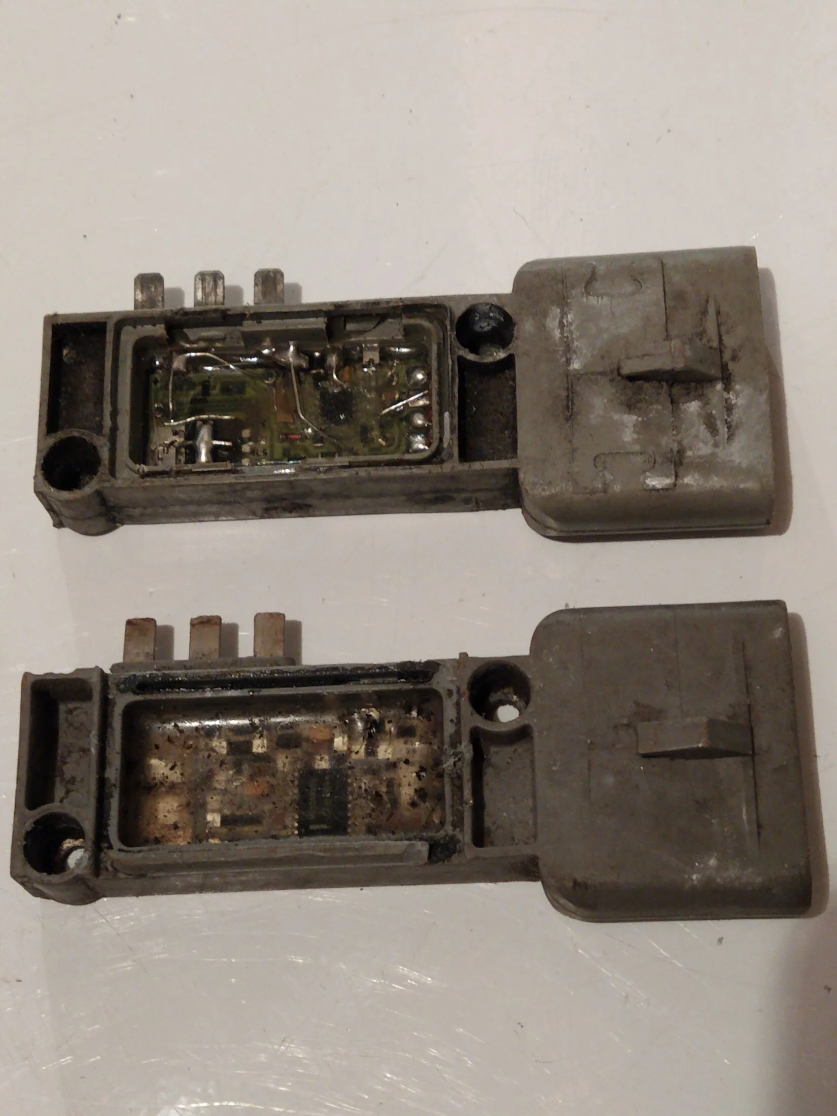

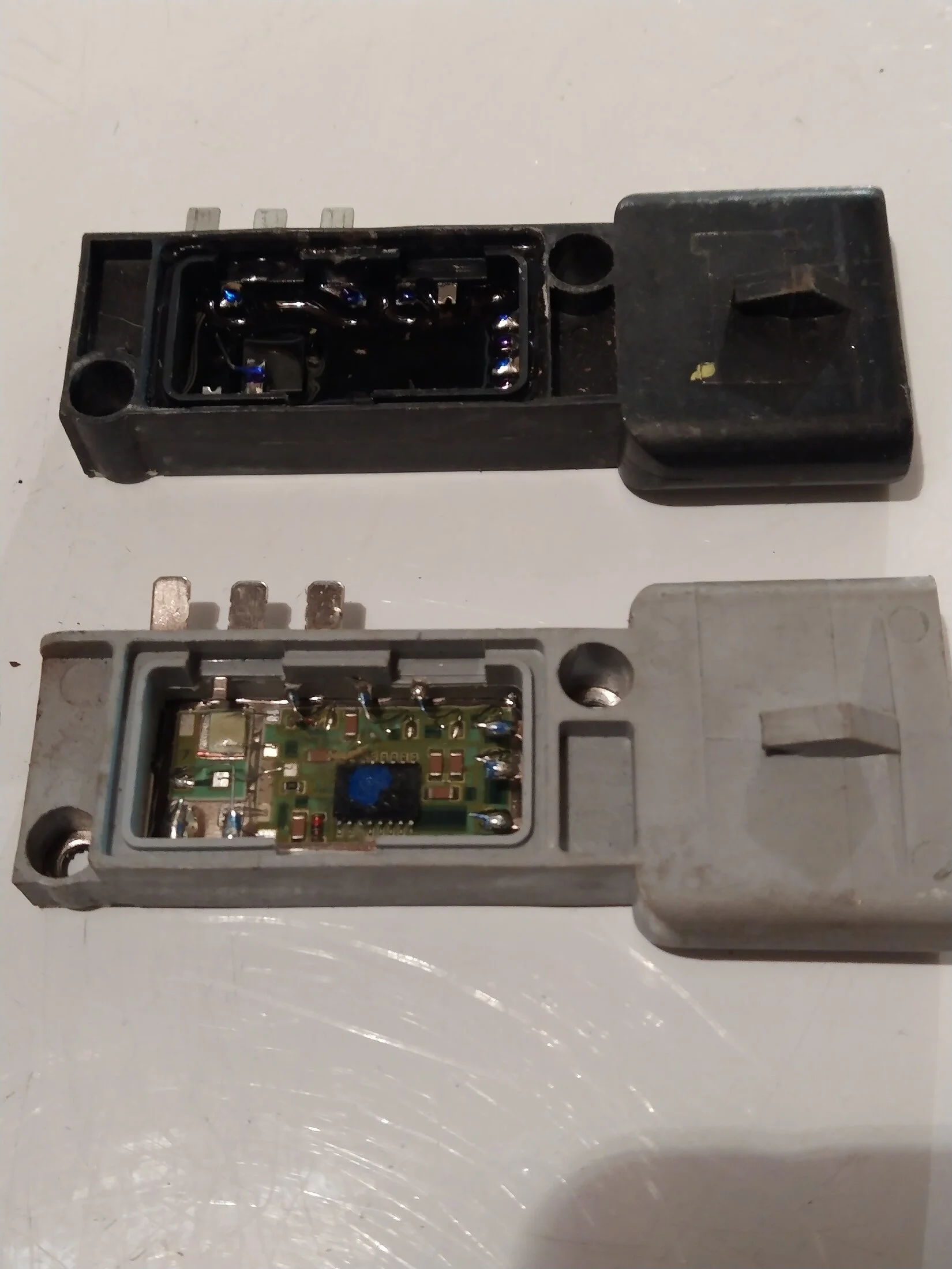

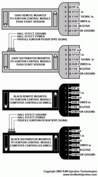

You'll notice in the illustration I got online about TFI modules youll notice theyre identified as Black or Gray which is misleading as you can see from my pictures the CCD and NON CCD can come either black or gray and the way to tell is by weight as one weighs considerably more than the other or simply pry off the dust cover and look.......

Wow, thanks for the detailed reply. Couple of things I forgot to mention in the original post, Brand new distributor with a Motorcraft TFI. When I pull codes I get a message saying my OTC code reader failed to make a connection. I sent my second computer to ECU Exchange and was very pleased with their work but unfortunately that hasn't solved my problem. Running on limp mode makes sense as the car dies upon reaching operating temperature and going into open loop mode. I'll check into this.
TMoss has a couple of write ups on the differences between the TFI modules and goes into great detail on it.
