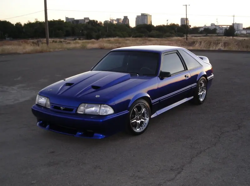

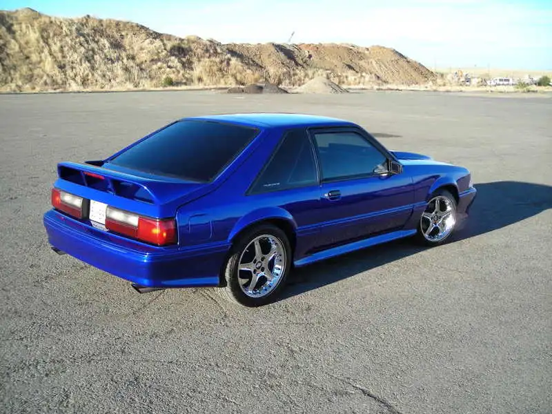

Not sure, but his car has a 306 with AFR 185's, holley systemax intake, & an S Trim...Also has a tubular K member, a arms & front coilovers with lakewoods up front, but a stock as a rock rear suspension with the exception of the strange 10 ways & boxed control arms. He consistetly ran 10.6 on the stock bottom end, but has since stepped up to the 306 with forged internals... Here is a vid of his car with the stock bottom end & stock T5 runnin 10.68 @ 131... Hes hoping for low 10's with the new combo.....I 4 got 2 mention...MY BUDDY CAN DRIVE!!!!!

Heres a couple of pics of his car (it was primered & under construction still at the time of that video)...He just ordered the new fox Saleen dd replicas in 17x8 7 17x10...his car is gonna look bad@$$ & kick major @$$ on the track next summer....

very nice car, epik, thanks for the info. However, that 306 and s trim launching is not like an na 2v. Glad he got a paint job on that thing. It look sick!

4 sure, but just thought I would show u whats possible on stock rear suspension & GREAT driving...Me, im all about aftermarket suspension parts & my 2.1 60ft sucks...LOL!!! Good luck....
