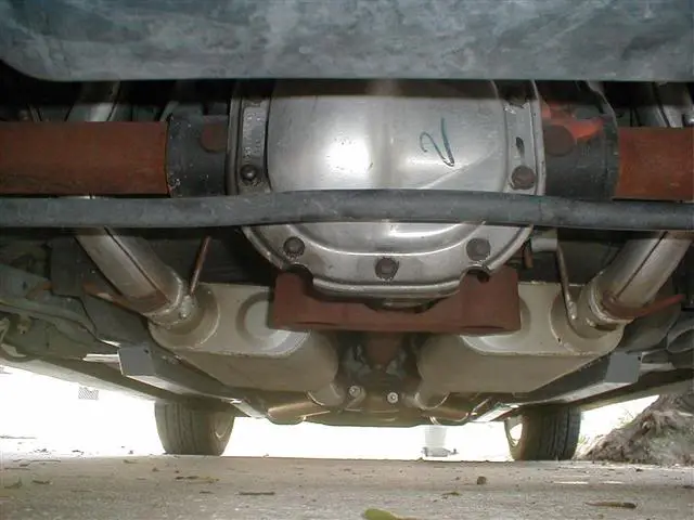

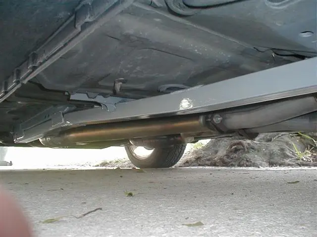

See my pics below - understand that there is nothing but flexable floorboard tying the front and rear subframes together. The first pic shows the SFCs and the distance they cover from front to back (the back connecting point is just out of range of the lens). But you can imagine how much these are needed to strengthen the car. The second photo also gives you an idea of the length of FULL Length subs...don't skimp or compromise here. Get the good stuff, MM. These really aren't expensive at all.
